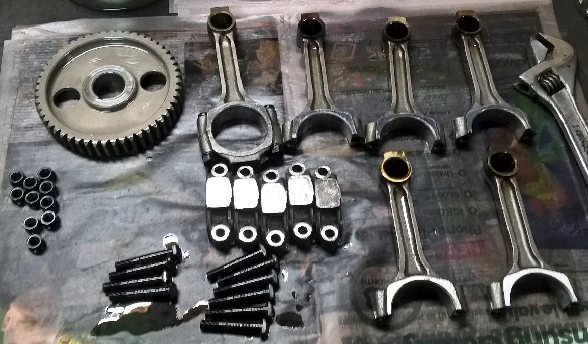

speaking of, went there today for a few hours, got the rods all washed up and fitted arp bolts, also got the cam gear pressed onto the new cam..... we measured the rods, they need to be closed and honed, also still got to do the piston machining, jobs for the new year!

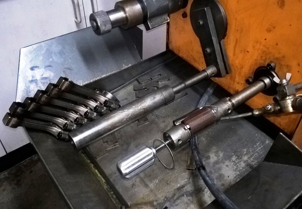

Got a little more done today, rods have been closed and honed, just needed to let them cool down for final measure and touch up if required .... my first time doing the rods, they get very hot very quickly when honing! its amazing how much it changes the size readings!!

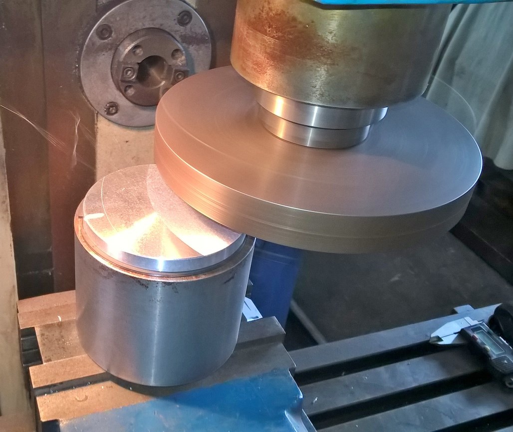

good progress today!!! got the pistons all machined and washed, rods have had final hone and measure and they are washed, the last bearings and such have been ordered, so hopefully see them at the middle or end of the week, so all going well I might be able to do some bottom end assembly next weekend!! :)
I ended up taking .040 off the tops of the pistons which should put them .025 down the bore and give me about 10.34:1 compression, which is on the safe side of the 10.5 I was aiming for, will know final measurements once the bottom end is finally assembled.
