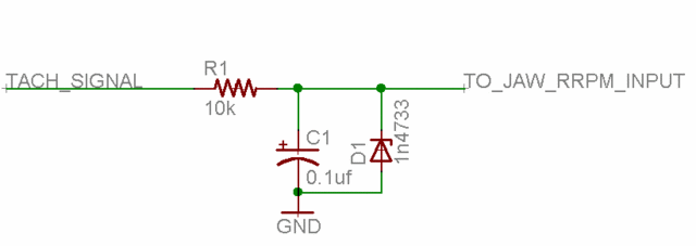

Im planning either of these 2 circuits the first one is know to work and outputs about 5.1-5.2 volts the second has been known to not limit volts so ill probably just go the first one.I was going to connect to the sprout in the engine bay but if i can go direct to the wire from the module to the ecu even better I had thought about it but wasnt sure on what sort of signal it was and weather i might pull too much current off the line might still goto the rpm sprout or the wiring to the indash rev counter yet.as long as its 0-5 volt square wave when its at my wideband input its fine ive been told 5.2 is ok too if thats as low as i can get it.the second one would have better noise filtering but I dont have time to mess round checking if its working so i might just go with the zenor and resistor for now
Re: holden DIS RPM output 12v or 5v
Regardless of where your grabbing the signal from just run something like what you posted - either circuit will do the same job. Just dont use too much capacitance for filtering and keep the resistor high enough in value to not pull the signal down.

so you think 270ohms is all good im going to do a shop up tomorrow for some parts hope they have them in stock or i will be logging blind .why does one circuit have a 270ohm but the other 10k is that just cause of the capacitor and how the circuit works
Id try with a 10k to start with, its there for current limiting - the higher the better. Grab some 1k resistors also.

right i have built the 1 resistor 1 diode circuit into my cable will hopefully be testing on the weekend.
