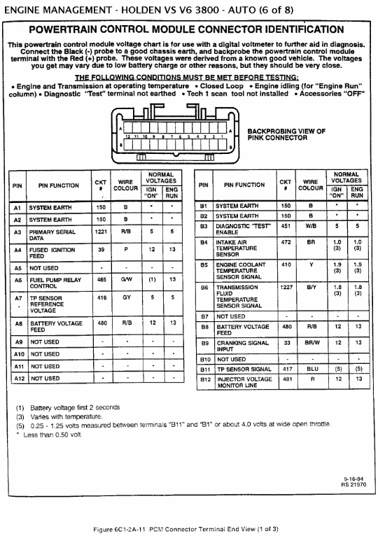

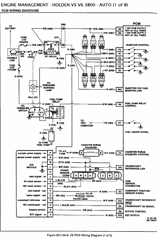

Does any one have a wiring diagram for the VS V6 PCM?
- Posts: 5714
Re: VS wiring diagram
Goto robs site at www.memcals.com he has broadcasting codes for stock bins and wiring diagrams and all sorts of stuff in there.he even repairs ecu's.and hes a good fella.

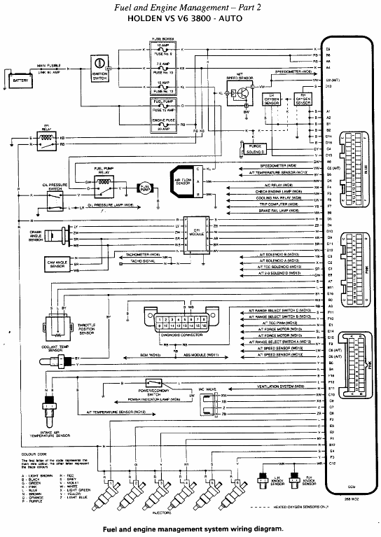

Or This...

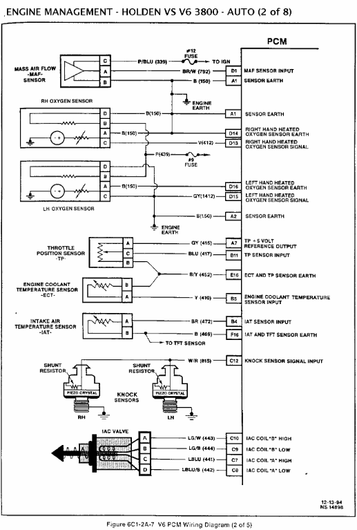

Does anyone have a wiring diagram for VS L67, there's a certain member here that has converted from N/a to L67 using the N/a wiring harness on the complete L67 engine & since doing it he has 7 different sensor faults flagged!
I compared the sensors on the VT wiring diagram & there the exact one's that are controlled differently in the L67 wiring!
the sensors from memory are:
Oxy Sensors
Cam Sensor
IAT sensor
Coolant Sensor
Purge Canister
Maf Sensor & something else I think but forgotten!
Does it all sound viable to be wiring issue as he's put an L67 memcal in & thats it!
