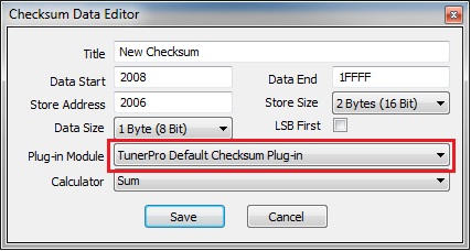

Works fine on my system, make a change, press save and says at the bottom checksum updated. Have you played around with checksum plugins at all? Should just be using the default ..
Press ctrl+F2 and then the checksum tab to edit what checksum is being used.

Re: Check sum issue when saving DDRH $A5K
So much to learn still
