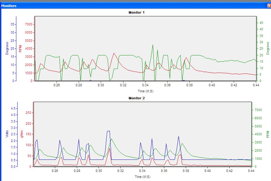

I tried bumping up the timing and the difference in power is definitely noticeable. My first attempt at timing resulted in 1-2 degrees of knock retard being logged for a second or two in some places. So I took 3 degrees of timing out of the majority of the curve but on the next log I did there is still a bit of knock retardation but there is no value as shown in the attached pic at 29 secs and 37 secs. Would it be safe to leave it like this or should I pull more timing?

I logged a completely stock VX V6 today and it has up to 5 deg Knock retard in the upper RPM range. Considering its a 100% stock car would this be false knock or is the standard timing that aggressive on a VX? Any help greatly appreciated!

common result of a dirty MAF. once the maf gets dirty, it reads less air than whats really passing through it, which makes it incorrectly run less fuel and more timing. perfect for inducing knock.
get some electrical contact cleaner / MAF cleaner / Carb cleaner, clean it and do another log, it might be that simple to get rid of the knock retard.

its not uncommon for them to produce false retard due to noisy overhead gear at revs too, when it gets really bad its extremely noticeable when driving.
