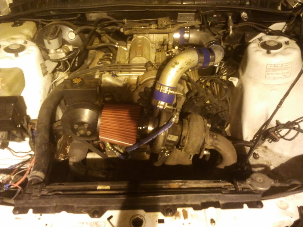

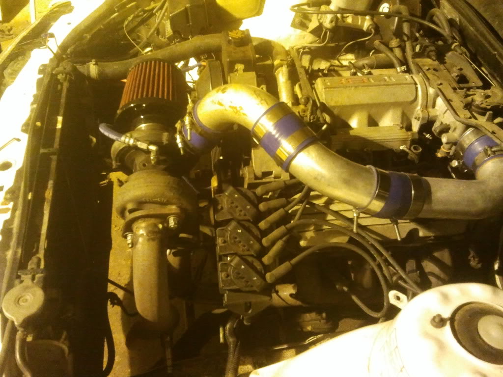

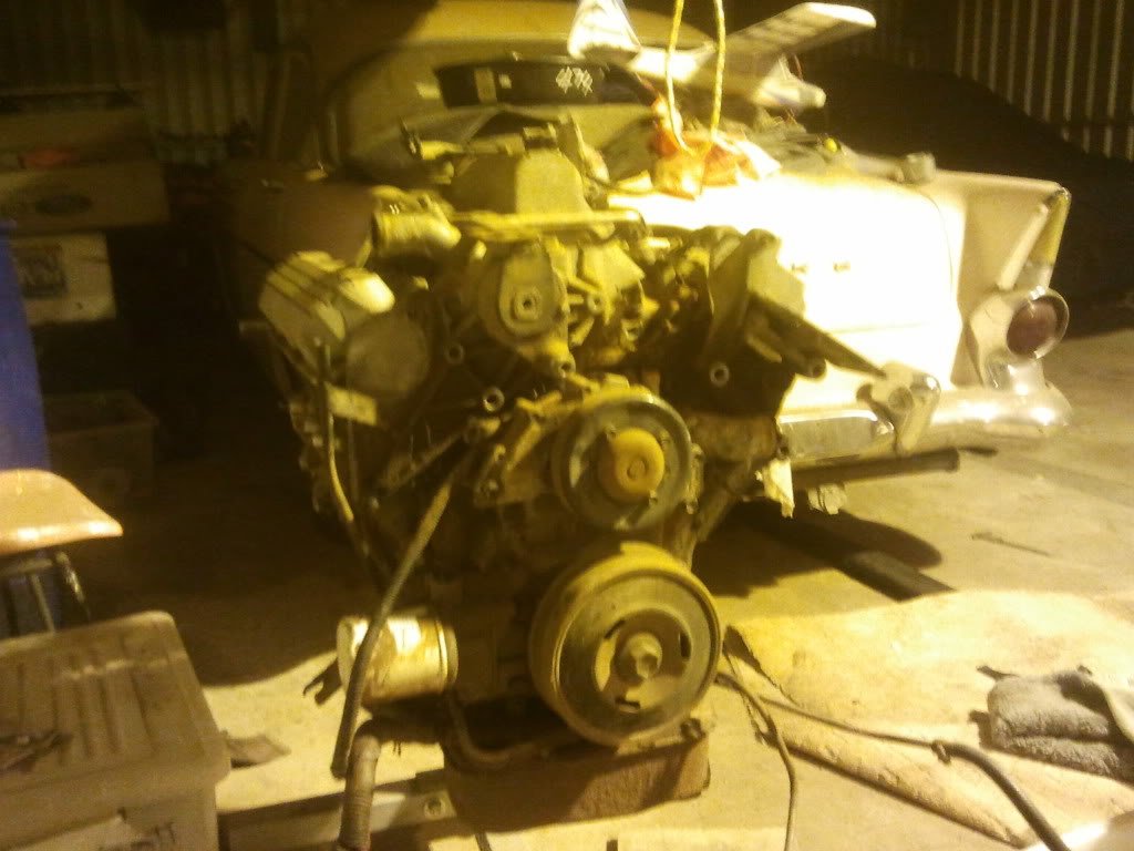

Well finally finished this thing and have managed to do it for less than a grand including the car.
Moo engine out
Race motor in.
Turbo is only small of a jcb but should hopefully do the job. As this was my first attempt at any real welding, no doubt there will be pin holes everywhere but it is in the spirit of the build. I dont expect it to be reliable or last long but has been fun learning experience.

im more interested in seeing the motor and turbo in the FB/EK behind the motor in the first

202 - yeah me too. Was bought for the old boys 50th as a project for him / and us 4 boys to chip in and help with. Unfortunately although the body is relatively rust free the sub frame has seen better days. It might find its way onto a hilux chassis or something like that one day however.
