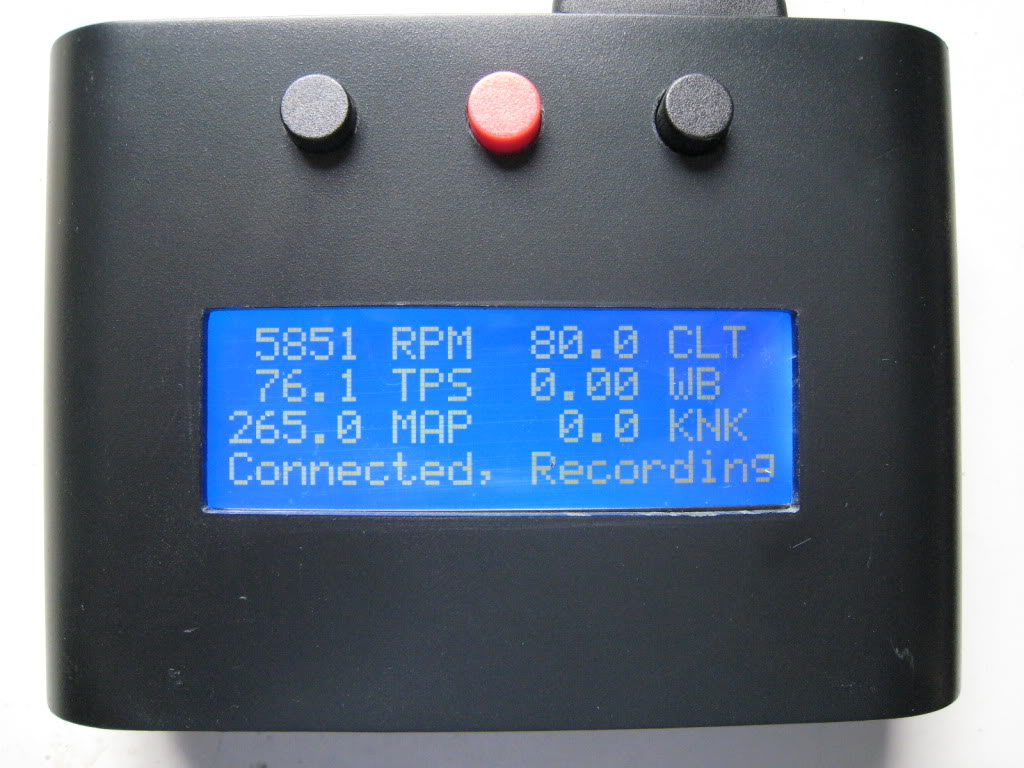

I was one of the fortunate people who snapped up a ALDL Logger from VL400.
Today i fitted the logger into its case and done some testing.
VL400 has helped with a $11 adx for the logger, will modify this for addition input for my wideband.
Hopefuly do some logging with it tomorrow purely for testing
Soon will be converting to Ls1 T56 and running 12P
Big thanks to VL400.

Re: ALDL Logger Support Thread
just a question VL400, with my earlier "prototype" logger, it looks like the display is further away from the buttons here than mine, is that correct or am i just tripping ?
- VL400
Thanks for the feedback
Very neat job on the cutting and drilling too. 12P has a nice speed advantage of 128 byte read and write packets compared to 64 byte read and 8 byte write of other code types.
@Holden202: Should be very similar as the buttons board is the same (although it does look a little different), might just be the way the screen is cutout?
