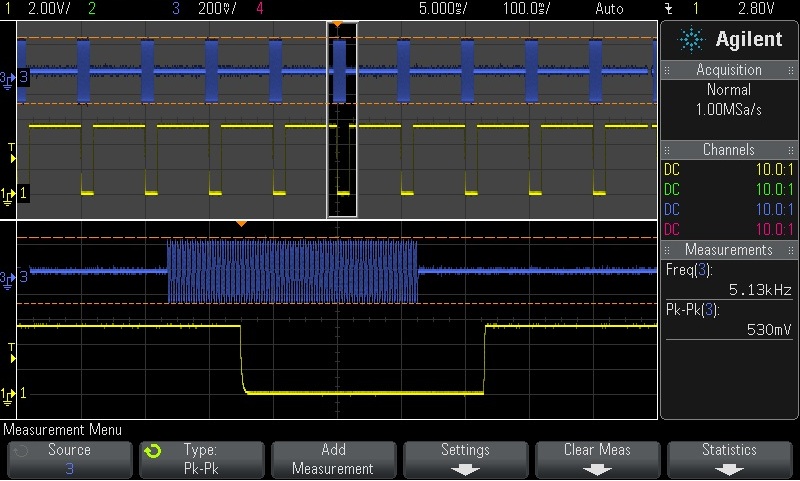

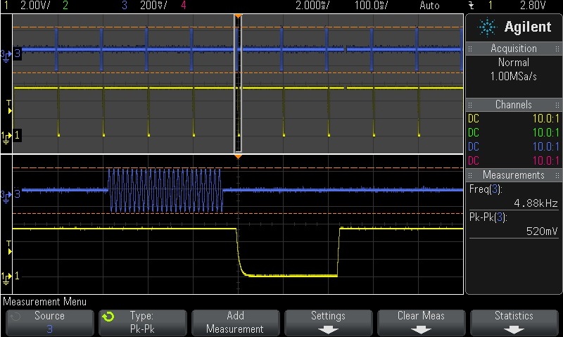

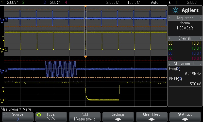

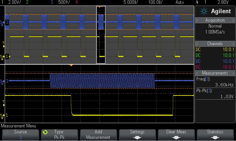

I tried to get something but it was not making much sensefesty wrote:I don't suppose you have a scope capture of the filter's output during knock? Is it active low?
Does it hold the output steady during knock, or pulse per event? My guess would be hold?
These were all done on a V6 memcal, blue is simulated knock sensor and yellow the output of the knock filter board (inside the ECU it inverts this signal before feeding a counter) ..
Lowest freq to trigger Highest freq
Made more sense but freq range was too high, so prob over driving the BPF, changed to 500mV and injected 100cycles..
And changing to 25cycles changes the response again

Thanks so much for getting those for me, it gives me plenty to get started with

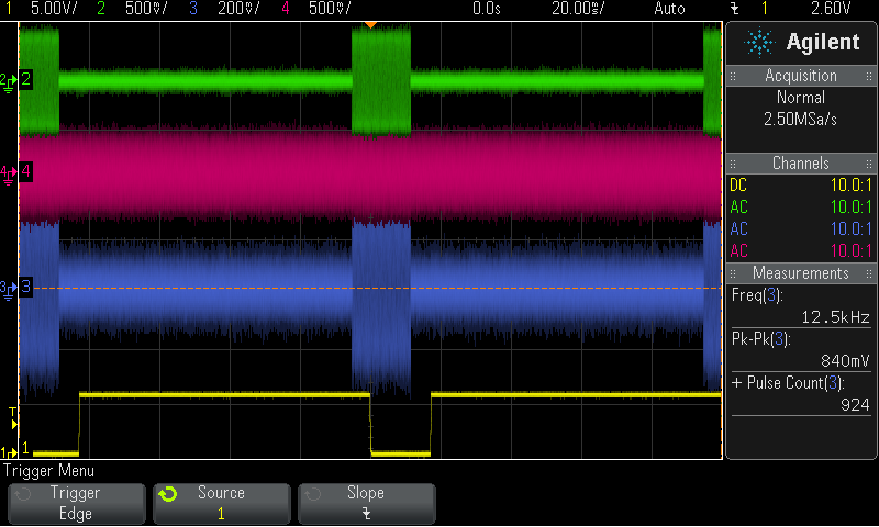

Are you able to test with an off-frequency signal of the same amplitude, while pulsing the 6khz signal?
Just wondering whether the knock still gets detected when it's at/below the background noise level, or if that's why knock stops getting detected at higher rpm on these.
I'm sure you've got the right toys for testing that.... I certainly don't
Re: Programmable digital knock filter?
Like noise injected at the same time?
1V p-p for both signals, 100cycle burst at 6KHz and noise on the other.
Green = Burst Signal
Pink = Noise
Blue = Combined
Yellow = Knock output
Pink = Noise
Blue = Combined

Again I thank you - and those are very pretty pictures, I'll be staring at them a fair bit in the coming day/weeks I think
The knock signal was still well above the noise floor if I'm reading those correctly - because the waves that lined up with the noise summed the amplitude?
I might have to try and record the output of a knock sensor and use that as the signal for testing, because I can't think of any way to simulate a proper real world knock event mixed in with background engine noise better than what you've done today.
Thanks again for all the detail, the forum should pay you more
