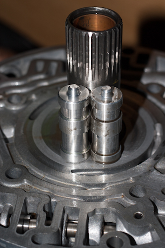

Sonnax Smart Sunshell Kit

Sonnax Forward, 1-2 and 3-4 Double Seal Pinless Accumulators
Sonnax & Corvette Accumulator Springs

.500 Boost Valve with sonnax spring

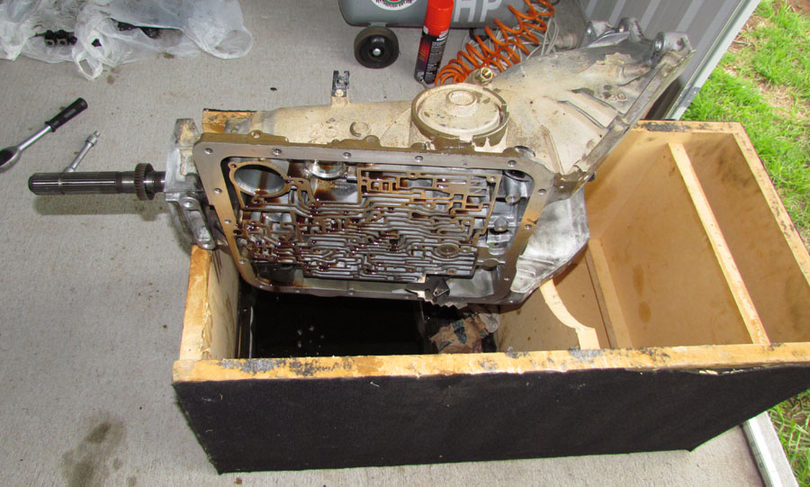

Here's my workbench for this project, an old Subwoofer box, it's ideal for working on the trans case it has recessed insides as you'l see later and also has a hole in the top for working on drums, pumps etc.
Down to cleaning the case a bit, you know when the Mr's isn't happy already giving you the toilet brush. Just Kidding, she's happy im spending far less than paying someone for a rebuild.

Took the pan off and ill sit that in the bottom of the box to catch any oil and debris, i let it sit there for a while to drain.

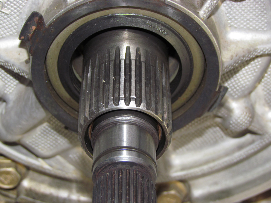

Take the rear seal off
IMG_1216 - web.JPG (121.41 KiB) Viewed 20200 times
Spin it round and take the rear housing off
IMG_1217 - web.JPG (162.5 KiB) Viewed 20200 times
The Shaft is in good condition and the Speed Sensor Reluctor cog is fine as well.

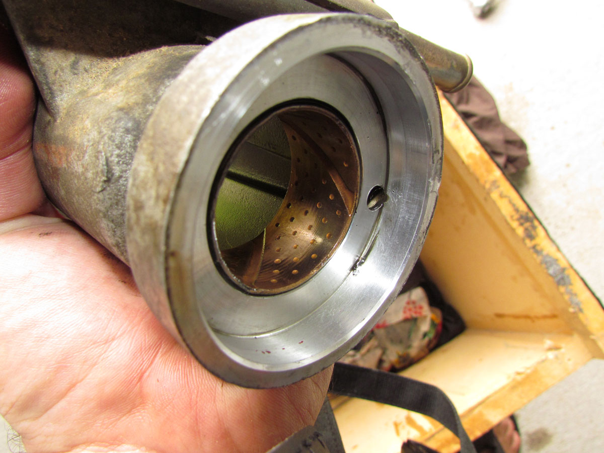

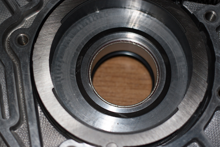

Slight wear in the rear housing bushing, it'l be replaced anyway.

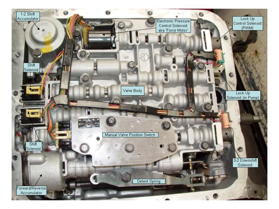

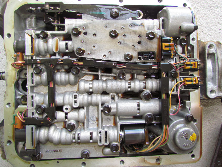

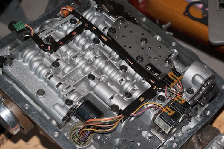

While that's dripping we'l start on the valve body
IMG_1204 - web.JPG (210.56 KiB) Viewed 20200 times
Here's a reference labeled one
We need to first remove the PWM lockup solenoid by removing the clip, yes these clips are under big spring tention and will go flying, i spent 1hr looking for it after it hit the roof and went flying. Taking a photo and declipping isn't easy.

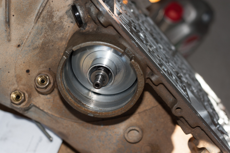

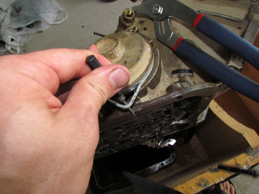

Take the Snap Ring off
IMG_1239 - web.JPG (141.02 KiB) Viewed 20122 times

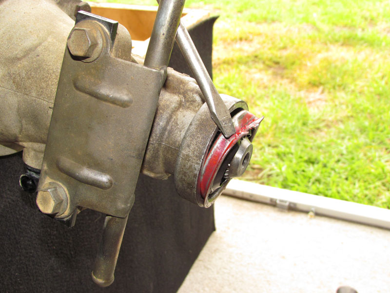

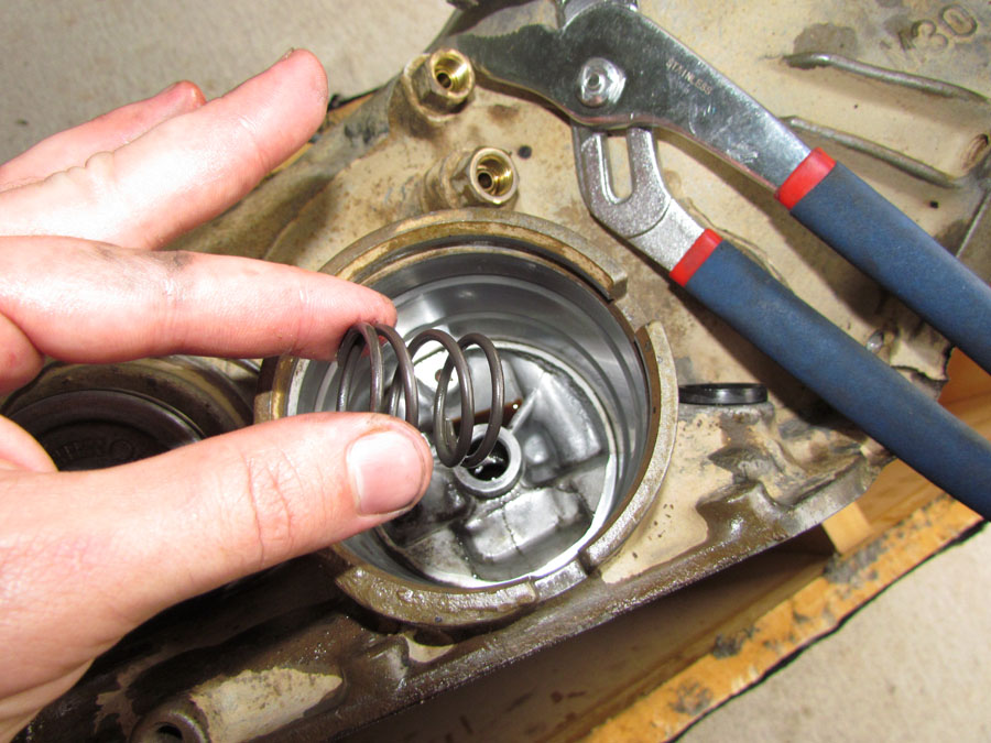

Take a small screwdriver or pick and pull that seal out while moving the cover and it should lift off
IMG_1241 - web.JPG (122.82 KiB) Viewed 20122 times

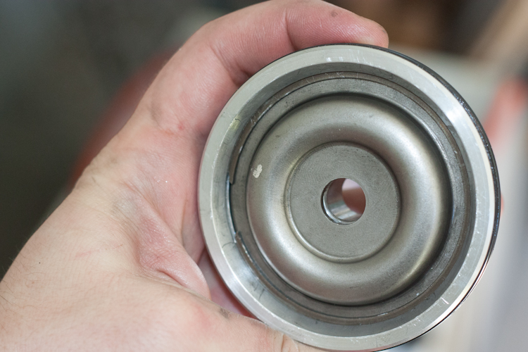

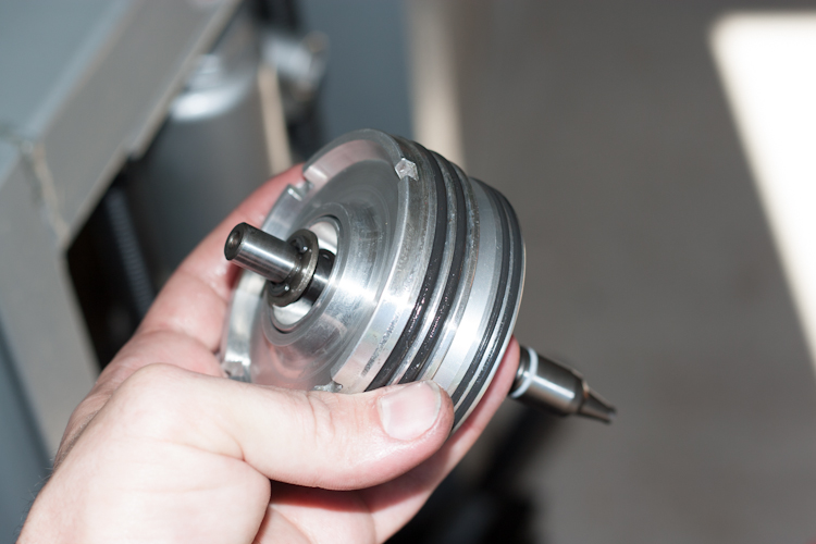

4th Servo Piston
IMG_1243 - web.JPG (144.12 KiB) Viewed 20122 times

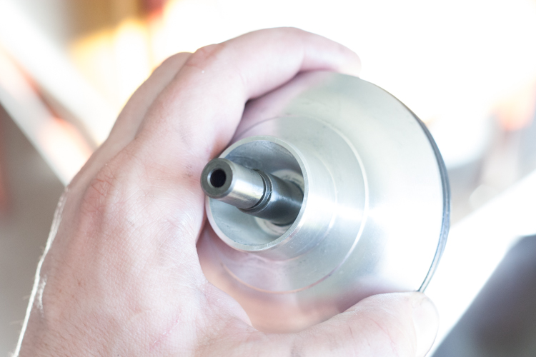

2nd Servo Assembly and spring
IMG_1244 - web.JPG (132.52 KiB) Viewed 20122 times
IMG_1245 - web.JPG (158.46 KiB) Viewed 20122 times

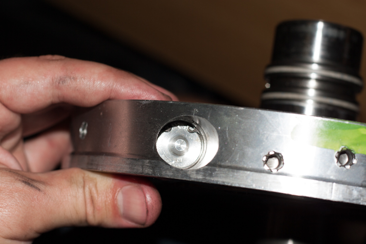

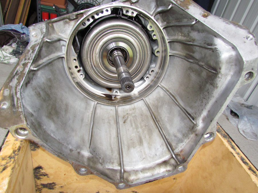

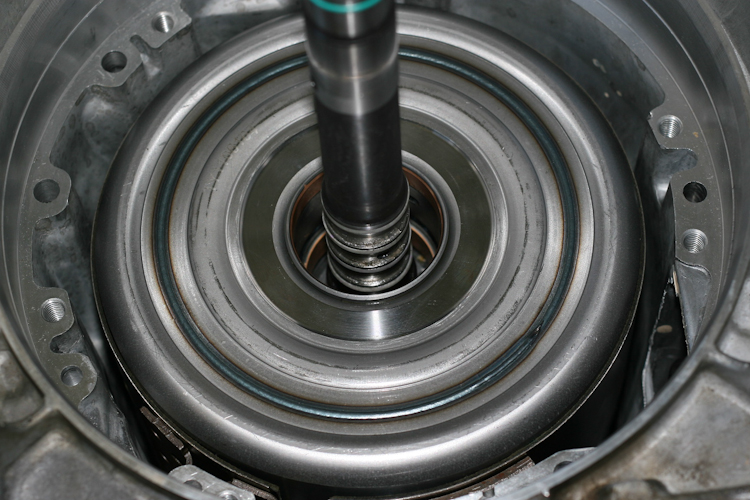

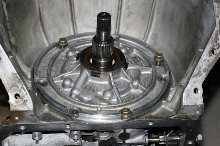

Now time to take the internals out, Starting with the pump, There's a pump puller tool, but i found it no problems just turning the pump bit and wiggling it out.
IMG_1246 - web.JPG (150.81 KiB) Viewed 20122 times
IMG_1248 - web.JPG (169.87 KiB) Viewed 20122 times

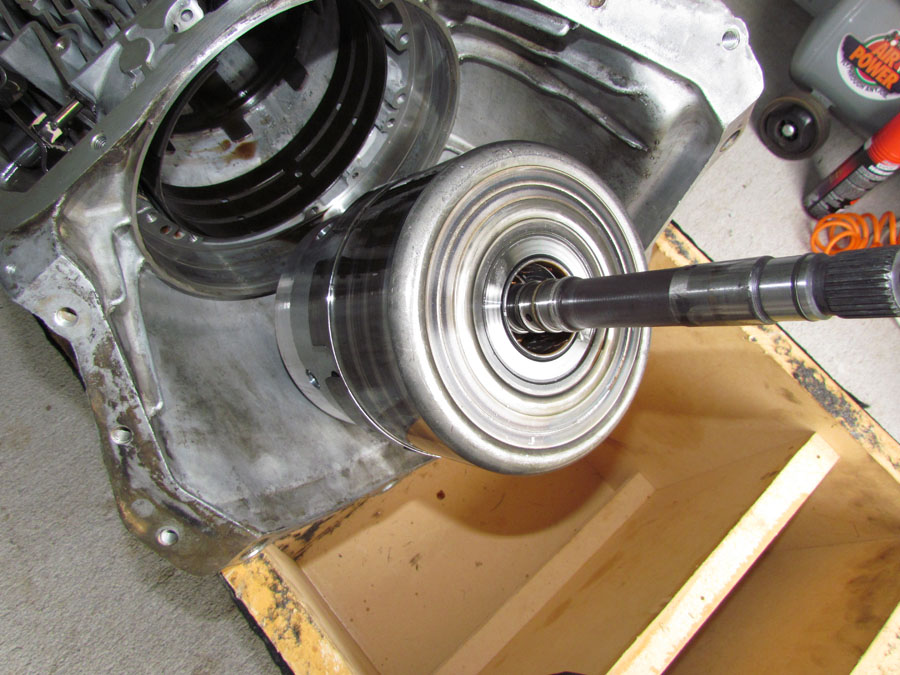

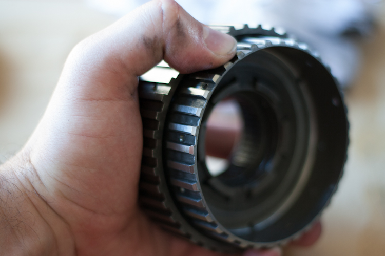

Next is the Input Drum assembly
IMG_1249 - web.JPG (170.25 KiB) Viewed 20122 times

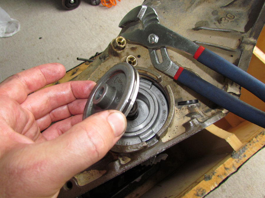

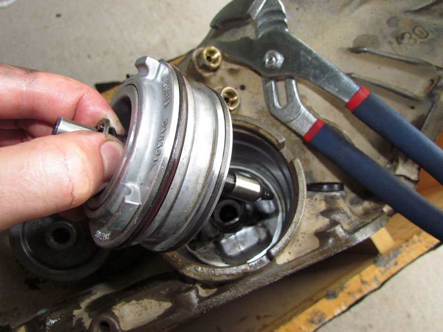

But before i pull the input drum out ill remove the band anchor pin, i used an old powerfull hard drive magnet to get it out
IMG_1251 - web.JPG (167.75 KiB) Viewed 20122 times
Then pull the drum assembly out
IMG_1252 - web.JPG (165.44 KiB) Viewed 20122 times

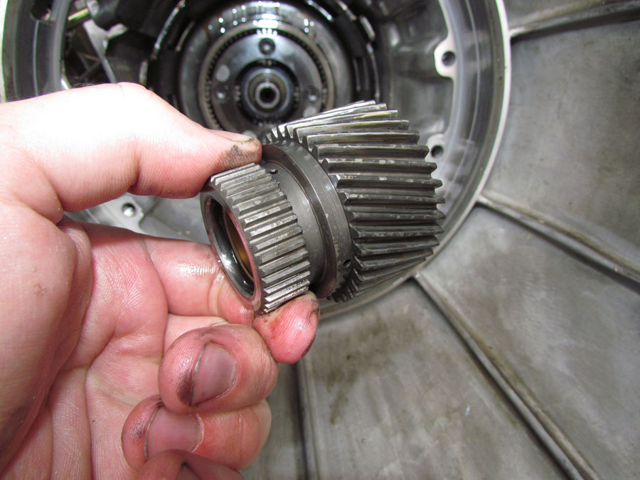

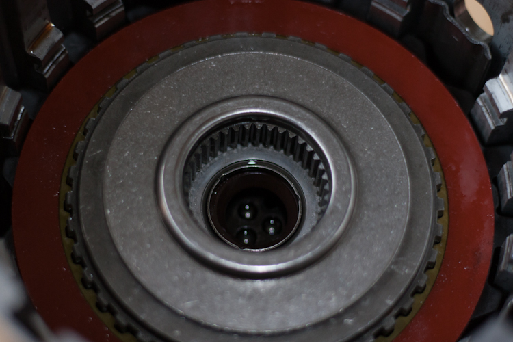

Next is the Input Sun Gear
IMG_1256 - web.JPG (130.49 KiB) Viewed 20122 times

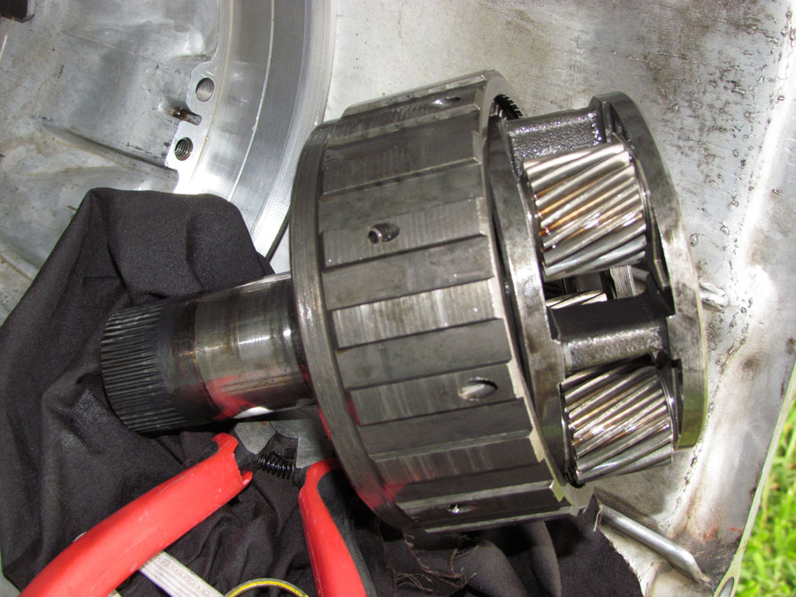

To Remove the Reaction Carrier you have to remove the small yellow clip
IMG_1258 - web.JPG (145.6 KiB) Viewed 20122 times
it will come out, it has a 4pinion planetary gear inside and roller bearing. This assembly is what links onto the output shaft.
IMG_1259 - web.JPG (164.04 KiB) Viewed 20122 times

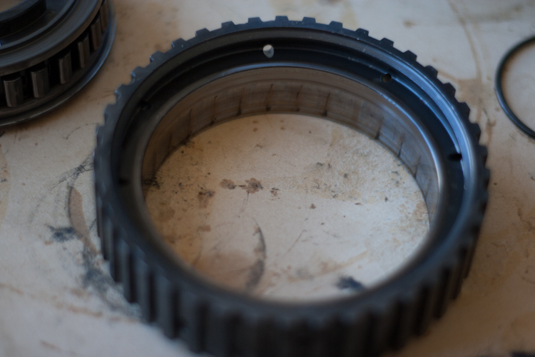

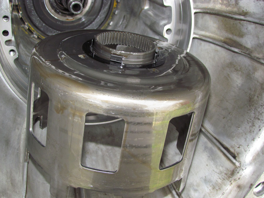

Then the Sunshell comes out it has a thrust wash inside and another on the other side, The Sonnax Smartshell uses a roller bearing to help with the wear on the inside of the shell
IMG_1261 - web.JPG (132.1 KiB) Viewed 20122 times

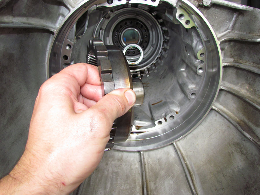

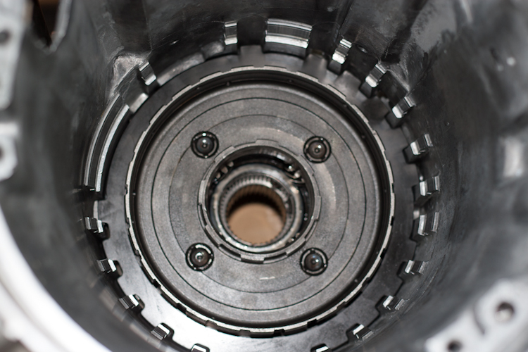

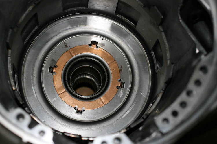

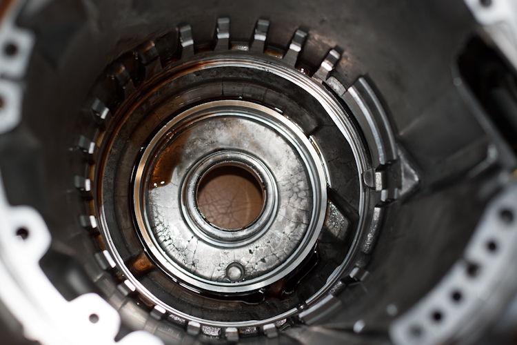

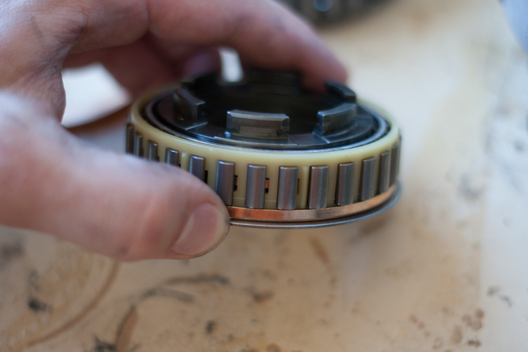

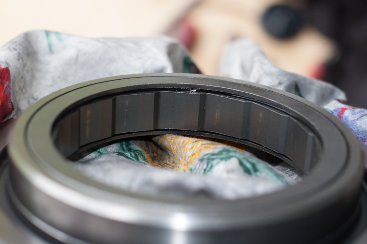

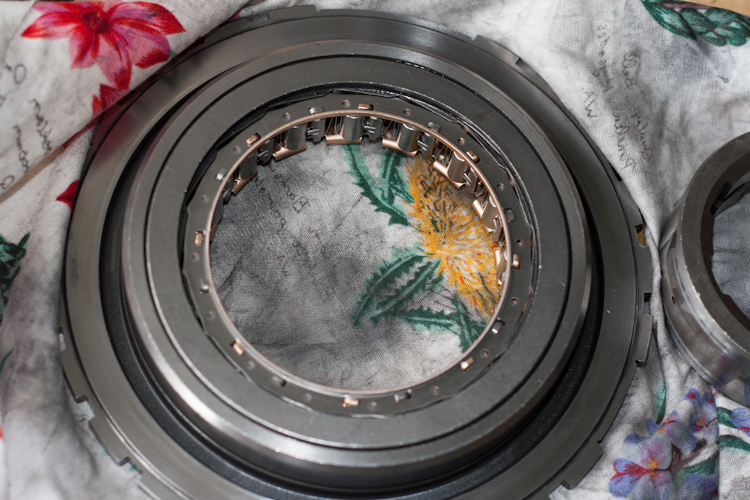

Next is the Low/Reverse Roller Clutch First Remove the big Yellow snap ring as seen above down the bottom, then the best way ive been told without damaging anything is to hit the output shaft, bit hard with a camera but use a piece of wood obviously, this will knock out the Clutch and also the anti clunk spring from the side of the case, the spring stops the clutch moving absorbs the impact while changing from Reverse to Drive and Drive to Reverse.
IMG_1267 - web.JPG (122.38 KiB) Viewed 20122 times
Then Remove the Low/Reverse Roller Clutch
IMG_1268 - web.JPG (274.03 KiB) Viewed 20122 times

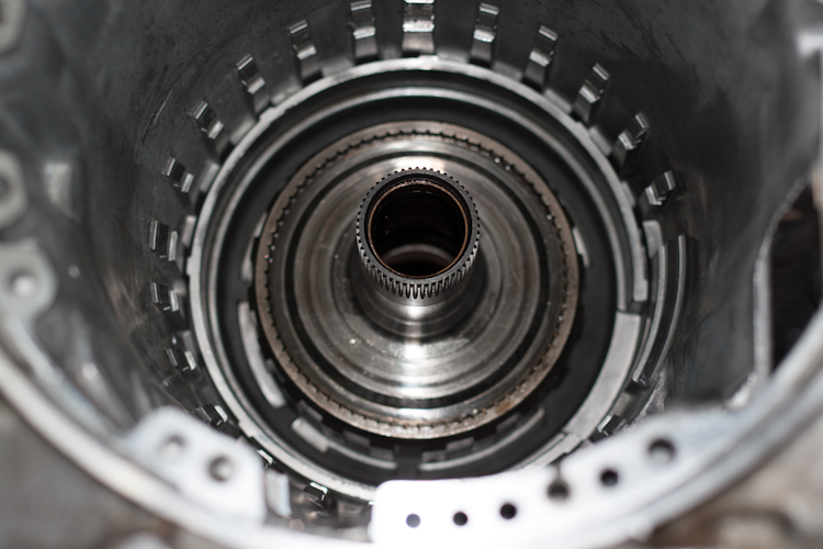

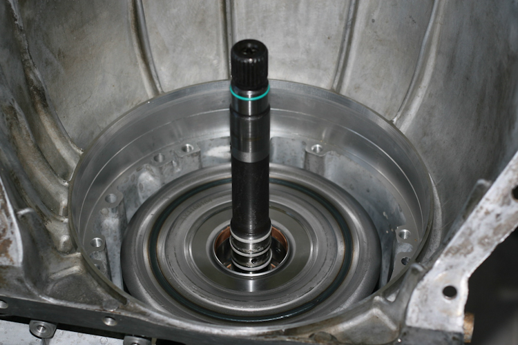

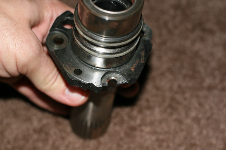

Then the Output shaft will come out
IMG_1269 - web.JPG (180.81 KiB) Viewed 20122 times

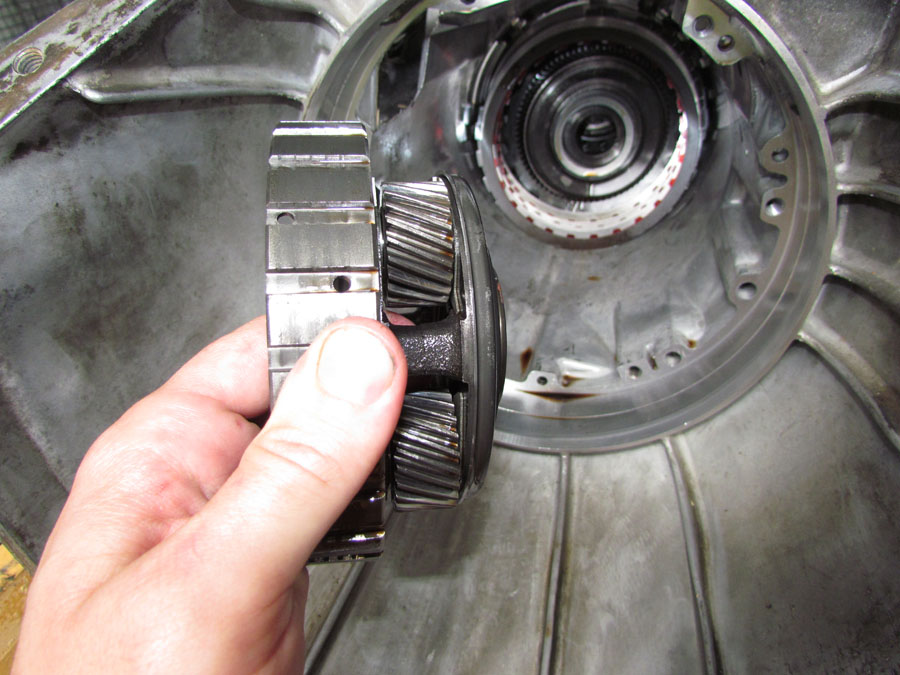

Then we have the 4 pinion Reaction Carrier
IMG_1279 - web.JPG (138.88 KiB) Viewed 20122 times

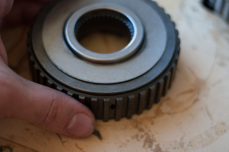

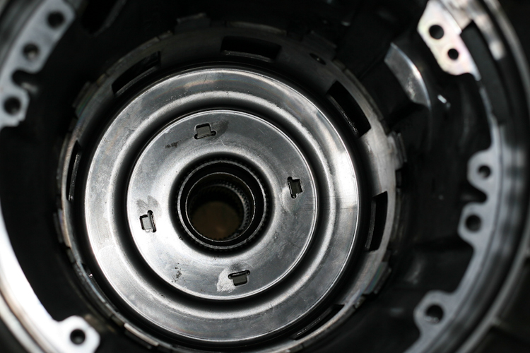

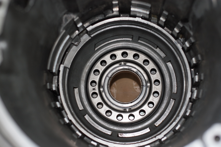

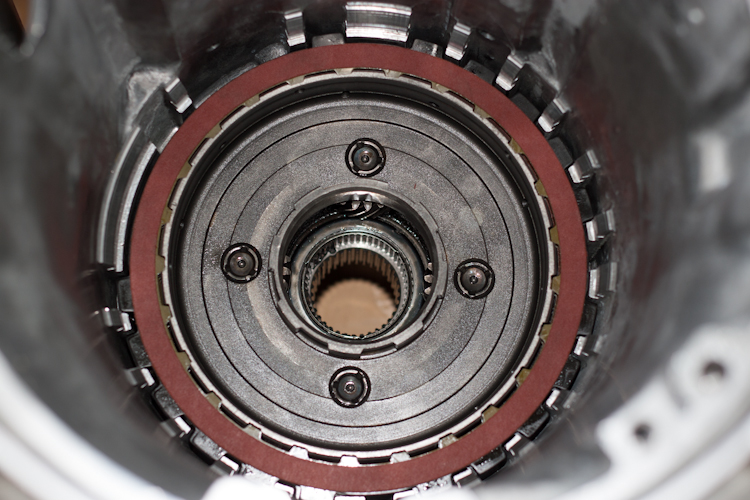

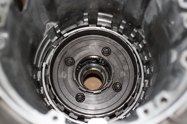

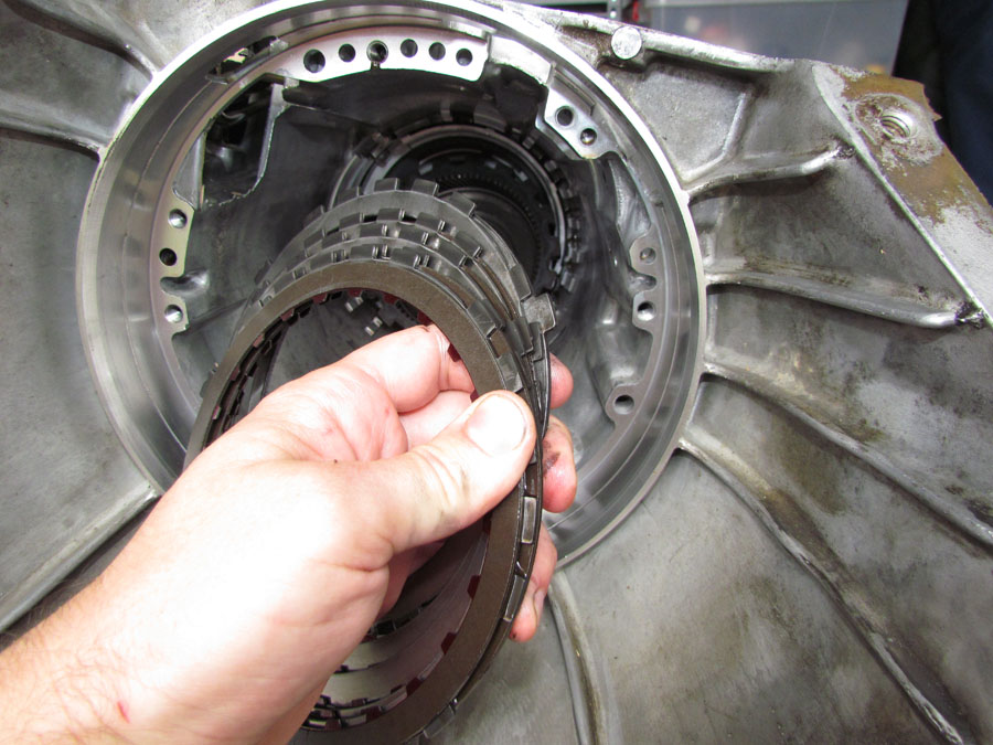

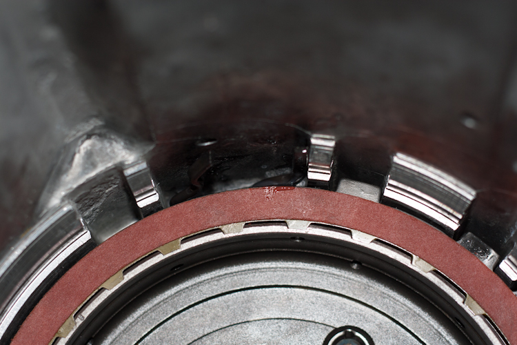

Low/Reverse Clutch Frictions and Steels
IMG_1280 - web.JPG (152.04 KiB) Viewed 20122 times

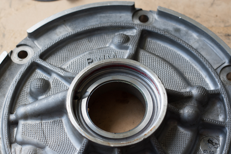

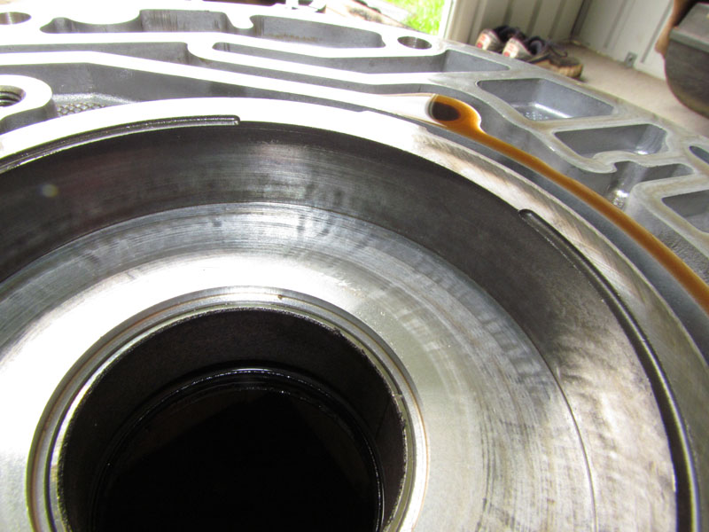

Pump

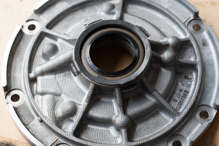

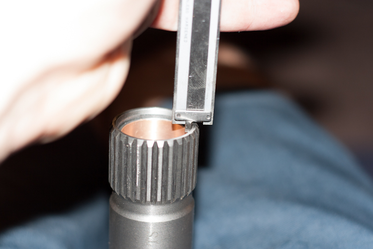

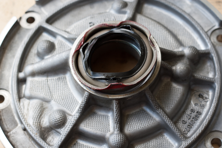

The pump's stator shaft has some damage, so ill be replacing it, it's a cheap item about $50 and this way will also have new bushings in it, one less thing to do, ill have to check inside the torque converter as well.

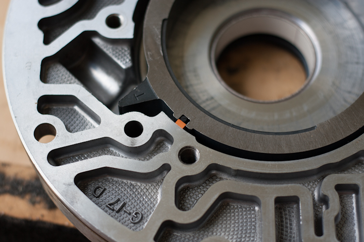

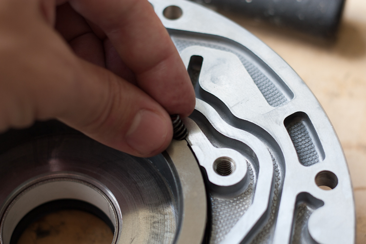

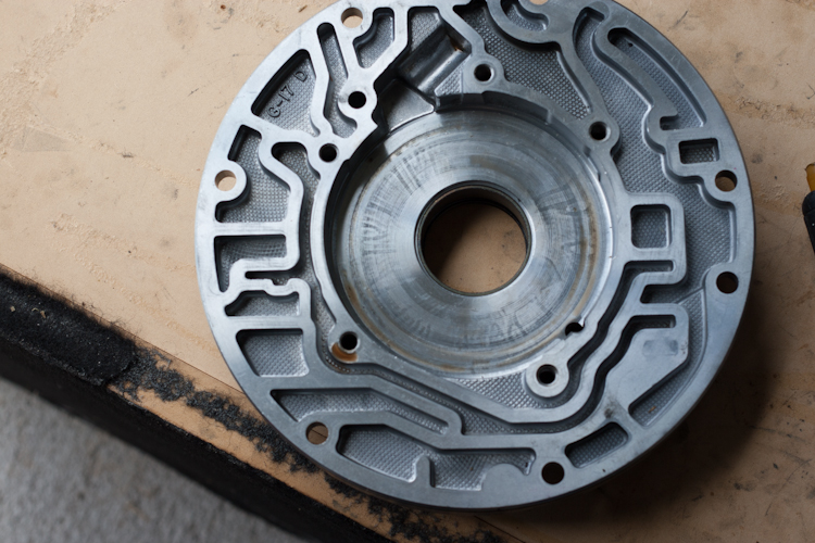

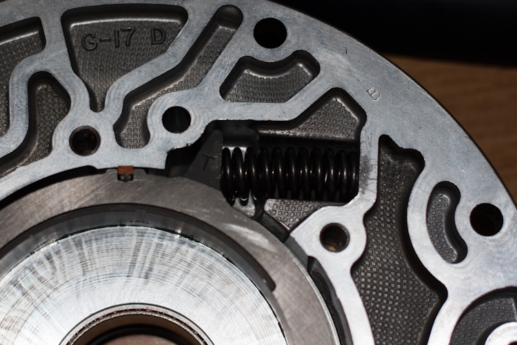

Take the 5 main pump bolts out and it'l split in half, mines a 10 vane rotor, some have less, these ones should have 10, you can upgrade to a 13 vane but apparently it's not worth it, wont give any more pressure and the vane rotor has issues with cracking due to less metal in between the vanes, especially at higher rpm's
IMG_1288 - web.JPG (284.63 KiB) Viewed 20087 times

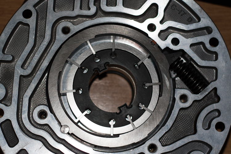

Check inside the walls for wear and vanes etc. No problems with mine here.
IMG_1292 - web.JPG (115.62 KiB) Viewed 20087 times

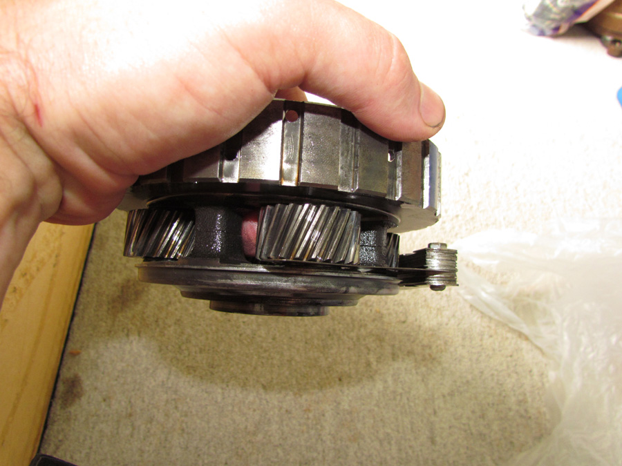

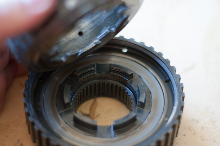

Planetary Gear

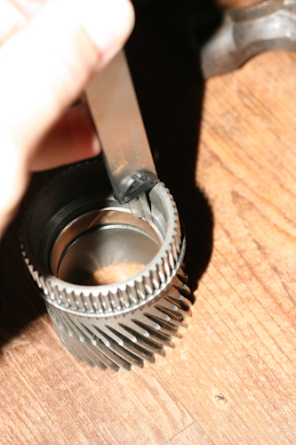

Check both planetary gears, check for side movement or damage on any of the gears, then check the end play in the gears between the gear and the washer. It should be in range of 0.21 - 0.61mm, mine were all around 0.40mm which is fine, no gear damage and no bad movements.
IMG_1283 - web.JPG (191.66 KiB) Viewed 20087 times

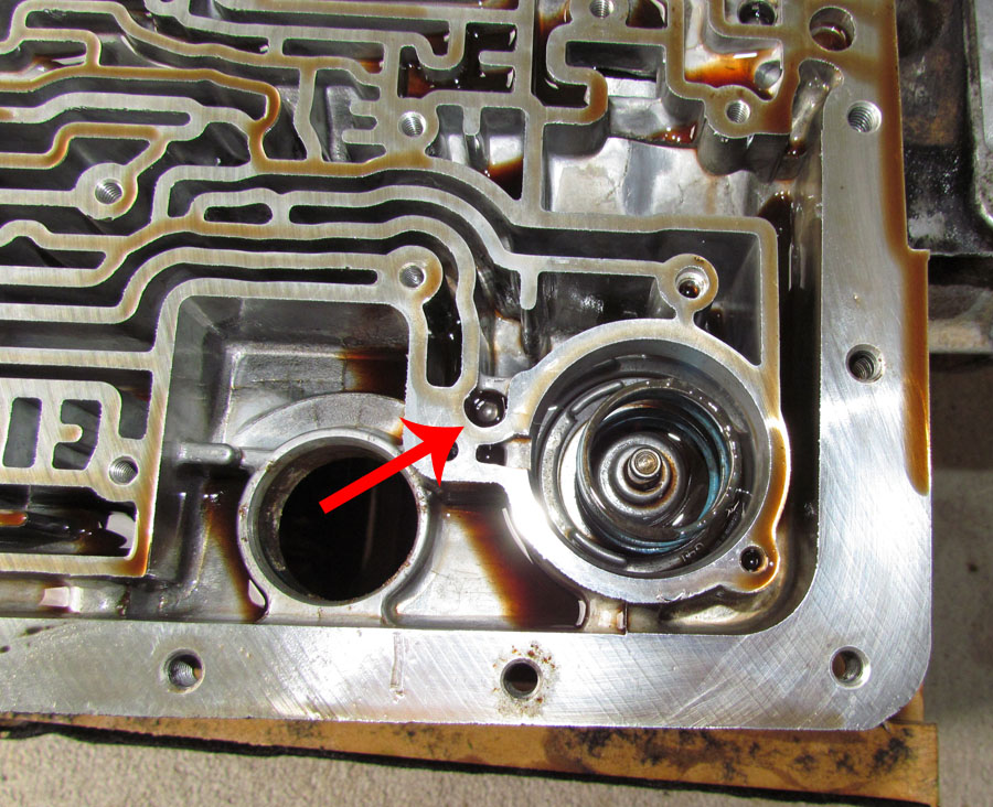

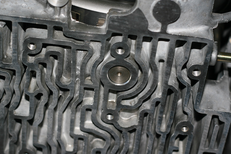

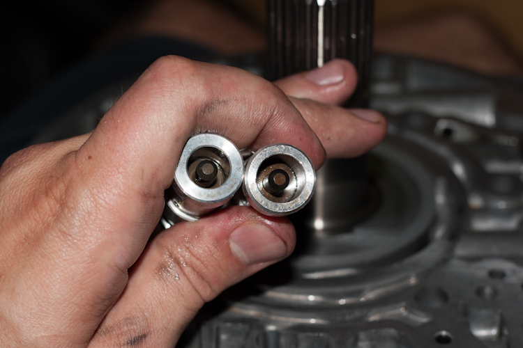

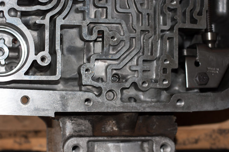

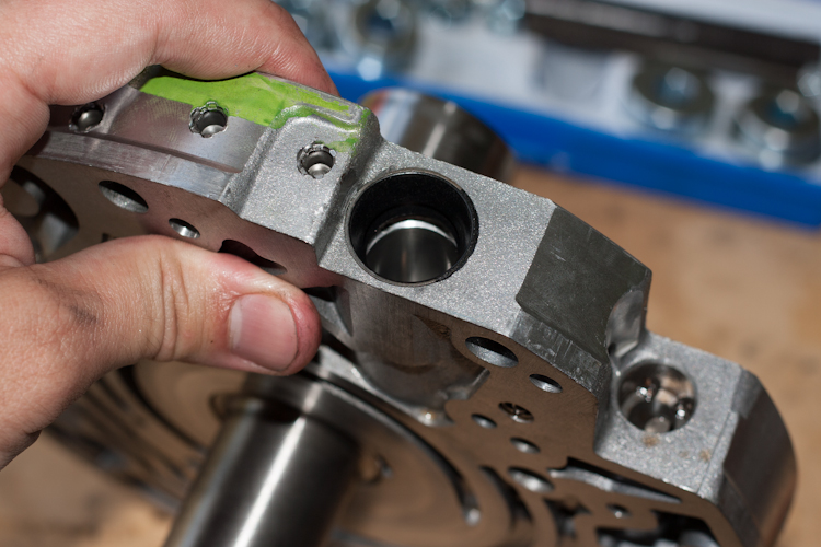

Valvebody
For the valvebody we need to check all solenoid resistances, check that valves are free to move in the bore and that there is no damage or excessive wear on valve parts, some valves can be checked for wear in there bore by shining a light behind the valve in the bore you should see no light passing around the valve from the other end. You can also use a pick to push the valve against the spring then let go and it should move straight back freely be careful not the scratch the bore or valve. On my valvebody here all valves were spotless, solenoids tested fine and i have also now installed the pinless forward accumulator. Checking your solenoids they should read in the ranges below.
Shift Solenoids 20 - 40 Ohms
3-2 Downshift Solenoid 10 – 15 Ohms or 20 - 31 ohms
TCC PWM Lockup Solenoid 10 – 15 Ohms
Force Motor or Pressure Control Solenoid 3.5 – 4.6 Ohms

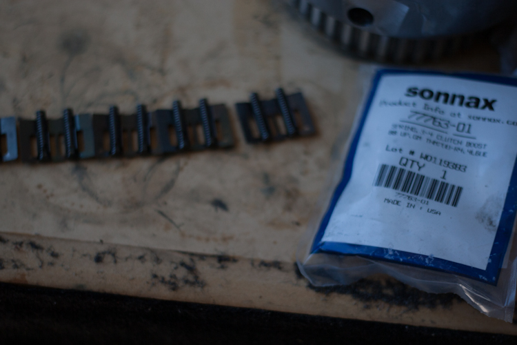

I then installed new seals on the solenoids from the master kit. The Torque settings for the Forward accumulator housing bolts and force motor bolt is 7.9 - 8.3 Foot Pounds.
Also a note about the valvebody plate, when purchasing a plate there are two different ones depending on which 3-2 downshift valve you have. Check your valvebody stamp date 95 is different to 96.

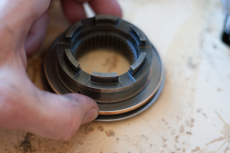

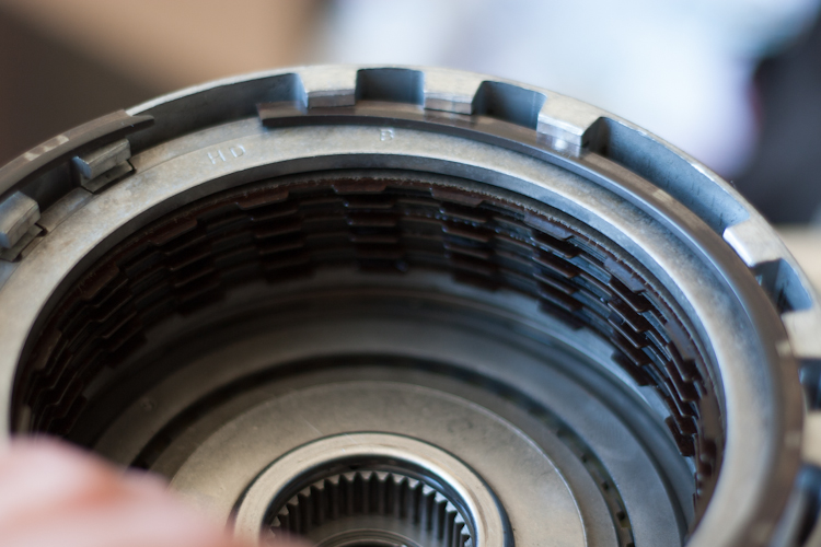

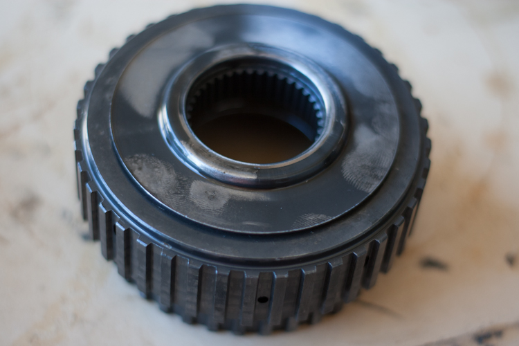

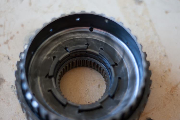

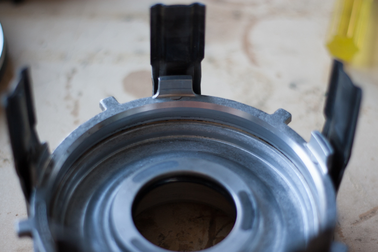

Rev input Drum
For this part i bought a new reverse input drum, fairly cheap and this way you also get new bushings factory installed, it's also a good idea if your using a new band, it's a bit like brake pads you use new discs with new pads.

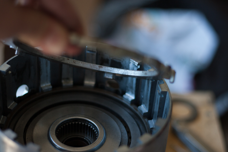

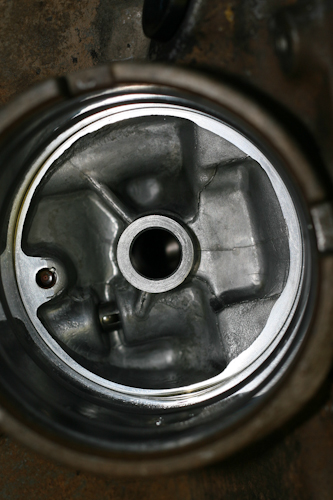

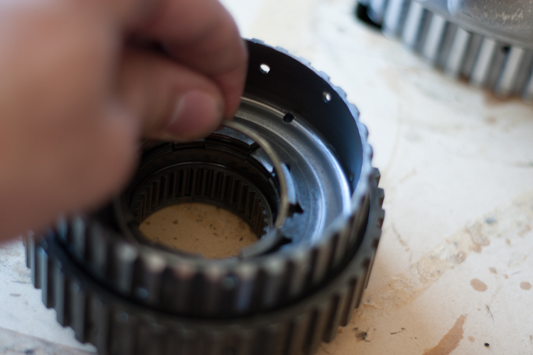

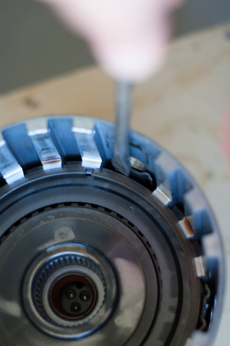

So first need to pull the snap ring out of the drum.
Then take out the steels and clutches

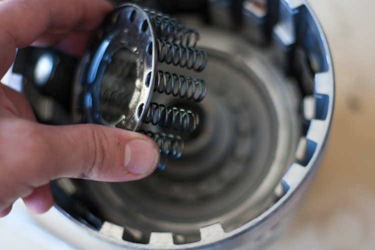

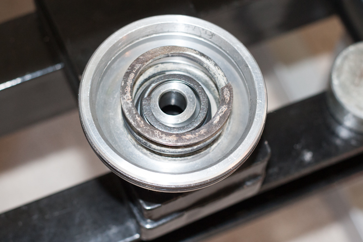

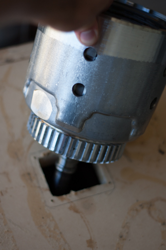

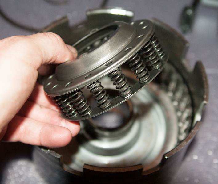

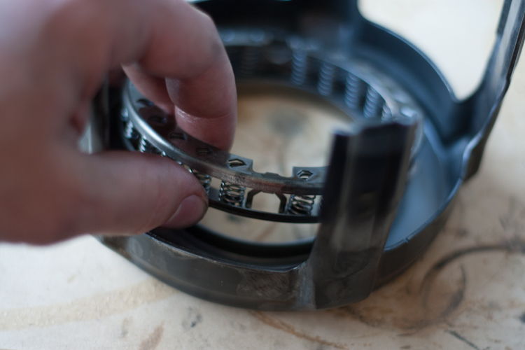

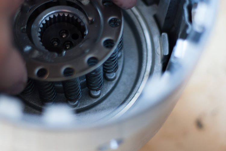

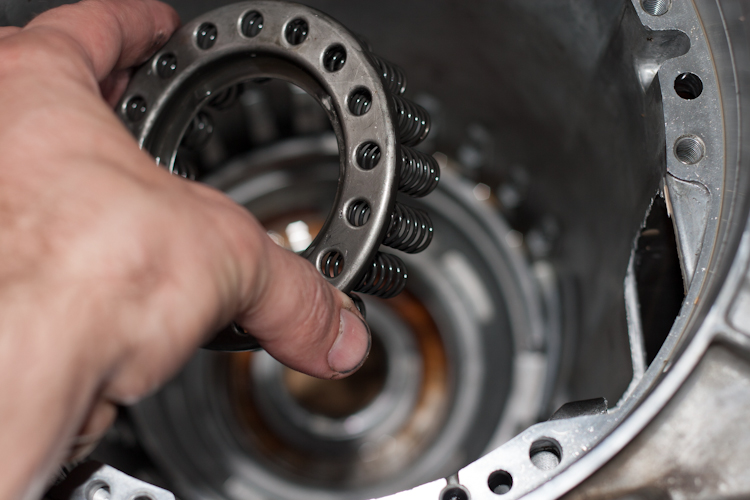

Now we need the trans spring compressor to compress the spring cage so we can remove the snapring.
Then spring cage comes out

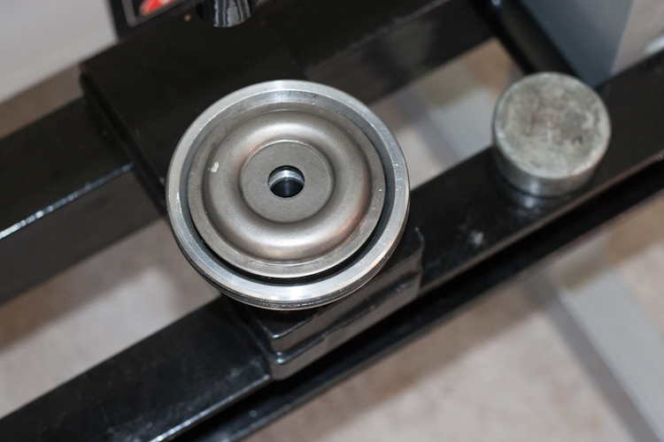

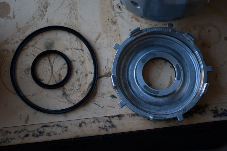

Then we can remove the piston at the bottom of the drum

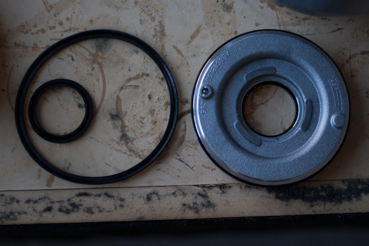

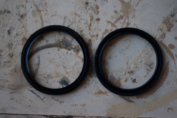

Now we need to put new seals on the piston from the master kit and install into our new drum, make sure you install the seals the right way as they have lips lip edge hanging down, use petroleum Jelly on the inside of the drum and on the piston seals, you need to lube them as it's very tight to get in, also you will need something thin like a feeler gauge to take around the inside of the seal edge to make sure it does not crease backwards while working it down, it's tricky to get in and you can't push down.
Reinstall spring cage with compressor and install snapring back in

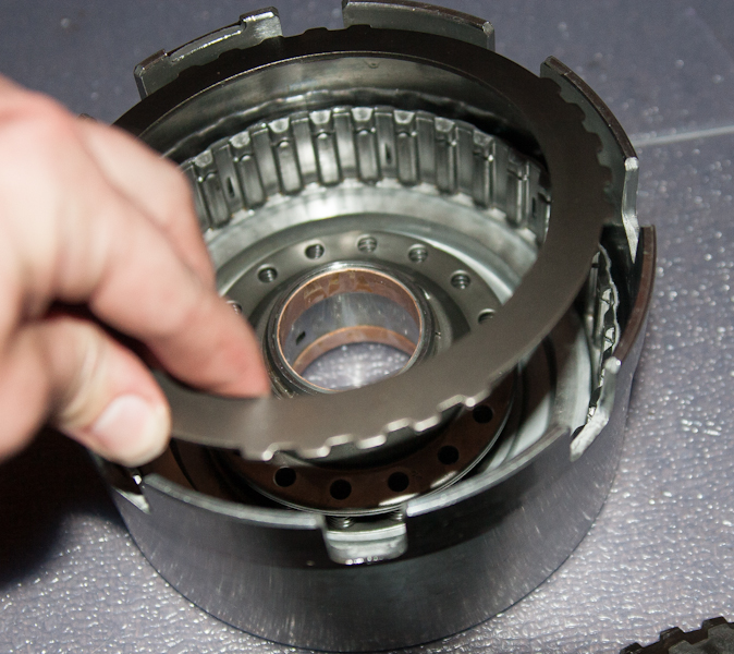

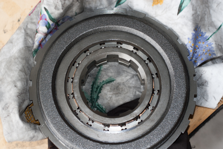

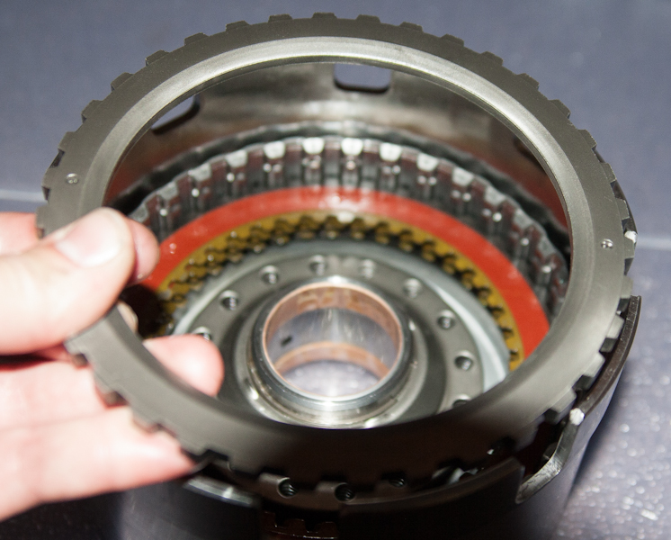

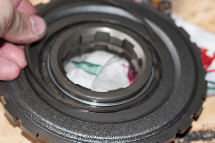

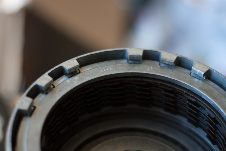

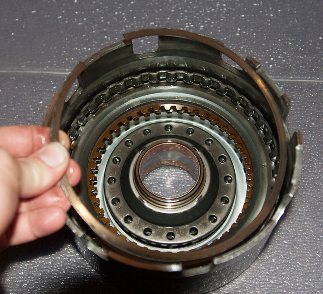

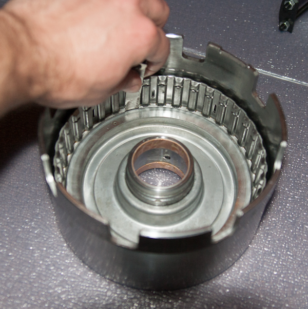

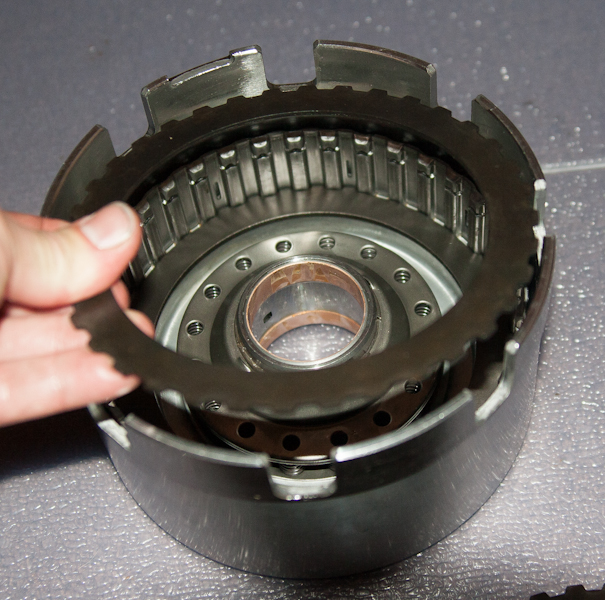

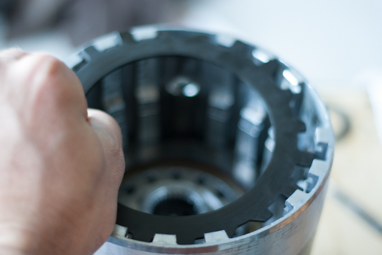

Next you can see the new alto clutches and kolene steels, the old top and bottom steels will be reused. Also it is of much debate weather or not to soak your clutches before install, i decided to coat them with oil.
Next is the cushion plate, should be installed cone side up or raised side up.
Next install a steel
Then install a clutch, do this in this alternate order for the 4 steels and 4 clutches
Then reinstall the pressure plate with flat edge on the bottom
Reinstall the snap ring
Now we need to measure the clutch pack clearance between the snap ring and top of the pressure plate, it should be in the range of 1.02-1.94mm, mine was 1.40mm, if it's not correct you can buy different thickness of pressure plates.

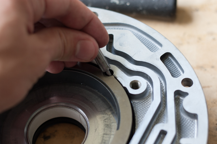

Next to test the piston you can use 40psi of air in this hole to test the piston movement.

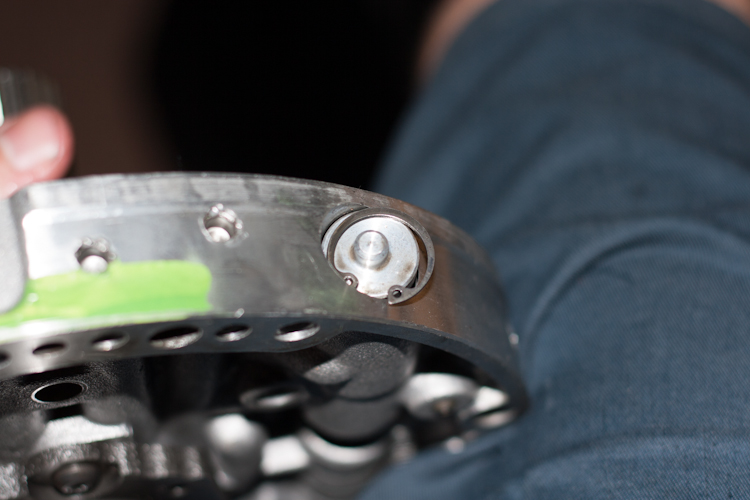

I had a few of them break the reaction shell a few years ago they did an upgraded one called a beast reaction shell might be worth looking at they strip the gear clean off.
Posts: 4810
Re: 4L60E Complete Rebuild
Yeh the beast sunshell has stronger weld's along the lip to the gear ring, im going to use the sonnax one which also is treated and uses thrust bearings instead of thrust washers, this is ment to help lightn the wear load. Which should have been the case in the first place i would have thought, the thrust bearings are used in all the other component faces. The next thing to wear is the front or rear planet gears. Ive been advised to stay away from aftermarket planet gears and only use acdelco ones, you can use the upgraded 5 pinion gear from the 4L65e. Mine were all well within wear limits and showed no issues so keeping them.
http://www.sonnax.com/product-lines/hig ... parts/1338
Here's my shopping list atm some of the items come in the rebuild kit, should make a strong trans and handle a boosted engine if that ever happens, the parts should get oil where needed better and give longer component and clutch life. Interested in peoples thoughts :geek:

As i understand it the Boost valve will increase line pressure as throttle increases, The exhaust valves help quicken the release, 2nd servo is an accumulator for 3-4 clutch pack and Servo's will quicken band apply, a wide band is also on the list along with a new reverse input drum for it to wear to. The Accumulators are double seal and upgraded springs will make them stiffer but still give some cushioning. The Red Eagle clutches are also upgraded over stock ones and from then on the rest is just new parts or hardened parts to fix stock issues and help longevity.
