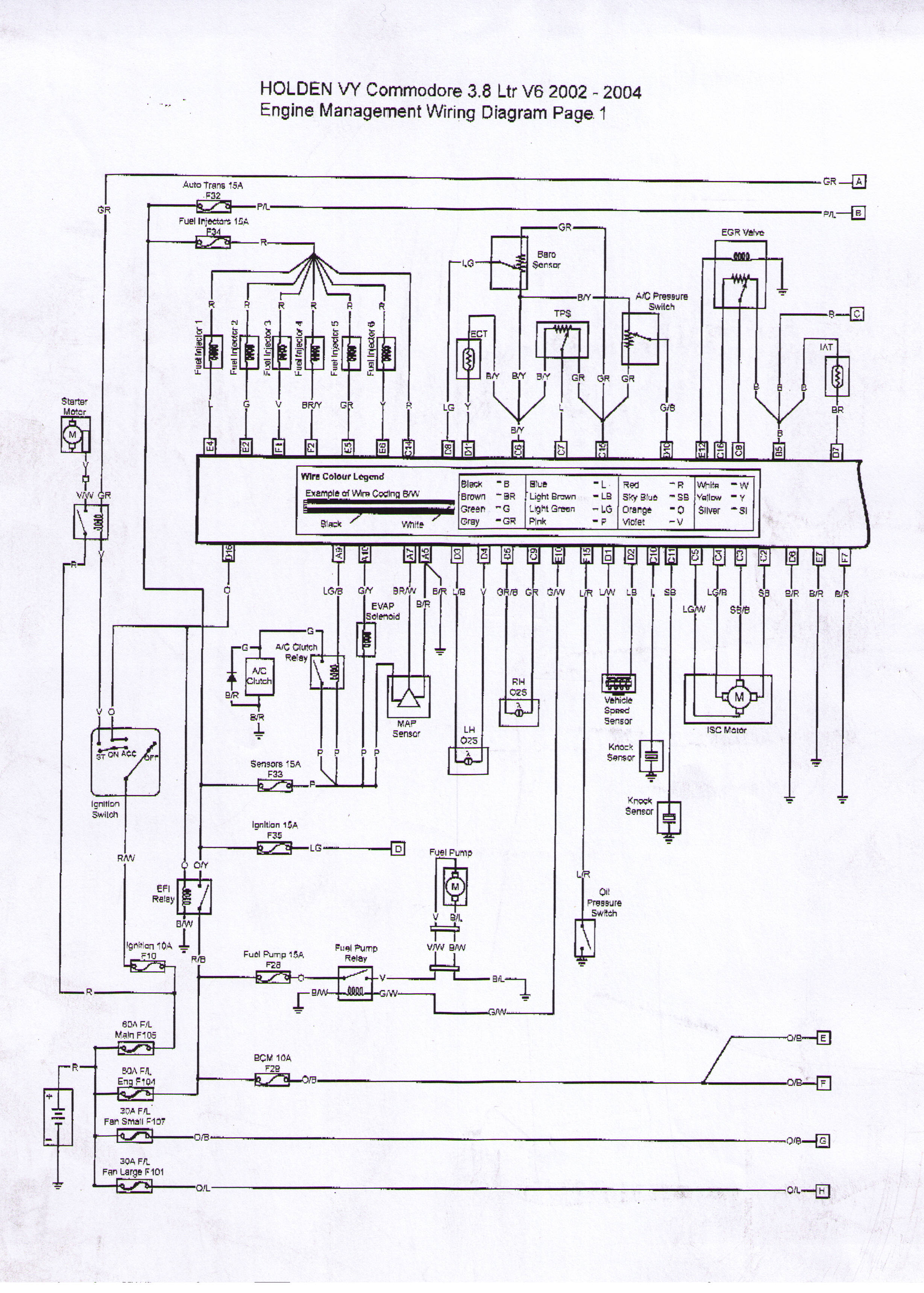

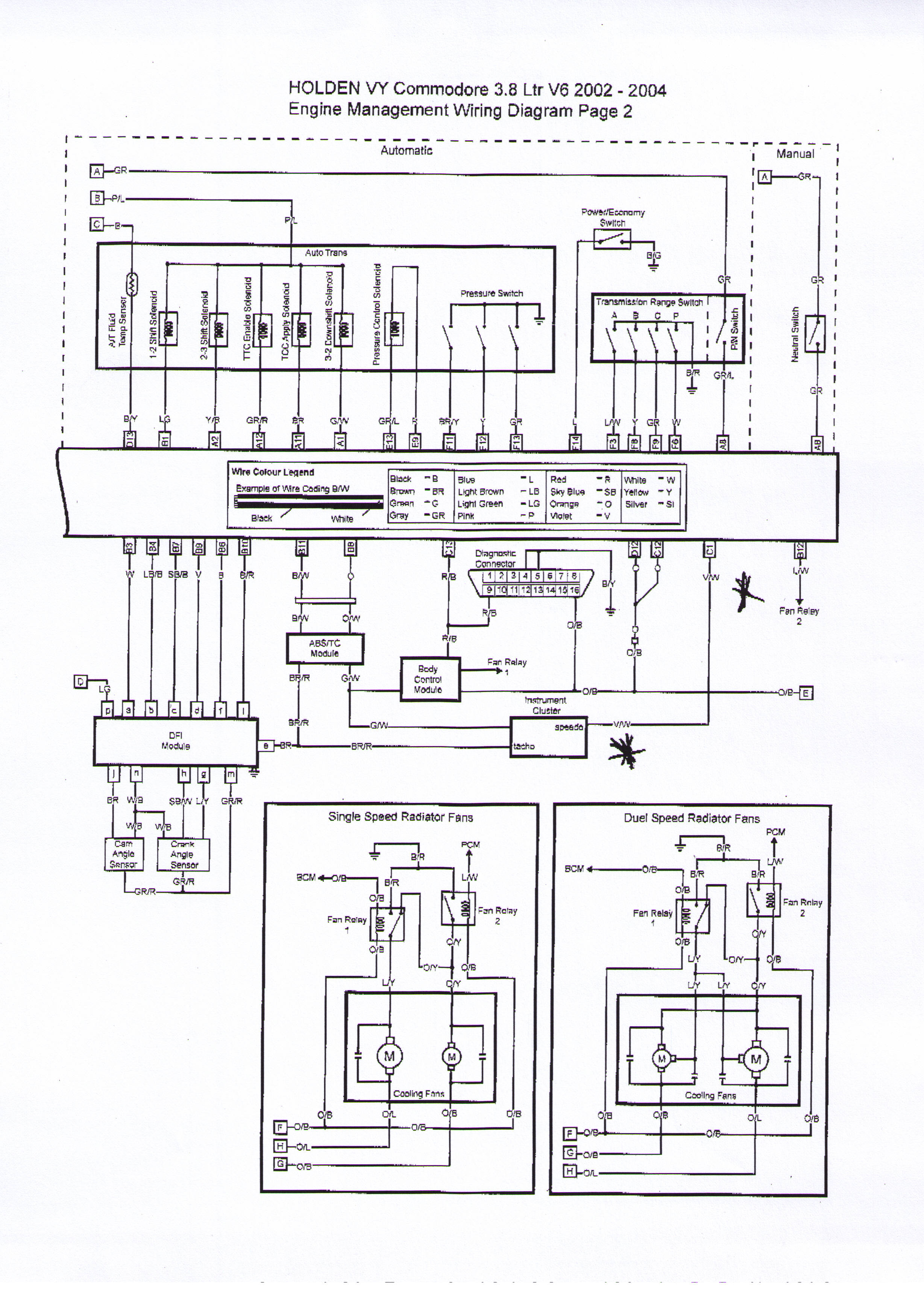

Not sure if these are the same as other listings but pretty simply laid out;
VY Ecotec 2002 to 2004 Page 1.jpg (1.16 MiB) Viewed 27403 times
VY Ecotec 2002 to 2004 Page 2.jpg (1.04 MiB) Viewed 27403 times
