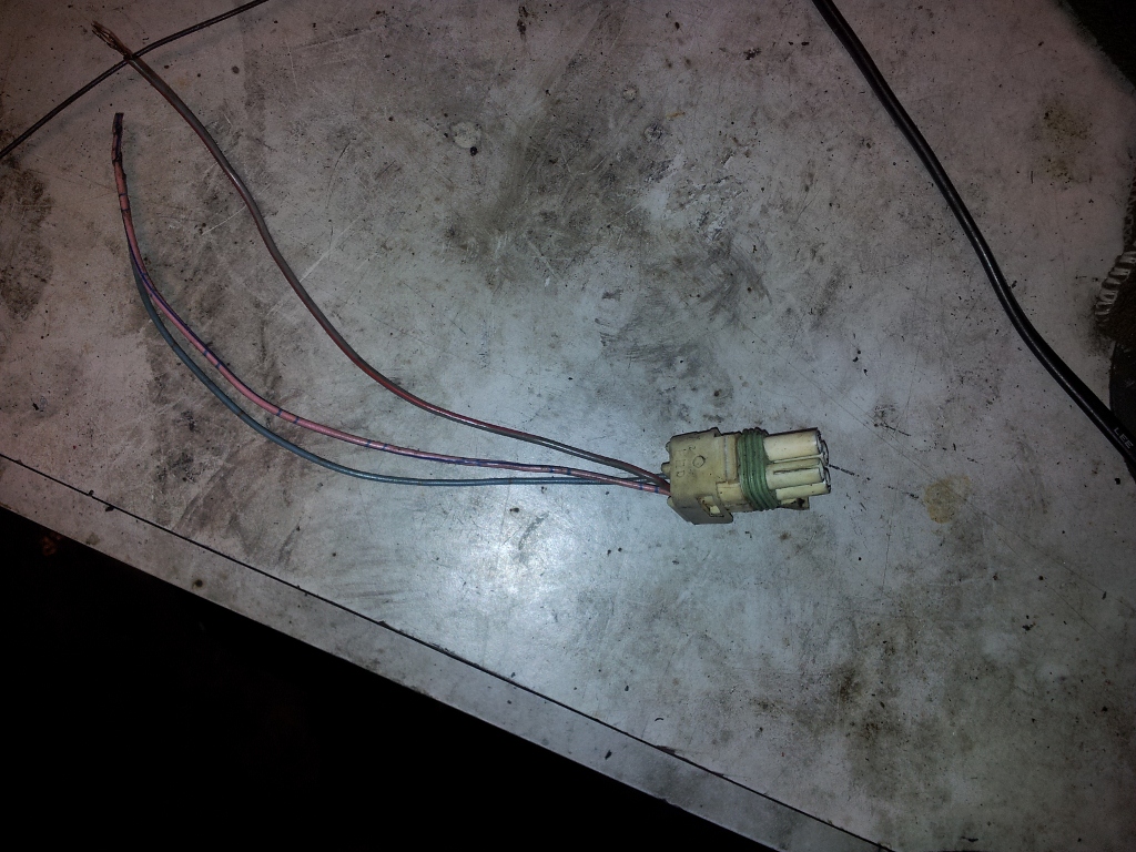

Gday all just finishing off a v6 and auto conversion from vn into vb all is going well except I havnt got the three wires from the left side of the auto connected from what I can gather they are the torque converter lockup wires what plug on the engine loom do they connect into or what pins on the ecu plug do they come off? Any help would be great thanks, josh

Na sorry not the speedo plug I no which one that is I have an autometer speedo its the other plug on the left of the boc that comes down from the top with a pink , blue and grey wire:-)

This plug

There should be a connector on the same section of the loom that the speedo sender plugs into.
On the V8 the wires are as follows
grey/red, tcc solenoid control, ECU pin A7
lt blue 4th gear/overtemp signal, ECU pin C7
pink/blue ign 12v
I would imagine that this part of the electrical would be the same on V6/V8 because it is part of the body loom not engine loom
Re: T700 wiring
yeah thats correct, you need all three connected for the TCC to work properly.
