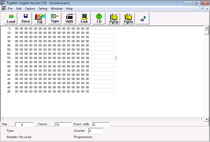

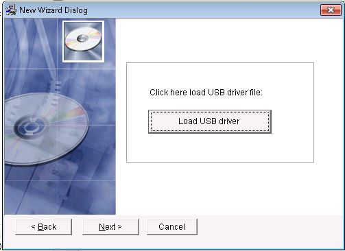

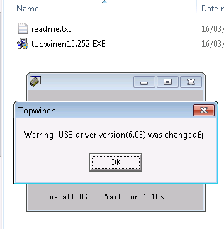

Posts: 9009
Re: top2004 eprom burner
I'd suggest googling for the software, and install that. Then see if you still want it. I dont have the hardware, and kinda feel dirty for installing the app.
Heres an idea of what your getting yourself in to. Do you feel lucky? :lol:
