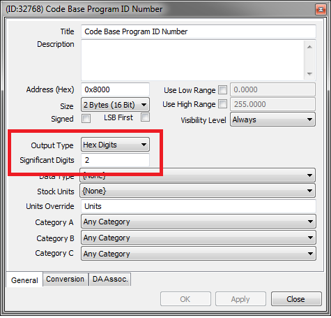

Howdy all,
I was wondering is there a calculation or a setting you can use to view Hexidecimal in decimal? Ie; show 37 B6 as 14262
Cheers VX L67 Getrag

For the XDF? Edit the item and play with...
ADX is prety much the same, edit the item and on the conversion tab there is output format and output digits.

Thanks VL,
I have them showing in hex digits, but they show as digits like the example I gave 37B6 instead of the full decimal value?
Re: TP5 values shown as decimal?
Yeah change the item to floating point, or even integer, and it will show 37B6 as 14262 (floating point with 2 digits would show as 14262.00)
