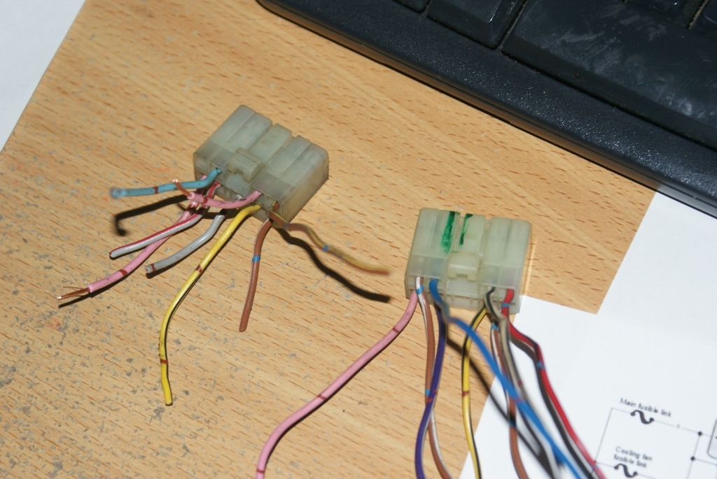

now my first issue ive noticed is the wiring from vr to vn is different under the dash.
there is a 9 pin connector that appears different between the model. also seems to be missing the A8 aldl wire as per VR V8.
looks like this is part of the problem??
has anyone changed the looms and had the same issue?
is the wiring the same for a 808 and 802???
Re: 12p 2 bar 304
now looks like C1, C12, B1, A10, A12, A7 and D6 are the ones on the connector from the Vr Auto loom.
guess i need to work out where they go to the vn 808 loom?
