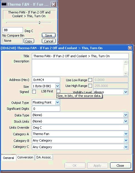

I use Tunerpro on my desktop PC. It has suddenly started showing some parameters in hex numbers rather than degrees. How do I fix this?
If I install TP RT it works ok.
tp shot.JPG (59.22 KiB) Viewed 2490 times

I'm no expert but first make sure you dont have show in raw hex ticked when clicking on object, next 'll have to check when at workshop on monday but I think if it's shown in the format of floating point or integer it will be in hex format, but all depends on what xdf your using?

Try opening any table (not scalar or flag) and right click on values in the table. Should have an option of "raw hex" or "calculated value" or something similar, make sure calculated value is selected as this appears to be a global setting affecting all TP terms. There is probably an easier way to do it but this works for me.

Yoda that fixed it. I was looking at the spark maps in hex and calc values and I must have left it in hex. Thanks!

I just found the "proper" way to change it by accident. Tools, Preferences, general tab, then display data pull down for hex or calculated.
