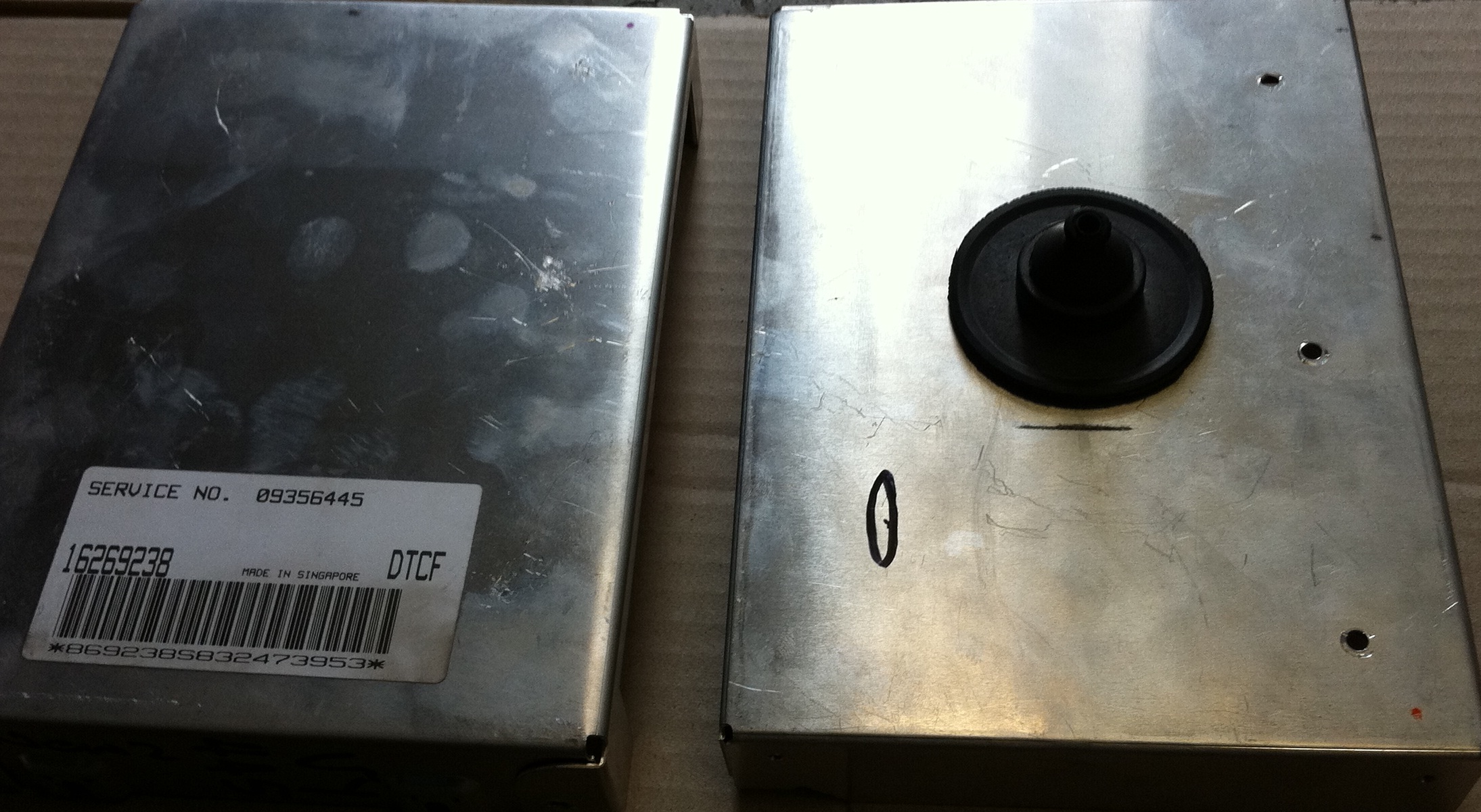

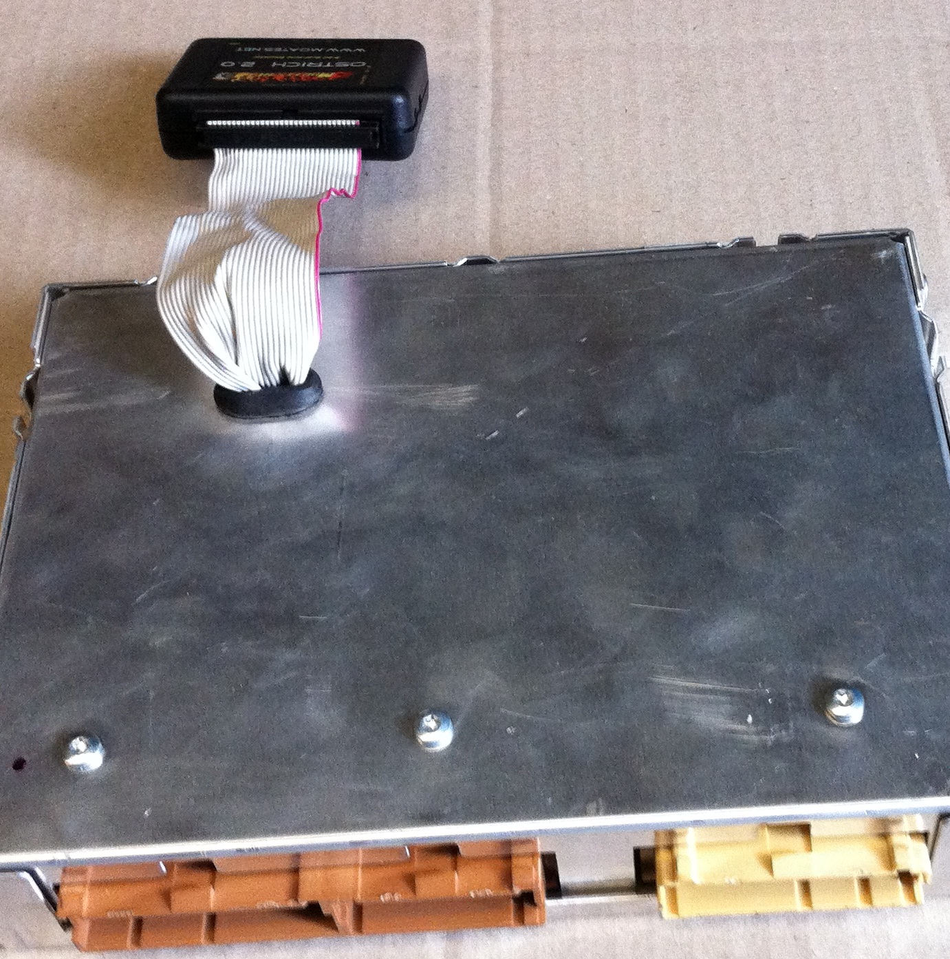

further update...
1 more drive to & from work & no more cut out issues or errors, but again nothing has hit the PCM again either!
I've attached photo's of VL400's soldering work & snotting(although it did get changed after this as wiring config was wrong)!
I've also added pictures of how I secured it back in case & ran floppy through grommet inside pcm with big section internally hoping to secure wires better & then with the ostrich connected(1 more photo to follow).
- Ostrich Installed 1.jpg (889.77 KiB) Viewed 28774 times
- Grommet outside PCM.jpg (722.54 KiB) Viewed 28774 times
- Grommet inside PCM.jpg (769.92 KiB) Viewed 28774 times
- PCM Case Seperated & grommet.jpg (710.06 KiB) Viewed 28774 times
- Snotted.JPG (562.93 KiB) Viewed 28774 times
- Soldered.JPG (445.18 KiB) Viewed 28774 times
- Posts: 2959
Re: REALTIME VX-VY n/a PCM
by the way the photo's loaded in the reverse of what I uploaded so read from bottom up!
The hole I drilled in the back(lower) section of case was 40mm from the rear & 55mm from the side!
The grommet was from a BA-BF bonnet release cable as only changed a few hundred of these & had the biggest section to support internal wires!(just cut end off to make opening bigger)
