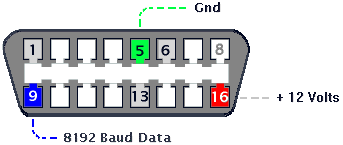

May also need to check the wiring, as I think there are some differences between 160 and 8192 baud rate.
EDIT: In 160 Baud ECU Pin A9 goes to the ALDL connector, and the data is on ECU Pin A5.
For 8192 ECU Pin A9 goes to Pin 6 on the ALDL connector and Pin A8 goes to Pin 9 on the ALDL, it is the latter which carries the 8192 ALDL info and is most likely missing in your case.
NOTE: ALDL connectors are different between VR+ vehicles (16 pin OBDII style) and VN/P which have a 6 pin connector, above ALDL pins refer to the OBDII style plug.
Attached images from the techedge website.
VN/P ALDL connector
VR+ ALDL Connector
Depending on your interface, it may or may not support 8192 baud rate.
Yoda

Yes, my ECU connector is missing A8, so if I place a wire into A8 and put that in the place of 'E' (A5) on the diagnostic connection, I should have 8192 baud?
Re: VP V6 Auto - TunerproRT OSE$12 i'm stumped
Yep, and if your interface supports 8192baud ALDL (hardware wise it will be different as 160 baud is uni-directional) then you will be able to log it.
