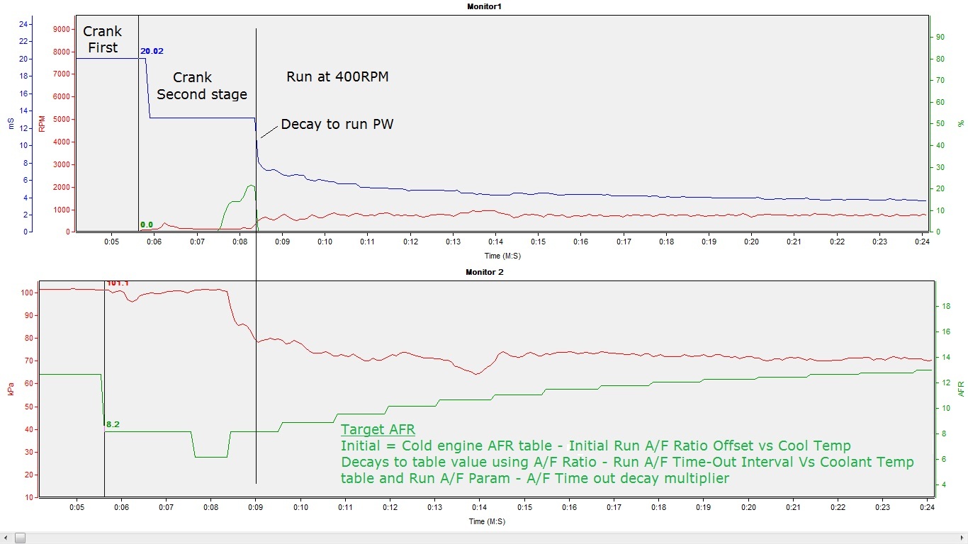

And a picture to show the issue and which tables are in effect post start...
It starts using the cranking PW tables, and also decays them after a long crank. After the engine hits 400 RPM it changes to run mode. The PW is decayed to the run mode calculated PW, which is now using VE and target AFR tables.
I would be adding some more cranking fuel and see how it reacts.

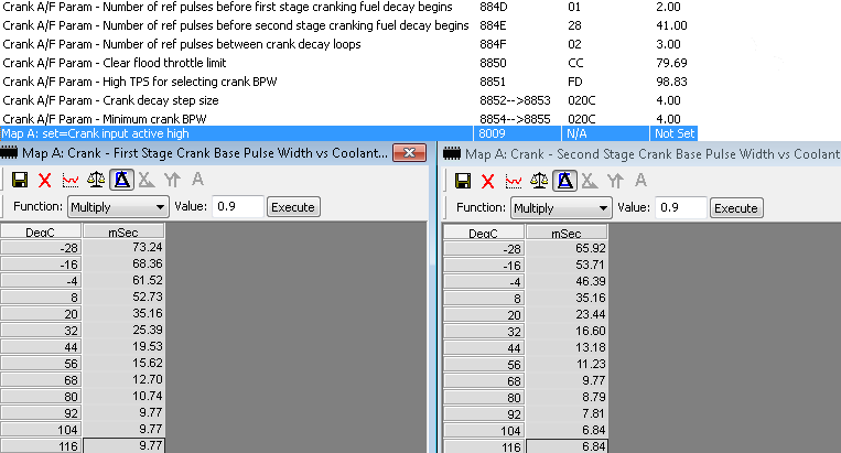

Just Noticed there was another thread talking about fuelling issues & not sure if it's 12p or while cranking but thought I'd upload this for reference of ALL fuel cranking terms in XDF there is obviously more for MAP/b but this is all the 1's listed I found!
