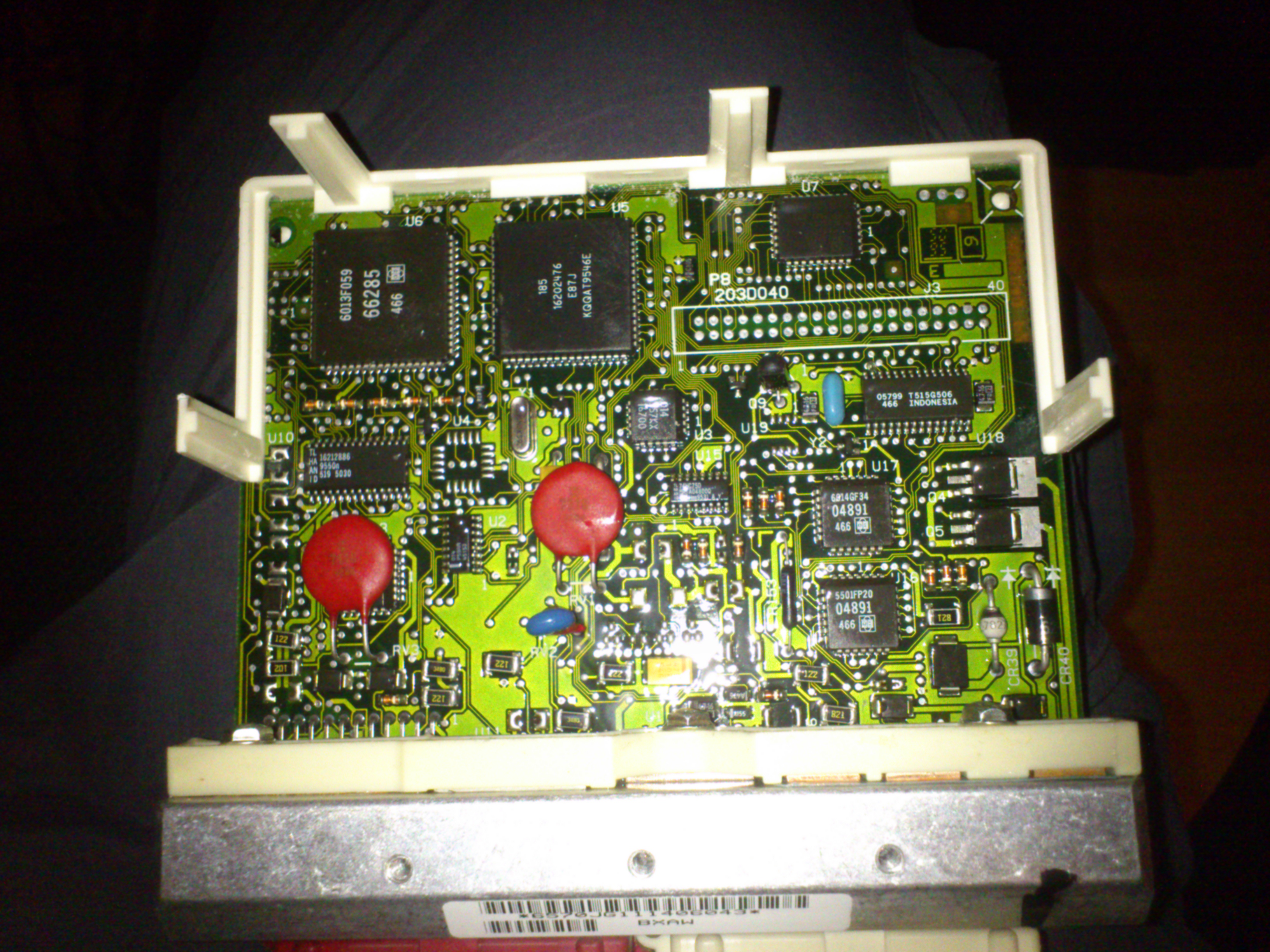

I need help in chooseing wright delco ecu to put in may Kadett c with opel 1.6 ohc ( c16se engine code ).
I hawe 2 delco ecus and they are both from 1.6 16v engines. Both have a knock sensor and they are dis engines with 60-2 trigher, cam sensor and egr. I dont need egr and cam sensor because i em doing race engine with throttle bodys and i need map sensor. I was runing this engine on bosch me ecu and it was workin fine with no problems.
This are pictures of ecu casings and insides.

Have you got definitions for either of them them? Do you have a way to flash the one that doesnt have a memcal?
If you have got definitions for the one with the BRDS memcal then use that one as it has a memcal. Looking around the internet BRDS does look like something people are tuning so if you can find details then go with that and please update this thread too.

BRDS pt fuel map is a 16x11 at 396C, pt ignition is 17x11 at 4330 I think but there's two more pt ignition maps following it.
Rev limiter looks like it's at 3F9E.
