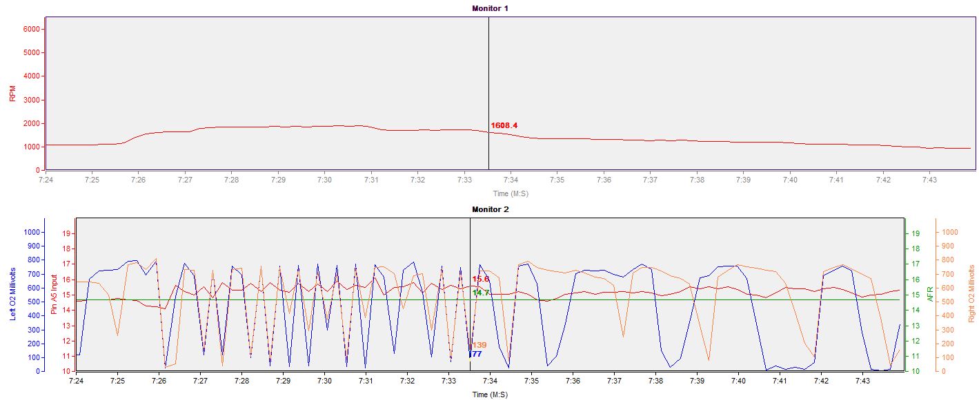

yep they're getting around 5-8 under throttle and the o2 millivolts swing either side of 450mV- RH LTFT usually gets its highest coming off throttle and then sitting at 0% TPS
I think I have a small rocker cover gasket leak on drivers side but I really dont see how that would effect afr..
Here's a trace of a recent log
o2-mV trace.JPG (104.04 KiB) Viewed 4363 times
Posts: 4811
Re: RH cylinder bank running richer..
Right hand side doesn't seem to like going lean as much as left does and when it does looking on the right side of the graph it's only for a small period of time. Not that it's anything out of the ordinary but it does fit your issue.
perhaps swap the o2's over and see if it follows and is a bank issue or o2 issue.
