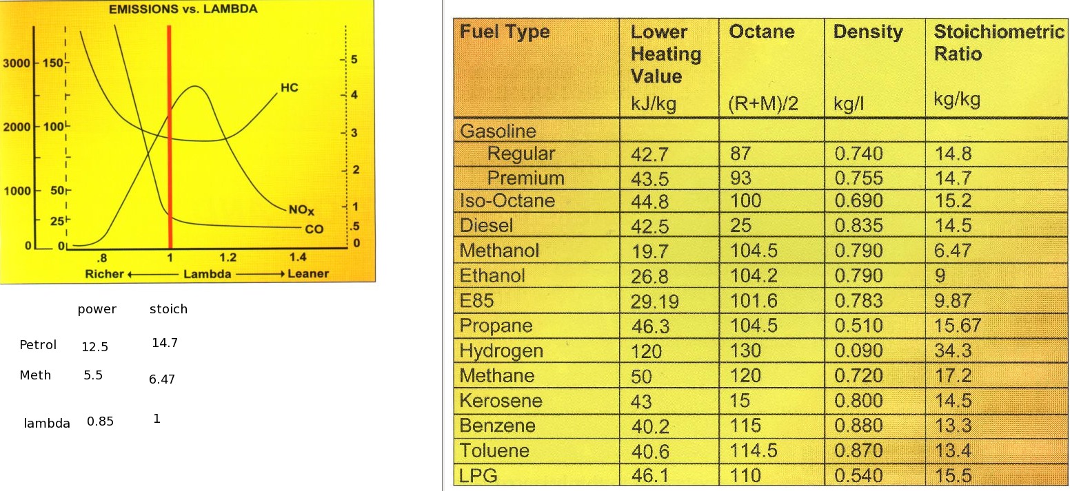

Heres some stats for different fuels. LPG should be able to make more power than premium 98, but you would need LPG injection to do it. Old school LPG might both mean wasted LPG potential, and an intake restriction on petrol :(

Thanks for the table antus, that also answered my next question of what the AFR on gas is likely to look like.

Helical wrote:Thanks for the table antus, that also answered my next question of what the AFR on gas is likely to look like.
Well, there is another half to that story. AFR is the air fuel ratio, on the input side before the bang. The O2 sensor measures the remaining oxygen in the exhaust. It actually measures lambda, where lambda 1 means stoich regardless of type of fuel. When your wideband displays AFR, it is converting lambda to AFR based on the assumption of fuel you are running (normally petrol). So, for LPG if you do not reconfigure the wideband, when it shows AFR of 14.7 its telling you lambda 1 stoich which really means AFR 15.5 for LPG. Until you look at LPG injection, this is not something you need to worry about. If you have the appropriate licensing to touch LPG and are just trying to trim the LPG mixtures with an old school mixer based on the wideband, then you can either reconfig the wideband for LPG and look for AFR of 15.5:1 or leave it as is and tune it like its petrol. You will get the same result. Technically it would make more sense for widebands to just tell you lambda always (most can) so you dont have to worry about the type of fuel, but its just not the norm.
