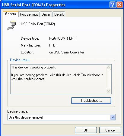

In order to use it, you will need a couple of virtual com port pairs, as well either a built in serial port, or a usb -> serial converter that supports the non-standard 8192 baud rate required.
prolific chipset usb -> serial adaptors are known NOT to work (and these are the cheapest most common type) and FTDI chipset devices are known to be good. You can check what you have by right clicking on the com port and choosing properites. If it says prolific you are probably out of luck. If it says FTDI you are good to go.

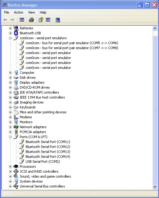

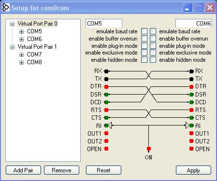

Next up download com0com. It can be found on sourceforge, and the download is here:
http://downloads.sourceforge.net/com0co ... 86-fre.zip
Install the program (you might need microsoft .net v2 available from microsoft.com). Then use it to set up two comport pairs, and number them between 1-9 where you can fit them. I used COM5 COM6 COM7 COM8. Then check back in device manager, you should see real com ports under Ports (COM&LPT) and virtual ports under the new category com0com - serial port emulators. My system looks like this:
