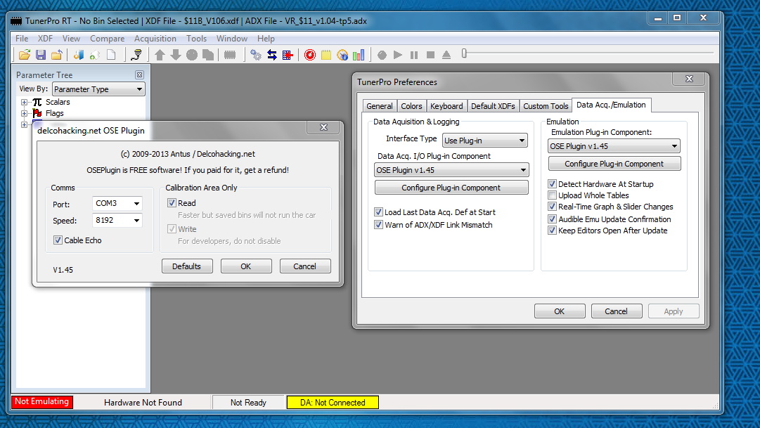

tp5 cant detect aldl cable on start up or if i try to connect to the cable ? i can see it com port and if i test it says cable found and functioning....wtf :comp:

need more info. what car, what are you trying to do (log or realtime tune), what method are you using (plugin, or native logging)?

plug in ose145 when i start tp5 it cant detect on start up vr v8 auto,
Re: cant connect to tp5 with delco usb
Can you log data? ADX from here .. http://pcmhacking.net/forums/viewtopic.php?f=10&t=29 "VR_$11_v1.04-tp5.zip"
Can you connect using the flashtool? http://pcmhacking.net/forums/viewtopic.php?f=3&t=82 . Setup is vehicle as 'VR in Vehicle', interface as 'USB ALDL' and com port.

tp5 cont conect to cable so i cant log

You might need to turn echo off in the adx when using the plugin, as the plugin will be handling the echo instead.

thanks ill try now been pulling my hair out for days

this is what i got i see my speed jump up and down any one got any ideas? i was parked??

good to have full support for a product so thanks guys turns out it was my p,o,s nortan security
