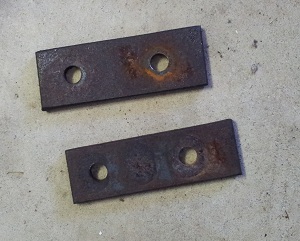

Here's a pair of manky old brackets I found, I'll de-rust one of them:

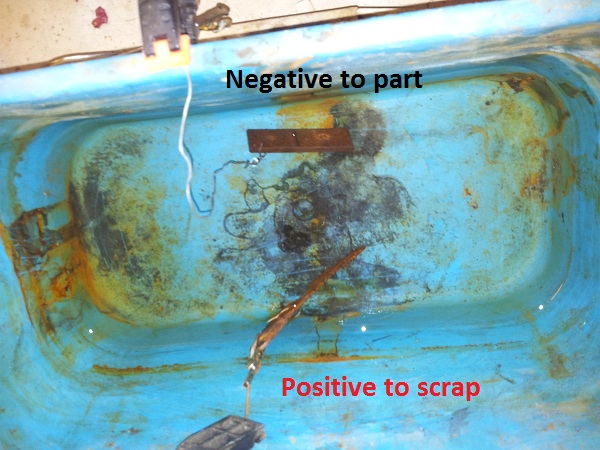

Fill your bucket up with enough water to cover the part, then hang the part in the bucket with a piece of tie wire.
Place a piece of scrap steel on the opposite side of the bucket, making sure it can't touch the part.
To clean both sides of the part at once, use one piece of scrap steel at each end and suspend the part in between the two.
Connect the part to your power supply negative, and the scrap piece(s) to positive.
Your scrap steel needs to be clean, and have a surface area bigger than the part you're cleaning, so thin sheet is better than solid bar scrap.
It will also be eaten up by the process, so don't use anything you'll miss!
Then add a small amount of washing soda. A tablespoon or two is all you need.
If you add too much the process can be too agressive, plus it's just a waste.

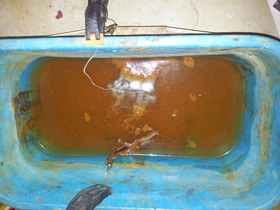

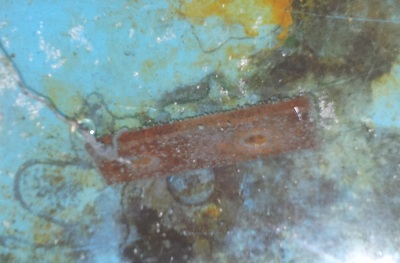

After a minute or two you will see some small bubbles forming on your rusty part:
The next day it will look a little bit different:
For large and/or really rusty parts they might need to be in the bath for up to a week.
Each day or so you'll need to change the water and replace (or at least clean off) the scrap steel.

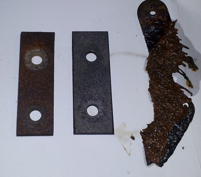

And here's the original bracket, the de-rusted one (after wiping down with a rag), and the sacrificial scrap steel:
The brackets are hot rolled steel bar, so that's about as good as it ever looked :oops:

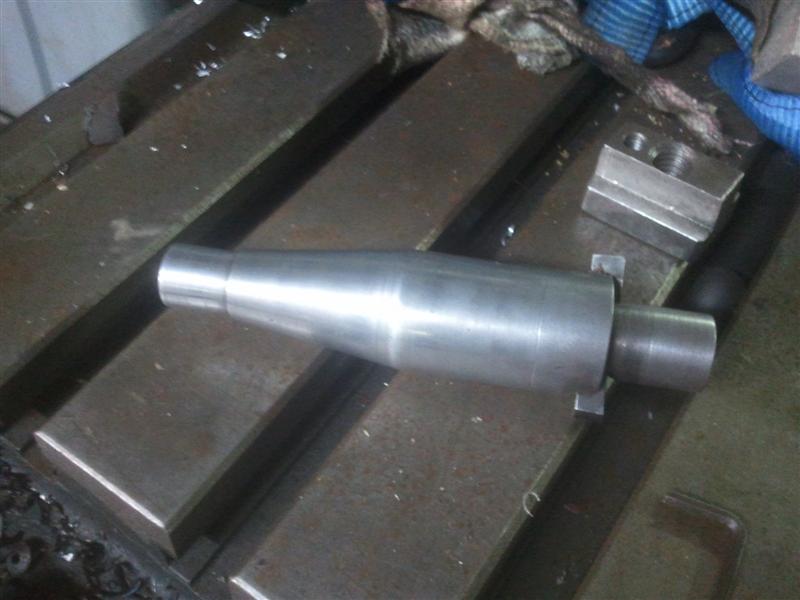

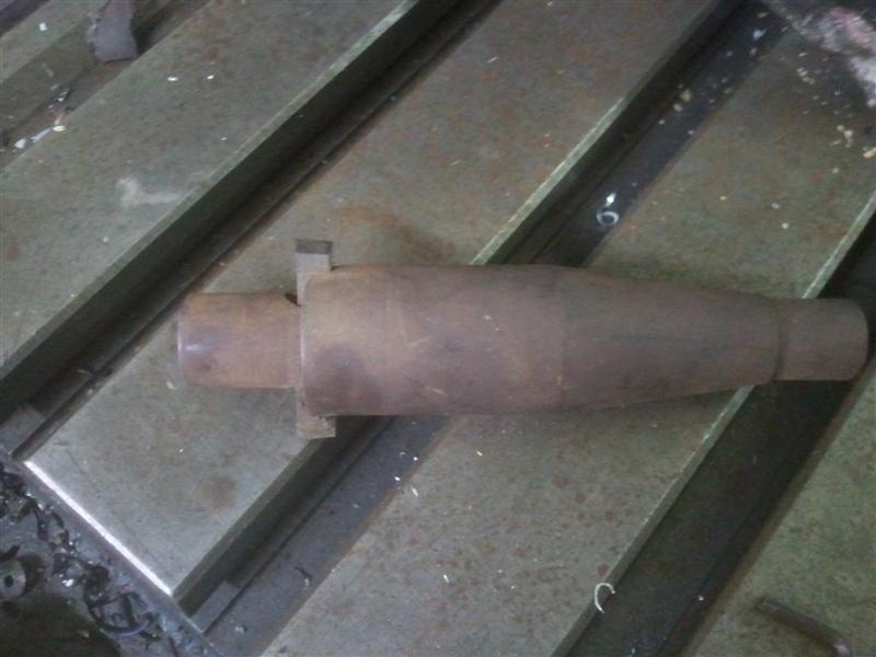

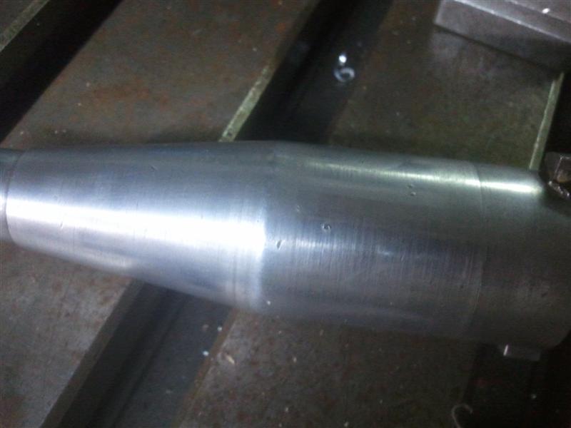

Here's a better example, a mill arbor I de-rusted a while ago.
Before:
After:
You can see it's a gentle process, the original turning marks are still visible in the surface - and there's a couple of old knocks and dents that stand out now.
