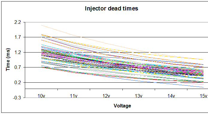

Re: injector opening times table
Without the Batt Voltage Offset specs from new injectors into the calibration? Tuning is a nightmare, if you can get it the VE table looks all wrong.... Some guys have said "well the car is always around 14 volts when running!" Look at that chart and see some injectors are 1.xx and some are .15 at 14 volts?

Old thread - but that's an interesting table there... I spot a trend
Except for a few wierd ones they mostly follow a similar curve: If you know the dead time for any specific voltage, applying a factor to the delay of about 1.2 per volt will get you pretty close to the curve for most of those injectors.
i.e. for 1v less multiply the delay by 1.2, or 1v more divide by 1.2.

looking at that table graphed like that it would seem you could probably just fudge the injector BPC and have good fueling LOL just ae etc may not be the best
Yeah good point. I guess most injector coils would be pretty much the same as each other and have a similar current draw etc, with the main difference being the solenoid displacement - so it makes sense there's a relationship between the times.delcowizzid wrote:looking at that table graphed like that it would seem you could probably just fudge the injector BPC and have good fueling
