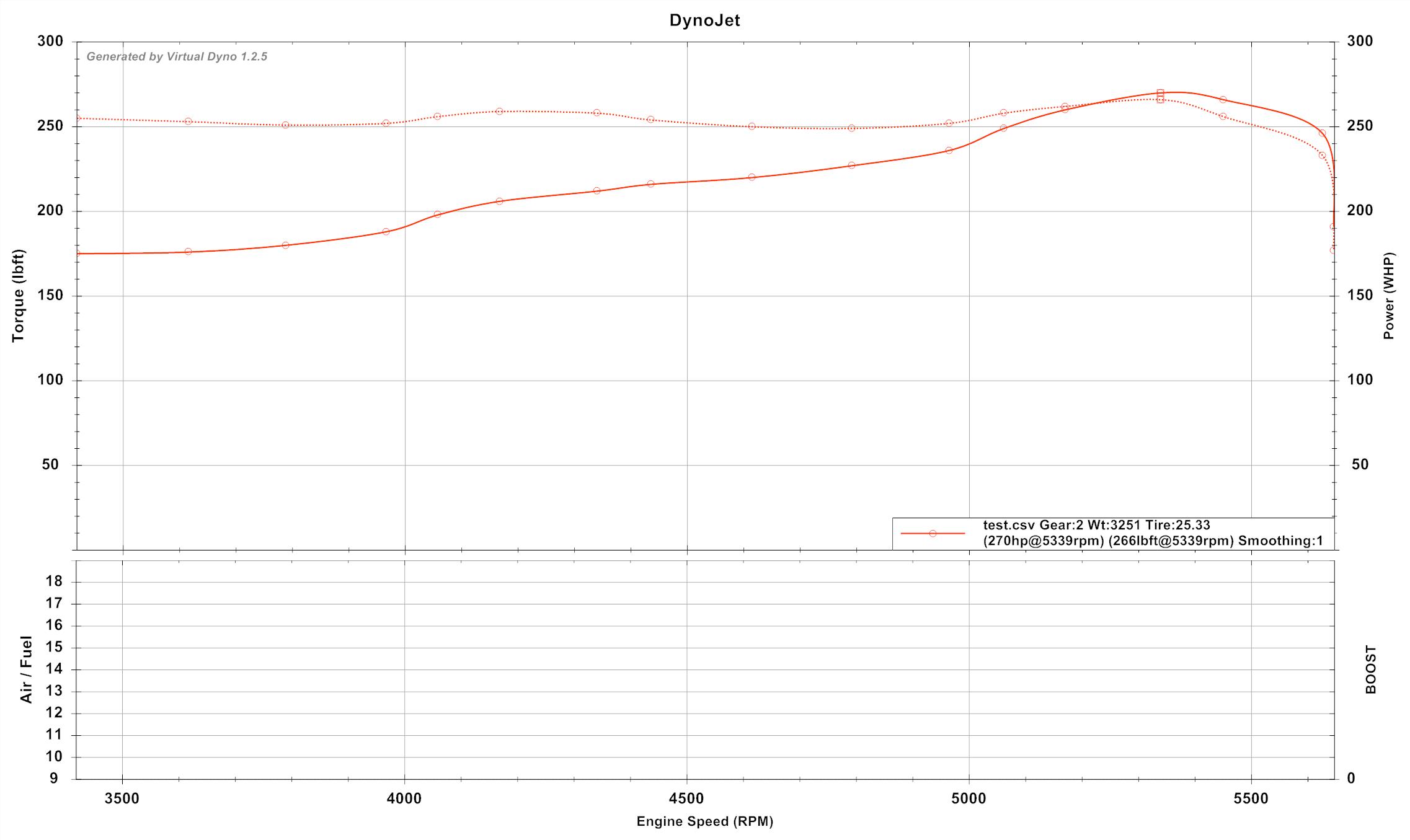

looks pretty cool and sort of works after a 10 minute play :D just need some logs done especially i dont have many power run style logs but ive cut one up in csv format and did get a power curve to display

here's a cut CSV from my dyno log and my dyno graph if someone wants to play, i setup a custom car but it came up with 270HP @ 5339rpm the run was in 2nd gear

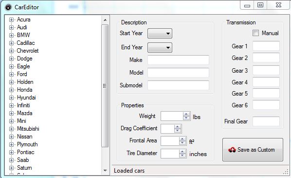

How do you get it to work? I tried loading your test run but nothing happens?
Posts: 4853
Re: Virtual Dyno
you need to setup a custom car which is the file i attached, once that's in your custom catagories in cars list then you can open a log, it will show up on the left then and you can select the custom car and fill in all the details and play with the graph. My tyres are 235/45/17

OK got it now. I made up a custom car for my car but the log I tried was too large. I need to cut out a portion of a tunerpro log and use that or just record a specific log. Thanks
