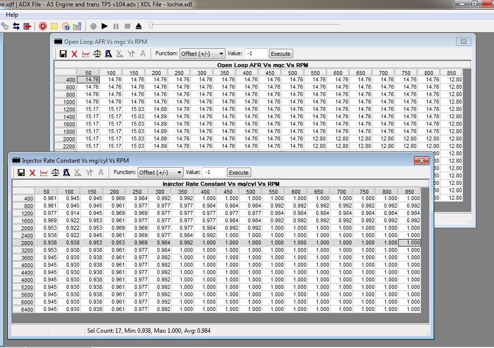

I was also wondering about this, im in the process of tuning a vt v6 auto aswell. I was told by another guy who does a lot of tuning I could do most fueling changes through the "Open loop AFR Vs mgc Vs RPM" table, where it finishes at 4,800rpm it will use that column right through to end rpm. Is this correct? ive also brought up this table for the injector rate which was the closest I could find to injector multiplier table, correct me if im wrong please, but will this table offer that adjustment? im still getting my head around these newer vehicles also :) .
thanks heaps
vt fuel.PNG (72.05 KiB) Viewed 4567 times

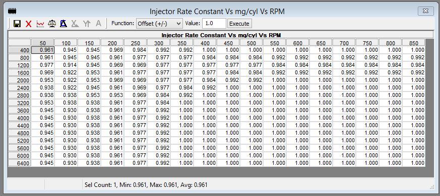

Thanks for your reply the1.
Is this the table you mean? If this is the correct table could you please explain how it works?

Posts: 4811
Re: Tuning - VT V6 Realtime Modded Factory Bin
injector mulitplier is 0-2, so higher will increase injector pulse width lower will lower it, it will affect all fueling states as it is a multiplier directly on the injector flow rate. Open loop is basicly for warmup so minimal use, the rest of the time your in closed loop
