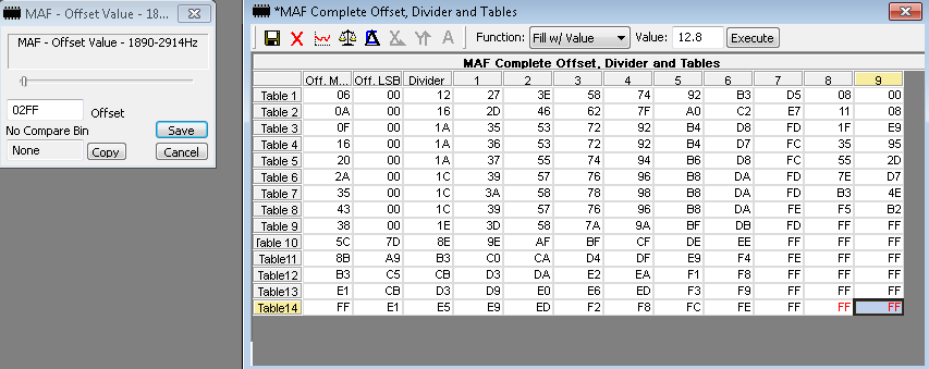

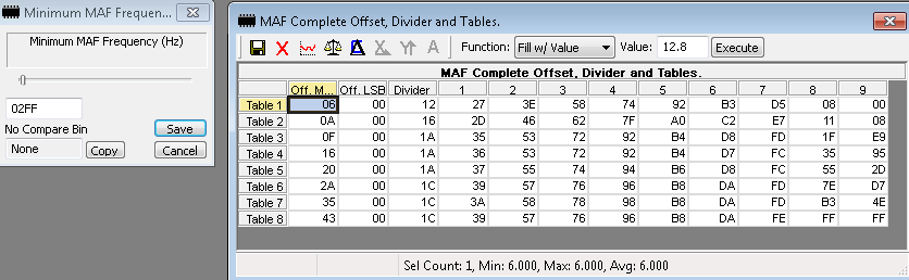

Just looking into the maf tables further, as I'm think if I multiply all of them by 2.5 it should bring it back to correct range...
But I noticed in the enhanced complete maf tabes it may be setup a bit different...
But with the corrected table as you can after table 9 the MSB, LSB & divider goes a bit wrong so again not sure if this is correct or not & obvioulsy added the FF in last 2 from where I moved the table to keep at at max reading high frequency???
- Posts: 9017
Re: LS7 card maf
something like that would be a good start. make sure you use the spreadsheet to do the calcs. You'll still probably need to take some logs on the car.

Don't think I did it correct as I broke it? it gets screwed up half way through?
I did 2.5 times the start point & then put 150 in for percentage difference of rest which should have brought it back to close?

- Posts: 9017
Re: LS7 card maf
Hmm not sure. It looks like the tables are going out of range but I dont know enough about the limits and how of that tables encoding.
Re: LS7 card maf
i can't see that working, starting freq of 4725hz it wouldn't even run as idle is in 2000hz range, you can't get much more out of the MAF tables as you hit the FF limit.
When i put one on my car i just had to adjust the base injector rate, think my N/A went to 515, which then gave enough room to tweak using inj multi table, you can't get around the fact that the Cylair is now displaced lower because the hz input is now lower. I just moved the spark table left about 2 columns then retuned from there, apart from spark and fuel i didn't encounter any other issues really.
