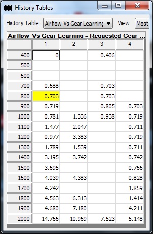

Seeing with MAF's you need to get the G/s rate correct for car's to idle correctly with major airflow change components I've been doing a bit of testing!
As you need to get the flow delta table right for primary correction I thought of making up a history table as it's laid out.
The only thing that i'm not 100% sure on if I choose VSS or roadspeed as the Column X(axis).
I tell it zero for P/n then just chose 15(first gear) 30(2nd gear) 45(3rd gear) 60(4th gear) & 75(5th gear-if applicable).
I then have the Row Y(axis) setup as the RPM in same format as gear delta table (17 lines from 400 to 2000).
But when looking at the data thats being set there it's a lot higher than in the delta table, so there must be other modifiers being brought into it?
If we knew what each of the modifiers to add in it would make for a perfect learnt airflow table & no stalling & re-jigging other scalars?
Another thing we would then need to know is when it's being logged as Idle Flow Control, or speed flow control.. is there a flag for this to know what it's in?
It does seem in the logged data from history table I made up the idle area G/s does line up 100% with initial value for learned airflow with A/con on or off settings!

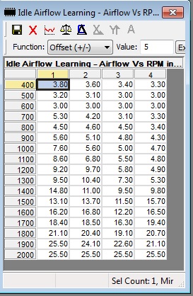

NO I'M NOT FIDDLING WITH THE MAF TABLES!!!!
It's the learned air flow delta for park/neutral, 1st gear, 2nd gear, 3rd gear, 4th gear (5th if applicable).
am I wording this wrong I'm not talking Hz I'm talking g/s in the flow delta table!

ah i see you meant the Idle Airflow Learning tables for each gear?
It's used to calculate a Airflow variable, the variable is used in Decel AFR Calculations, Throttle Follower Logic and IAC Error Control
To redo the table should be simple, make another history table just like the table itself, using rpm and current gear, then plot a log back of G/S from MAF.
- Posts: 2971
Re: MAF airflow learning control
Yeah but if you do that, you'll see the figures that get logged are nearly 3 times higher than what's in that table!
So there has to be other modifiers coming into play, would also be handy to know what the flag is to log when it's in moving idle flow control & stationary idle flow control!
- Posts: 4852
yes that's right as it's no longer stock, if you log a full stock setup it is pretty close!
