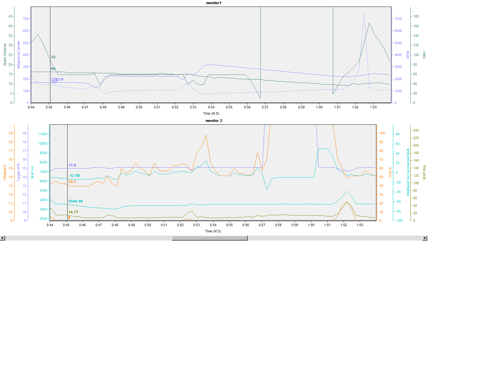

Here is a shot from the log. I have also attached a shot log if anyone wants to have a look Thanks for any help Peter.

Sounds Like you have it going in the right direction with the mods you have, good work so far & Yeah DFCO can be a bit difficult & time consuming, with the IAC try & get it to around 20 steps when at normal operating mode (obviously at idle closed throttle) & then work from there!
The TPS Throttle Gain % is your best friend there so it's at zero closed throttle & 100% when at open throttle! (a lot of changing back & fourth between test hence realtime----MASSIVE THANKS TO MODS HERE--- makes a big difference).

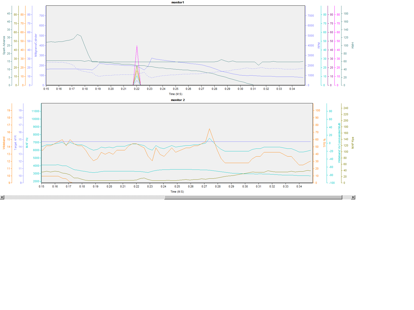

also i think this might be false knock but worth checking i guess, noticed this below at the 0.22 mark when making changes to different tables what is a good amount to make a change by, i guess different tables will require different amounts..
I tried to adjust the cranking fuel by 5% but it didn't make much of a difference.

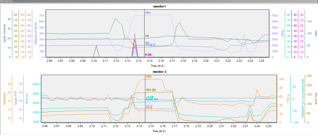

I do have one concern and that is the knock i got into days log, can someone have a look at this pic and let me know what you think I also need a bit of advice on the spark tables, my logs nearly always show less spark than in the spark tables even when i take into account the corrective spark for ECT Vs MGC and IAT Vs MGC.
Am i missing something here?

- Posts: 2959
Re: Manual L67 tuning advice/help
Sounds like you have it idling a lot better!
In regards to it commanding a lot less than hi oct table it could be IAT & ECT modifiers & there is well defined items in the adx to see where it's coming from!
It could be more than likely mainly running low oct with the counts your seeing for knock, but no one can remote tune that safely as you need to know if it's actual knock or noise that can be ignored & can tune to suit if it's just false noise!
Thanks VX L67,
If it is using the low spark table does the PCM work its way back to the high table and if so how does it do this?? time elapsed...
I guess that if its using the low table and the IAT & ECT's are close to the max they could be pulling 10 degrees also. I'm close to the max for the IAT as i dont have a cooler yet..
Had a look at the log and all the counts are at or below the 2500 rpm mark so whats the best way to look at this then add fuel or remove spark or do you need to do a combination of both ?

- Posts: 2959
Yeah if it's learnt knock it will learn if it's not seeing knock & go back to hi oct eventually if it stops seeing events!
But you need to make sure it's not ACTUAL knock events!
You really should re-read through all the guides, but if you want to change it from picking up knock events when it's not actually knocking you need to add ignore in that area where it is & reset PCM!
