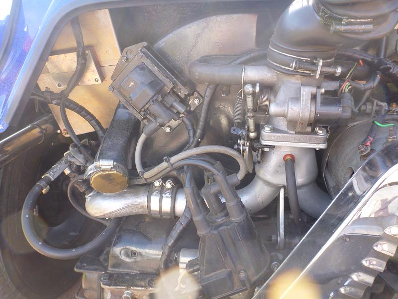

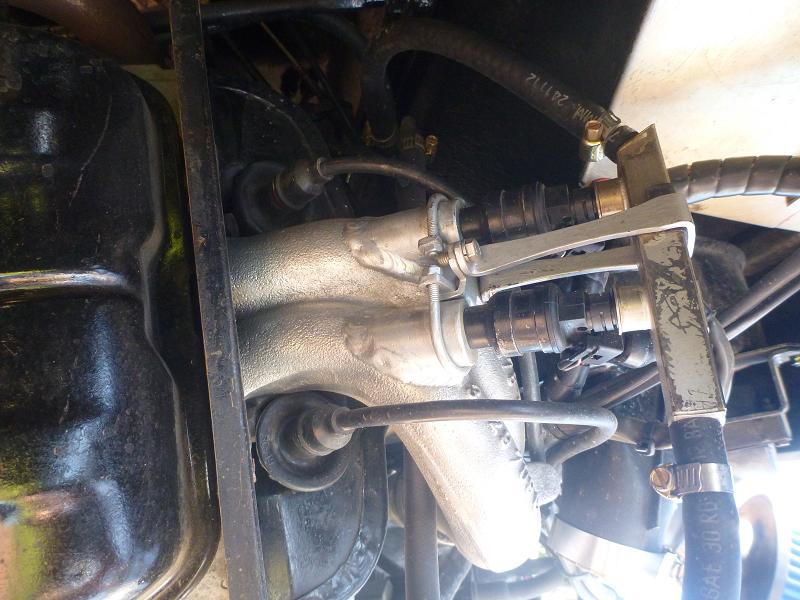

The owner made the intake, from the throttle body, to the existing lower cast runner attatchment point.

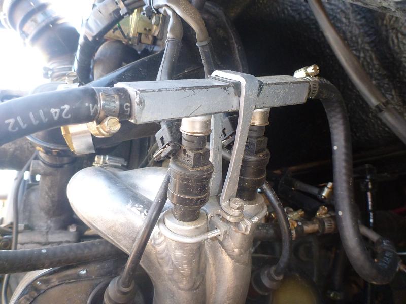

He also made the injector bungs, and had them welded to the existing runners. The Pulsar fuel rail was also cut and shut.
RH side fuel injectors. You may be able to see in the background the pressure regulator.

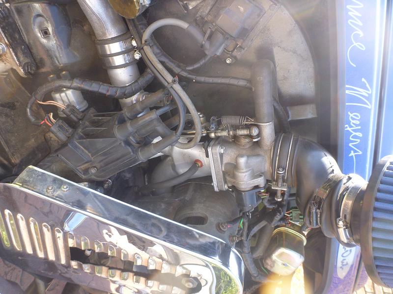

Another view of the intake. This shows the distributer the best, as I forgot to take a photo of it.
The Pulsar dizzy has had the outer lower housing lathed down to the same diameter as a VW dizzy. That's it.
The Pulsar (Astra/ Camira) dizzy has the same male interlock part as the VW dizzy at the bottom of the inner shaft.
Almost as if it's made for it.

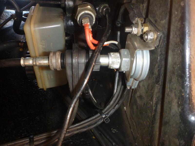

VSS source, placed inline with the speedo cable. Found this online from the UK, from a mob who has a kit to install Subaru engines into VW Beetles.

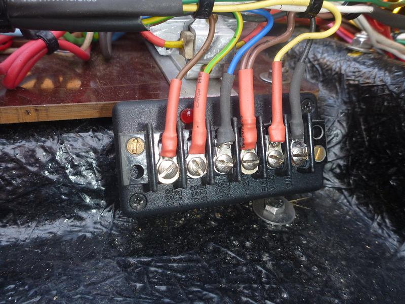

VSS converter box I made, to convert the +ve square wave speed pulse to "pull down" the VSS pin in the Delco ECU, as is required.

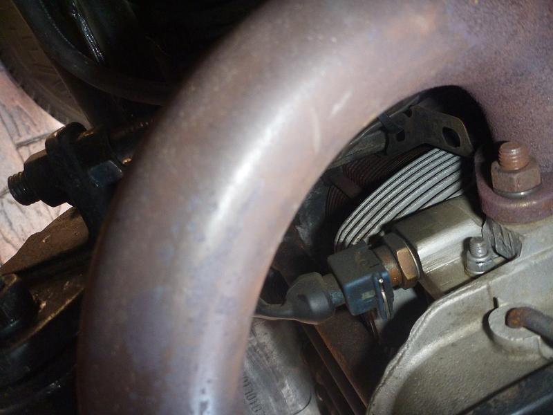

Temperature sensor. Screwed into a block of aluminium, which is bolted to the LH head.

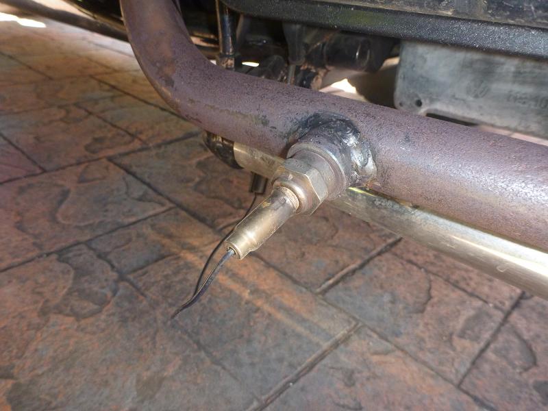

Oxygen sensor, in the pipe from the LH cylinder bank.

How did you do the labels on the plastic box?

They look like metal punch letters that have been heated ??
Love the conversion!! I am netted to know wat sort of numbers the coolant sensor sees on an air cooled motor!!
- Posts: 8114
Re: DELCOing a Meyers Manx Buggy (VW 1800)
type 1 heads usually around 120-150ºc from memory.

EJUCATED wrote :-
We have a Roland EGX-350 desktop engraver, for doing our labels at work.
It also is used to engrave single sided circuit boards.
Turned out OK I thought.
Rock Lob
I am an electrical technician in an open cut mine.How did you do the labels on the plastic box?
Rock Lob
