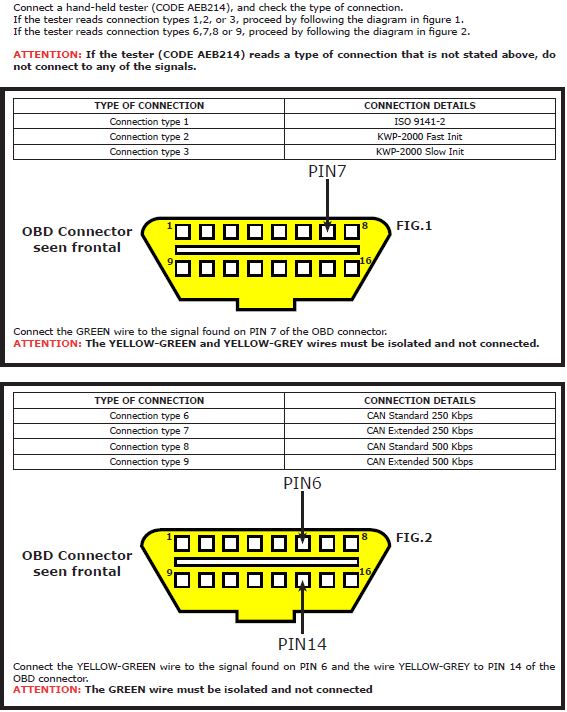

Re: 16 Pin OBD Pinouts
Picture isn't displaying on my end.
I'm interested in seeing the pins as well as I'm looking at a gas module with optional OBD connection. It's European so guessing it's not going to be applicable to a VS OBD.
