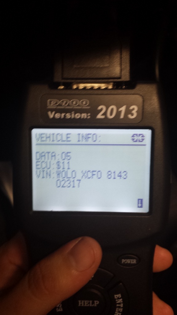

While using an OBD2 scan tool (to find out if my o2 sensor has had it, it has :thumbdown: )
i came across some readings under the ecu data headding.
It says:
OBD compatability: OBD1
$11
Im curious if that means the car is actually OBD1 not OBD2 as I originally thought and it has a Mask id of $11.
I know the Mask Id $11 is common with our holden commodores so is it possible there may already be an XDF out there compatable with my car?, and is it possible to have a car that is OBD1 with an OBD2 connector??

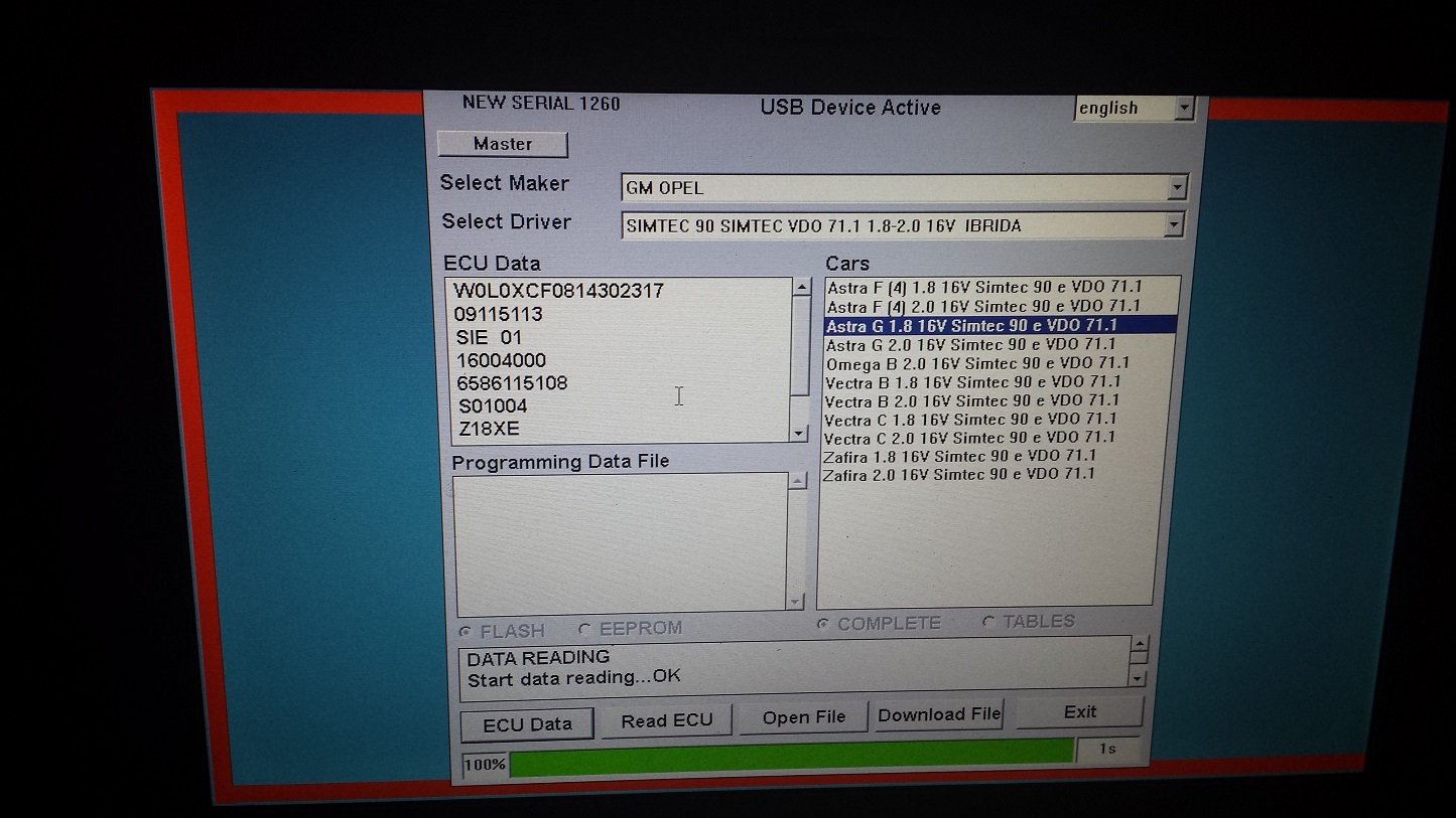

The car is a Holden XC barina SRI 2001 with the Z18XE engine which i believe is run by the Siemens Simtec 71 ecu GM part number 09115113. Also known as the Corsa C sri overseas and has the same running gear as the Astra G and H.
I have attached a picture of the ecu data pulled using the Galletto

Here is the file.
All signs point to the car being OBD2, although I originally thought the SRI came out with the simtec 70 and turns out the part number corrisponds to the simtec 71 which is why i was able to read the data on the ecu under the headding, Astra VDO 71, 71.1
Thank you in advance :)

So im thinking maybe my scan tool might be incorrect.
Is there any way to discover what the id would be? would it be written somewhere in the hex?

The readouts from the Scanner:
(apologies for attaching them, dont have access to intertnet other than work, cant host them on an external site)
