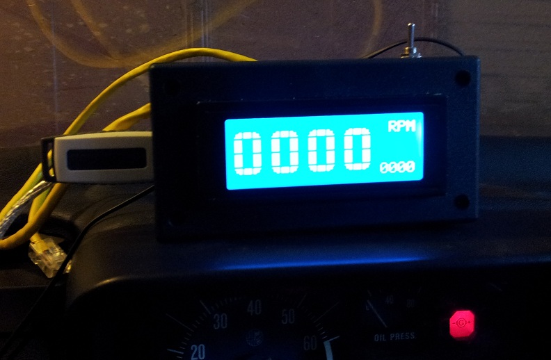

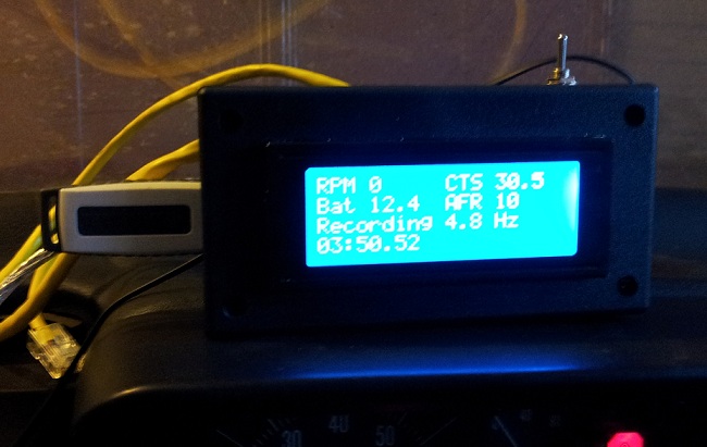

Like this?
[youtube]http://www.youtube.com/watch?v=x9GyRrYKxSk[/youtube]
[youtube]http://www.youtube.com/watch?v=iYu8XQRJmYE[/youtube]
http://pcmhacking.net/forums/viewtopic.php?f=13&t=2195
There's no reason why you couldn't use a graphic display in place of a character LCD like mine, the rpi has a very decent GPU.

Same idea yea, I have had the idea on the brain for a while and I saw those vids while digging around a few weeks back.
Only differece is I was thinking a much larger 7" or bigger screen wish simulated guages and some form of customisable image to overlay on the guage faces etc and to insert the whole screen into the dash where the cluster used to be. I was thinking of using smaller screens exactly like that mounted to the left of the cluster on the dash to display some of the parameters. I just think they look cool lol
