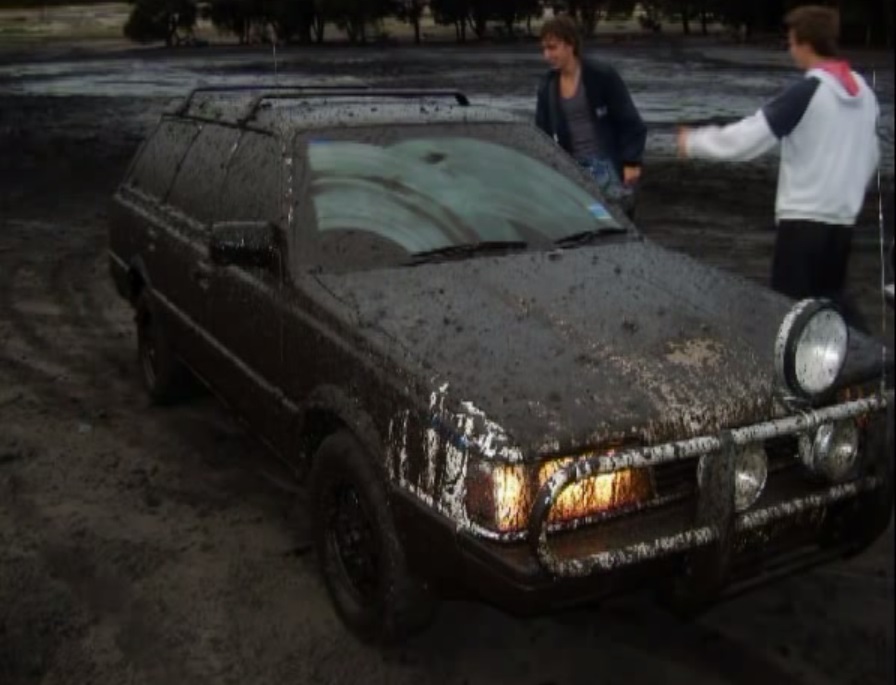

Howdy all, My firt post.
I have an 86 Subaru L series sedan was 4wd.
now has vs ecotech 3.8 and auto RWD :-)
Whats the best plan with the wires?
A Mate who is a pcm member (told me about this group) could help too but I want to get the project underway before I wast too much of his time.
it will be set up as push button start and minimal wires ( no road car)
Thanks for reading my post
Mick.
