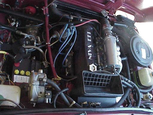

Re: old dog -- new tricks
I did the exact same conversion some years back and although you'll never make a Niva a quick car it made an enormous difference to the driveability.
I was lucky enough to find a genuine Niva PFI manifold that was used here in Australia at a time when I believe Peter Brock was running the distribution.
They originally came with an early Wolf system but I trashed that and used an '808, Camira harness, V8 ignition module, Nissan Pulsar throttle body and a late model Niva dissy that had the hall effect pickup.
A really simple conversion.
- lad niva toro engine1.jpg (46.04 KiB) Viewed 6521 times
