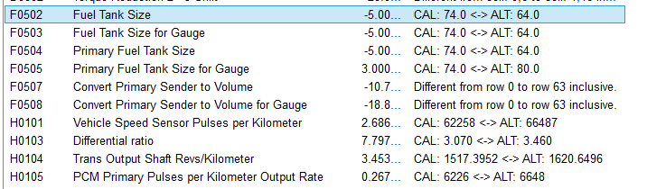

Surely there is a way to work out what data should be in the appropriate table the drives the fuel gauge, am i on the right track?
Re: Crewman fuel guage tuning help...
quick diff in efilive between VZ Crewman and Sedan.... fuel tank settings different... I would definitely start there.

Thanks jayme,
Just as i thought, how can i work out what to input in the table to make the guage right?

better yet.... ihere are the bins.... you should be able to open them in hptuners.

Thanks Jayme for that file, that sorted it no problem, cheers.
