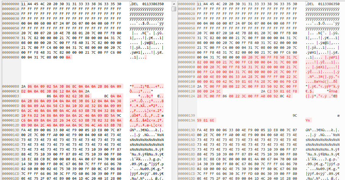

Attached all 3 types of software. As you can see, in last part of them are some changes. Those are maps
Opel Astra 1.7 DTI Ori.zip
In first 32K of flash there are differences just in one case, others are the same:
Found those lines at 0xFFFE (there i have fdb SCISS that is reset vector i think. All other lines are the same like on your example).
Reset vector definition is found at 0x217C
