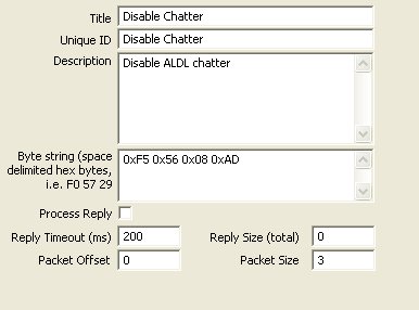

F1 packets fixed. Holden202, try adding this command to your ADX. Add it to the startup macro after listen for silence to send device 0xF5 (the pcm) a mode 0x08 disable chatter command:
In a car with a BCM you might need to send it one too. Not sure? (0xF1 0x56 0x08 0xB1)
