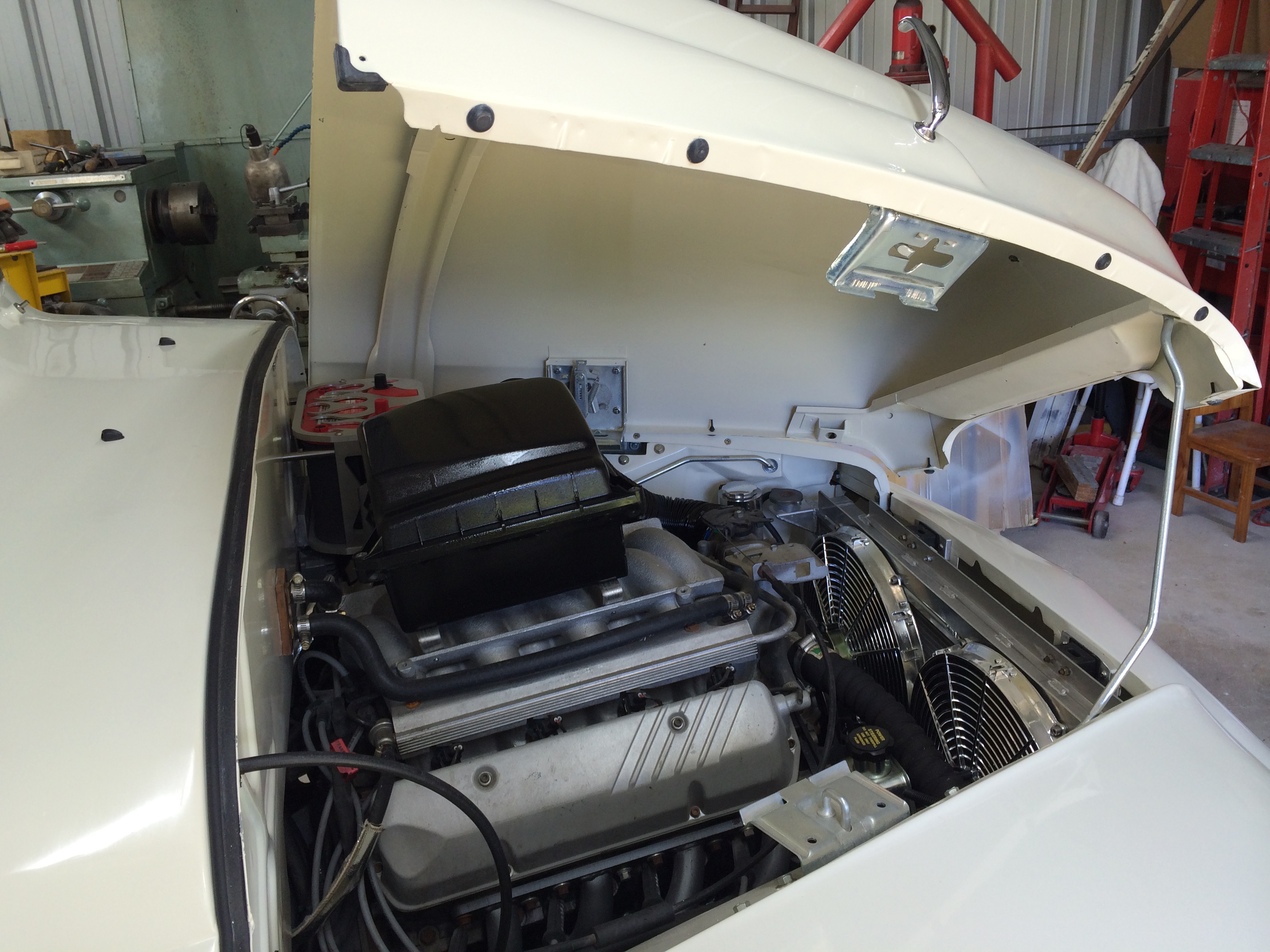

that looks mint mate always loved the inter and dodge utes what lives underneath though?

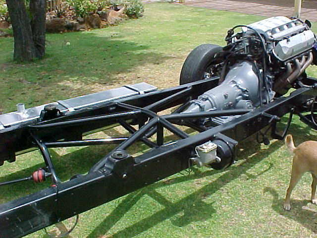

Thanks Dazza, I am running a stroked VS 5 litre with a 4L60e tranny, electric one piece windows, Dakota Digital gauges, Flaming River Steering column, Grant Steering wheel, shaved door handles, XJ6 Jag front and rear suspension, Gemini booster and XB Falcon M/C. I have had to make a heap of custom bits because of my running gear choices plus you can't buy anything off the shelf for these old girls - the only thing I haven't done myself is the upholstery which was done by Bruce Swarbrick in Mundaring.

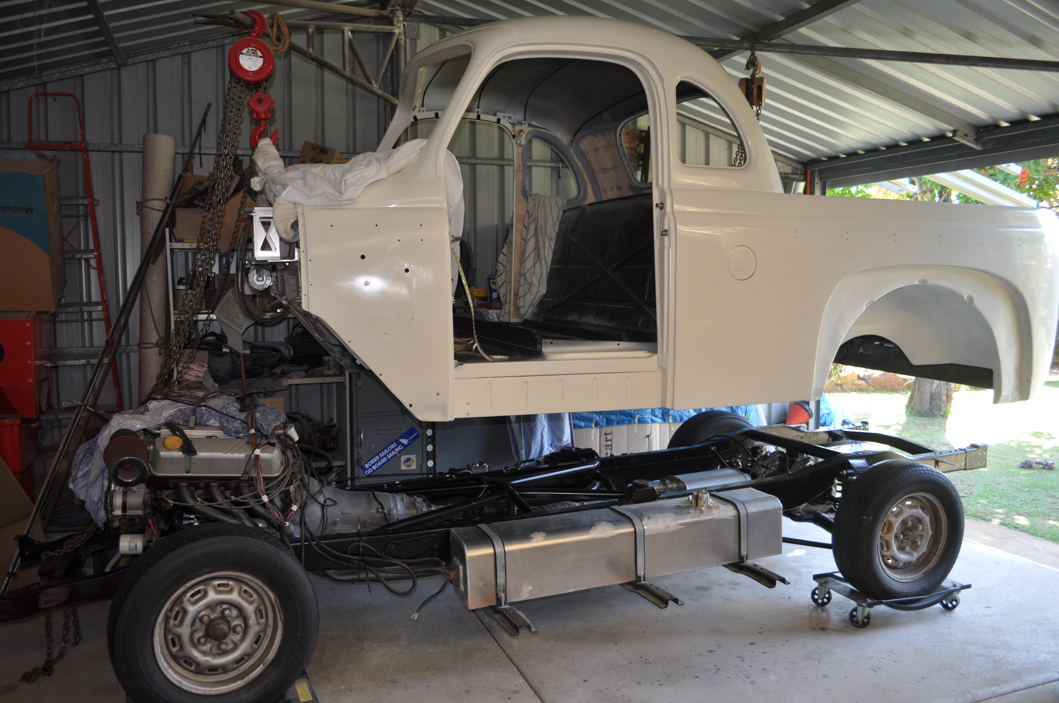

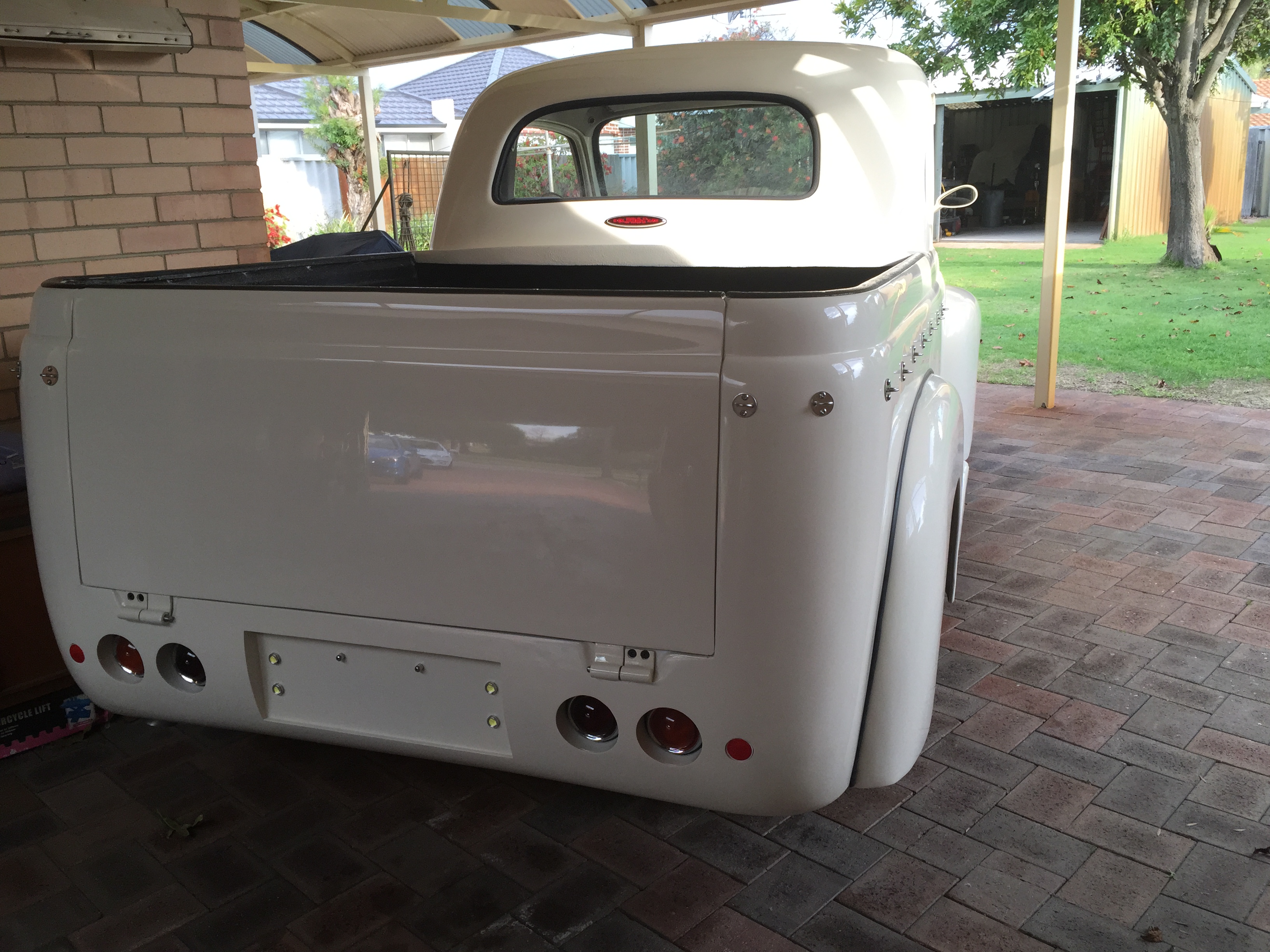

Some more pics

Nice truck.
Re: My Ar 110 International Ute
I looked through this thread on another forum a while back, top work :)
Same, went through the aussiev8 build thread. Amazing work grahamjb :thumbup:

Great job mate, how big is that fuel tank ! I'd hate to be paying to fill that up

HQ355, I haven't filled the tank yet and am yet to find out what its capacity is, however I calculated it to hold 72.43 litres when I built it.

It looks bigger in the photo, my HQ tank is 85ish litres, that will hurt a little lol
