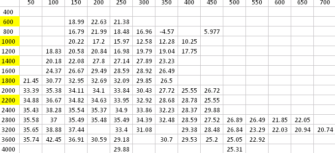

Hey All,
Has anyone got a base starting point for an intercooled 10Psi V8 with a banana manifold?
Just been trying to get a base map sorted for the above mentioned vehicle but it feels a bit doughy down the bottom end compared to how it pulls up the top so wondering how far I can push the timing map on a stock VT V8 engine with the stock banana manifold?
Cheers VX L67 Getrag
Posts: 2959
Re: VT V8 10Psi Cooled spark timing
Post by VX L67 Getrag »
Just as a guide this is the timing I'm hitting from the log, 22deg's in the deep end seems like too much but honestly there's no detonation at all!
vt 5Litre 10Psi Turbo cooled.PNG (22.9 KiB) Viewed 1861 times
