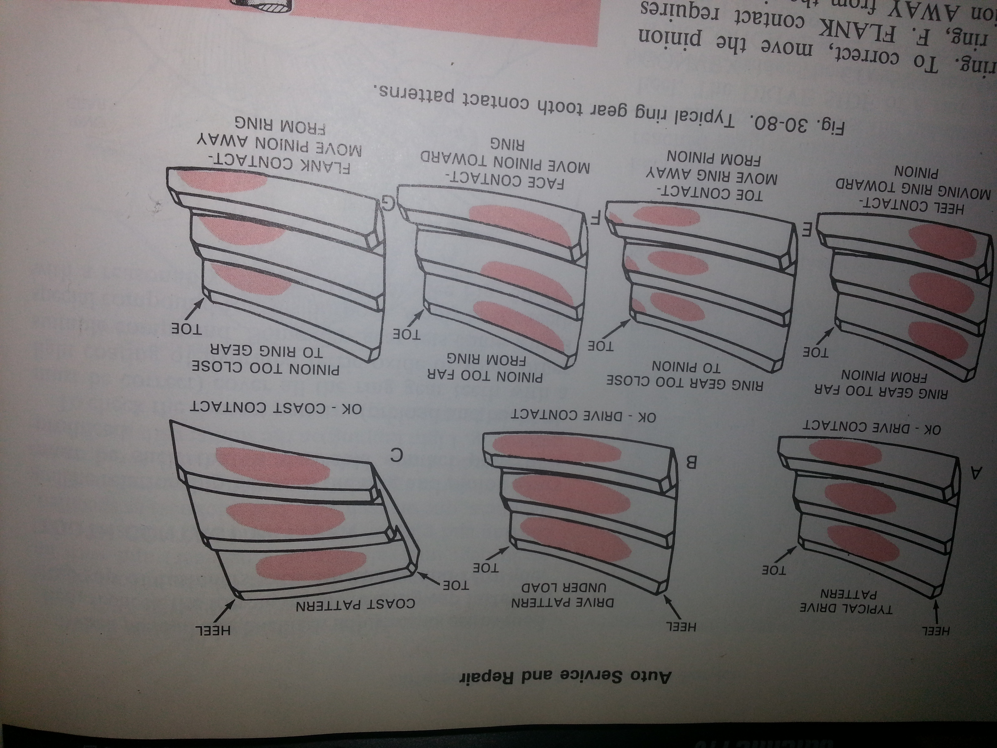

Re: BW78 diff gear backlash
beg to differ, the backlash can be affected by both. Personaly in a high horsepower application I would remove the crush tube and make an appropriate spacer with provission for adjutment shims , set it up with the crush tube then remove it and make a solid spacer to suit by measuring the crush tube . the reason for this is with high hp you can actually crush the spacer more while in use,and also you can actually change your pinion seal without upsetting your gear set.
What you need to do is juggle the input shaft depth VS the crown wheel shims to acheive the correct contact pattern which you see by applying bearing blue to the pinion gear and seeing what pattern it leaves on the crown wheel
