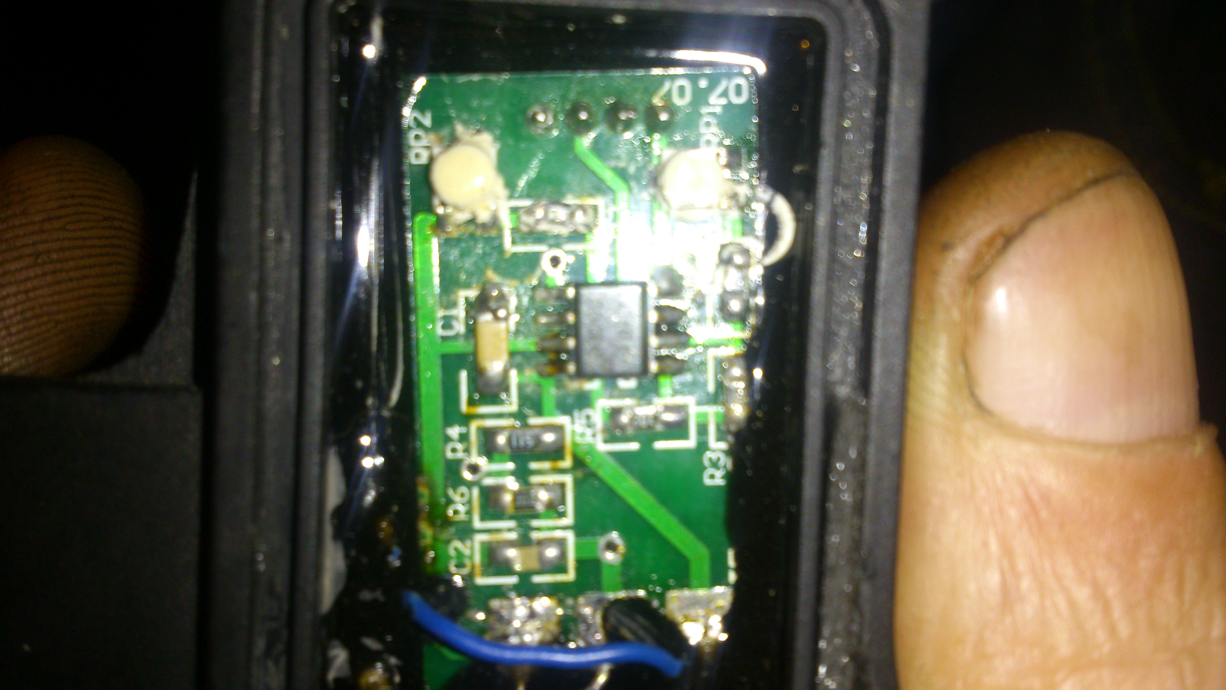

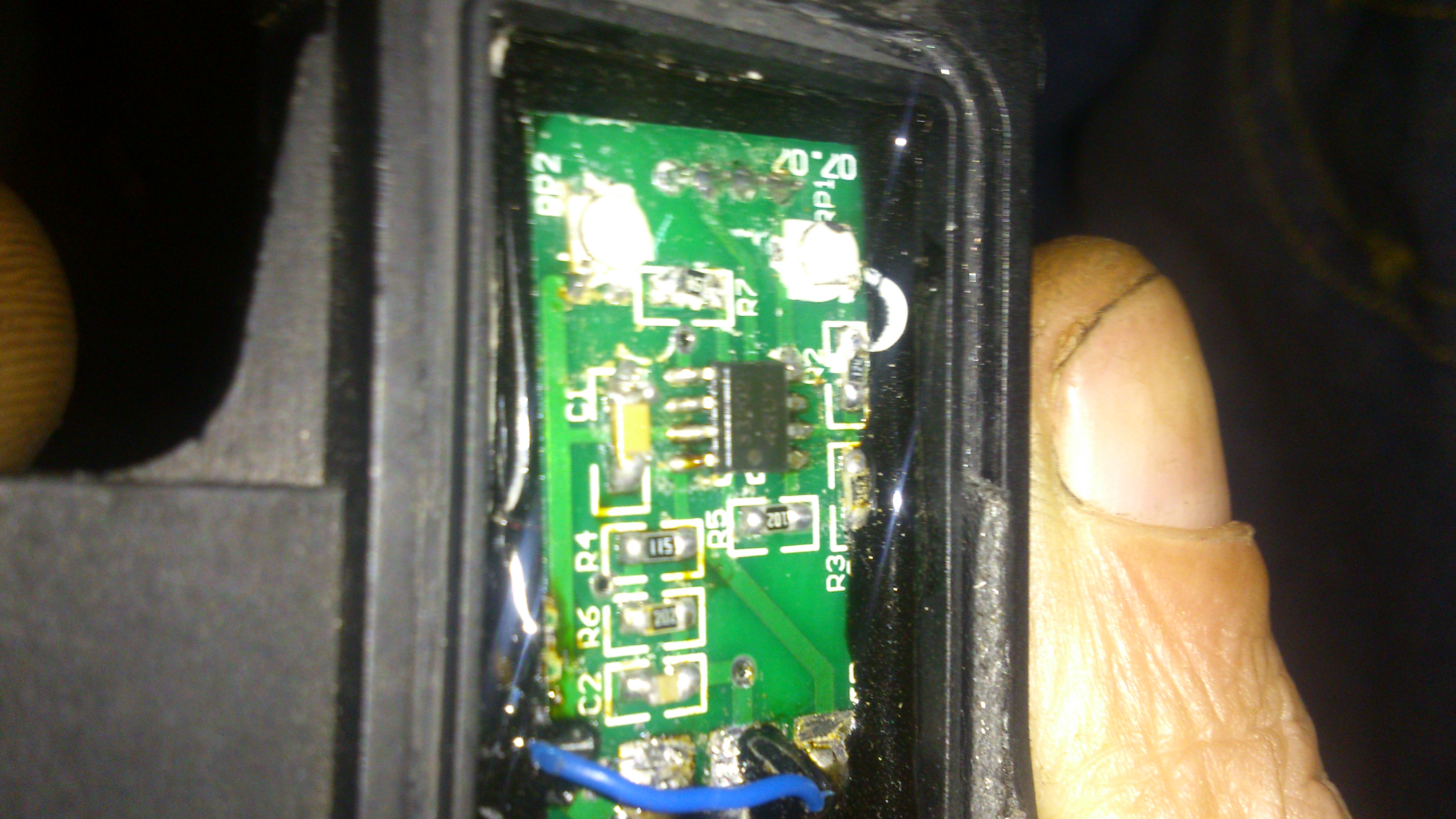

so i thought it time to see what was inside my old dead 2 bar chinese map sensor hahahahaha not much really compared to the 1 bar gm deal beside it im starting to think the 202T's 3 bar maps farked its also chinese testing mith multimeter and gently wiggling the plug makes the output cut in and out

What's the number on that IC? And if you're not planning on using it again, any chance of a pic showing the other side of the PCB and the sensor?
I was planning on plotting the pressure/voltage curve of mine (when it gets here) to see if it's anything like a real GM one, but I'm guessing it's pretty dodgy from the look of those trimpots.

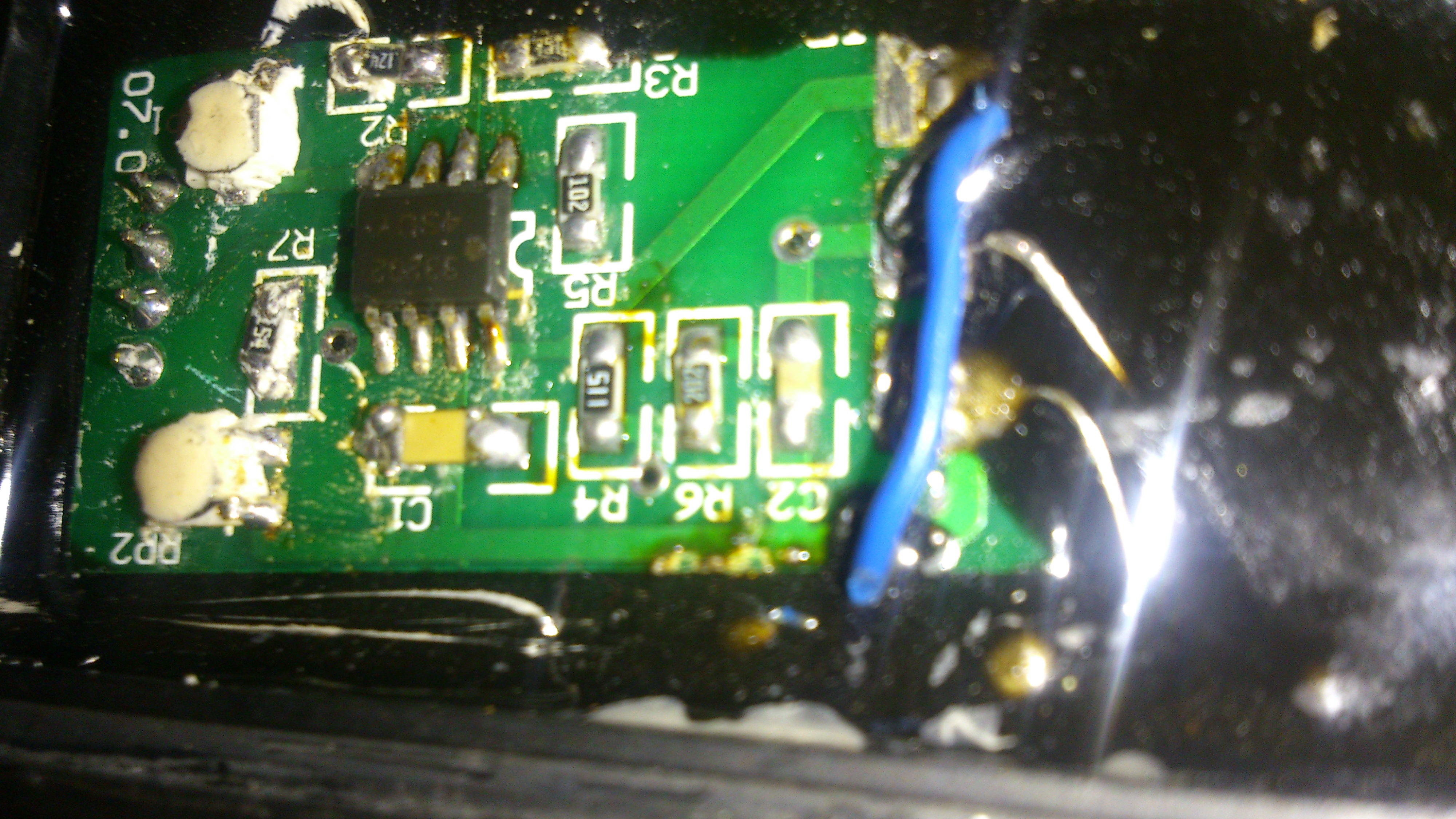

stock has air vents in from atmosphere this didnt so as it heated it would read out with the sealed case LOL.its potted in hard black plastic crap stock is in soft jelly .the china deal i just fixed the potting must of expanded and snapped one of the hard link wires from the plug to the board must of heated till the potting expanded and just snapped the wire was able to touch the 2 peices together and make it work bit of solder and shes probably back to usable it has done a good 30000km allready ill have a play LOL.
chip reads 33202
4suy
chip reads 33202
4suy

copy of this ic http://www.jameco.com/Jameco/Products/P ... 4-DS24.pdf
- Posts: 5627
Re: chinese 2 bar meats screwdriver look whats in there
few close ups probably enough for you to draw the circuit dunno whats under it theres 3 through holes but they might not go anywhere

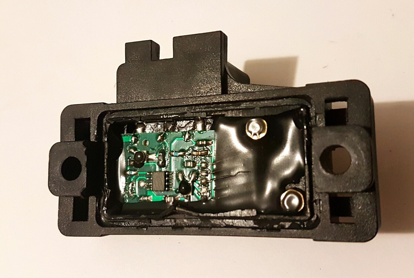

And here is another one. Same issue as Holden202T had, MAP was not stable with temperature. Makes tuning slightly difficult when idle AFRs are varying from spot on target of 14 to 18 by just heating the sensor
This was from a reputable shop in the US, sold as a genuine 2 bar Delphi MAP sensor. Somehow I doubt this, even the IC has had its markings ground off! I bought it a number of years ago for another car so no returning it now.
Anyone got a local supplier selling quality sensors?
