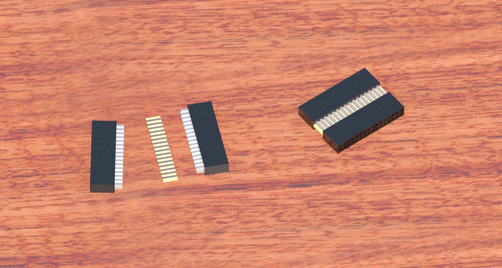

I have my series 1 VT SS l67 running very happily on an ostrich right now.
I made a very simple adapter out of 2 40 pin header sockets (which I trimmed down to 32 pins with a hacksaw) and some prototype (strip style) PCB.
I cut a strip of prototype pcb to fit lengthways between the pins of each connector (so the tips of the pins from one connector are just touching the pins from the other) for a bit of extra strength, and then i soldered all the pins from one connector to the other. The socket on the ostrich is a 34 pin and so therefore you must offset the adapter 2 pins from the end.

The hardware you have is effectively the same set up I'm using, 32 pin cable from Moates and an adapted memcal with PROM removed and machined pin socket soldered in.
I'm interested in finding out how you are loading the bin into the ostrich?
I've been working with others and the only way we could get it to work successfully was stacking the bins.
What software are you using, TunerPro?
What software settings are you using?
What settings have you got the ostrich set to?
What size bin are you loading , 128k or 512k (4x128k stacked bins)?

Initially I used EmUtility until I found out that there was an extra toolbar in tunerpro that was turned off (bank selection).
I am using the Ostrich set to 32 pin / 4Mbit, and yes I have been just using a stacked 128k * 4 bin.
I am planning on disconnecting A17 & A18 from the bus and putting pull-up resistors onto them so that I can just upload the 1 bin.
...and maybe add some switches too, so as to switch between the 4 bins if I stack them.
I believe you can set EmUtility to upload the bin to wherever you like in the ostrich's memory, so that could possibly be another way to avoid having to use stacked bins.
