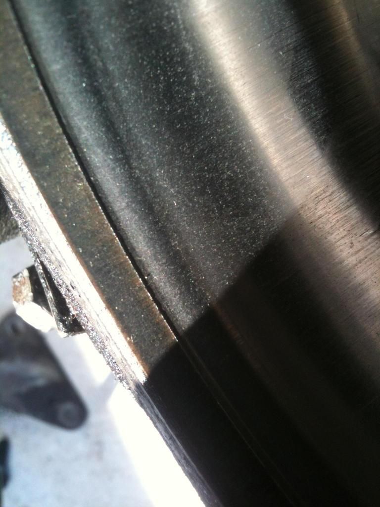

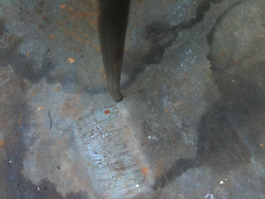

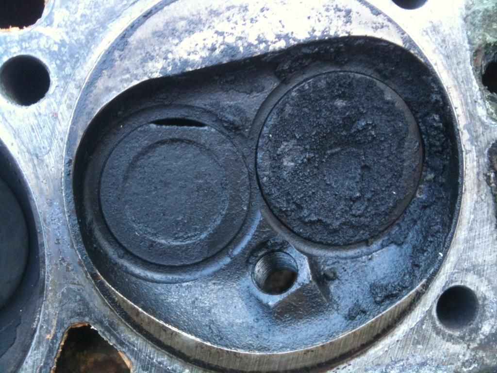

Re: How much vacuum at idle
every holden v8 I took apart were clean but heavily worn. bearings, cam and lifters, bores too. 308 and 253 were the worst of the ones but plenty of 304s with what id class as low Ks. Most I have come across were done by 200k.
Been disappointed in them longevity/reliability wise. Maybe I been spoiled with the V6s being tough engines lol
here is a 304 with 304k lol. I have never ever seen V6 develop a bore lip even with 500k. In all my engines I pull the piston out the top with no hesitation.
