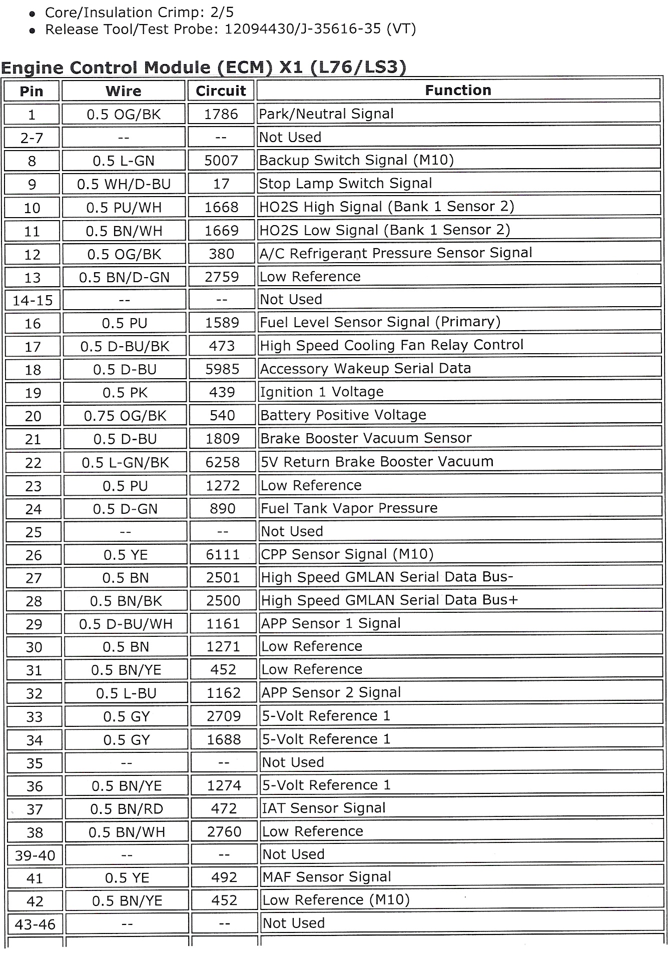

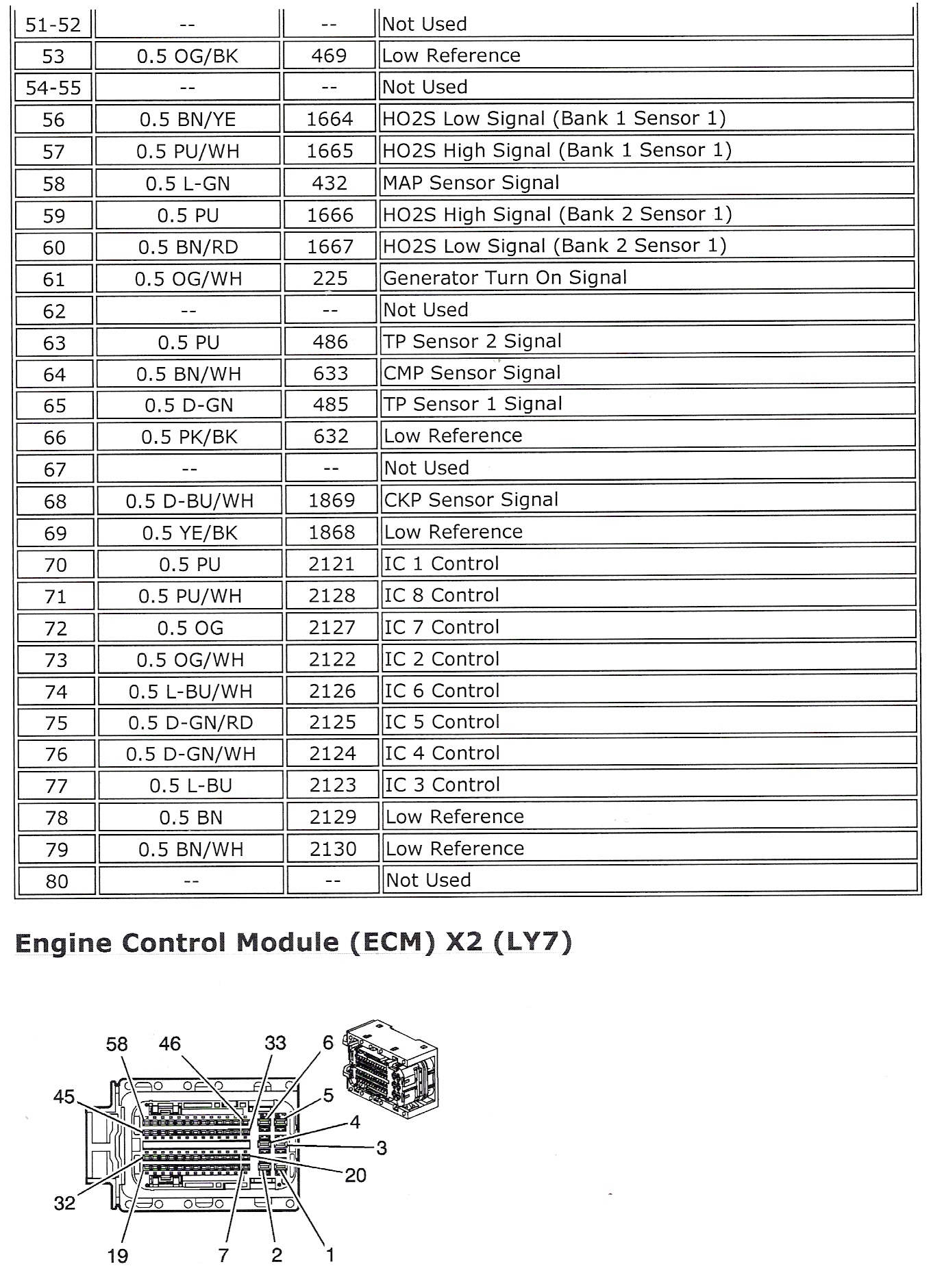

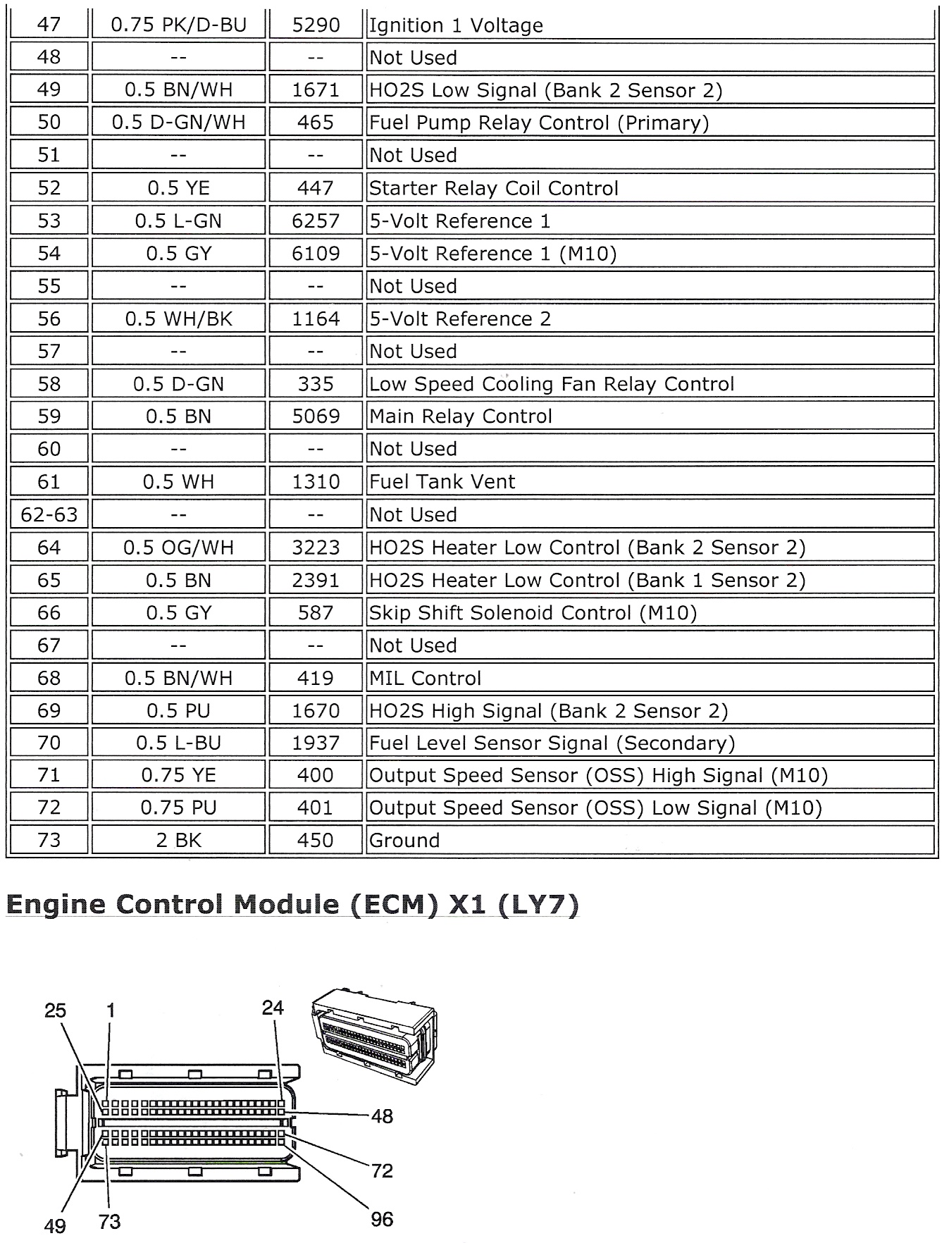

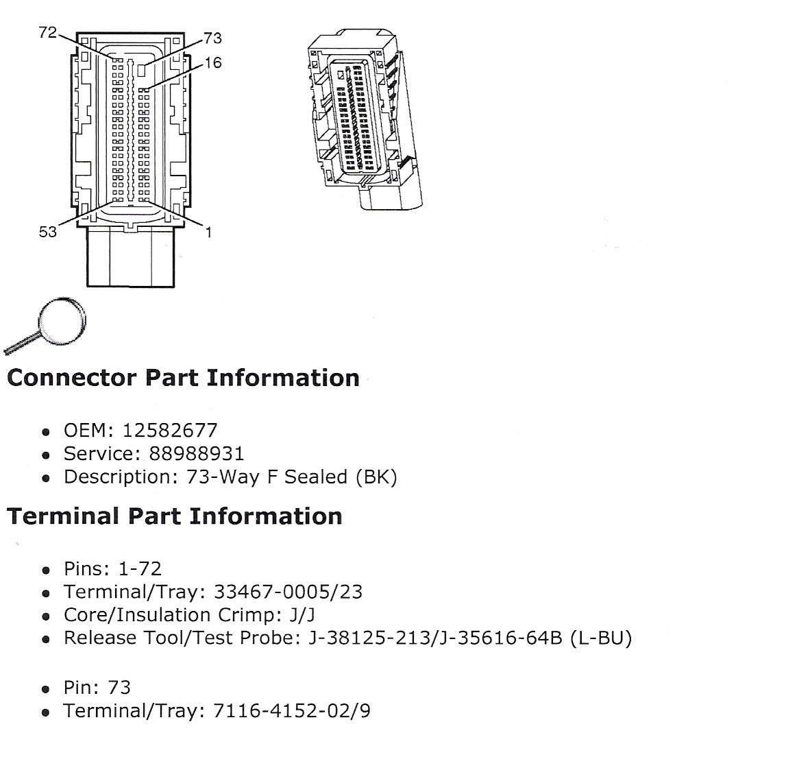

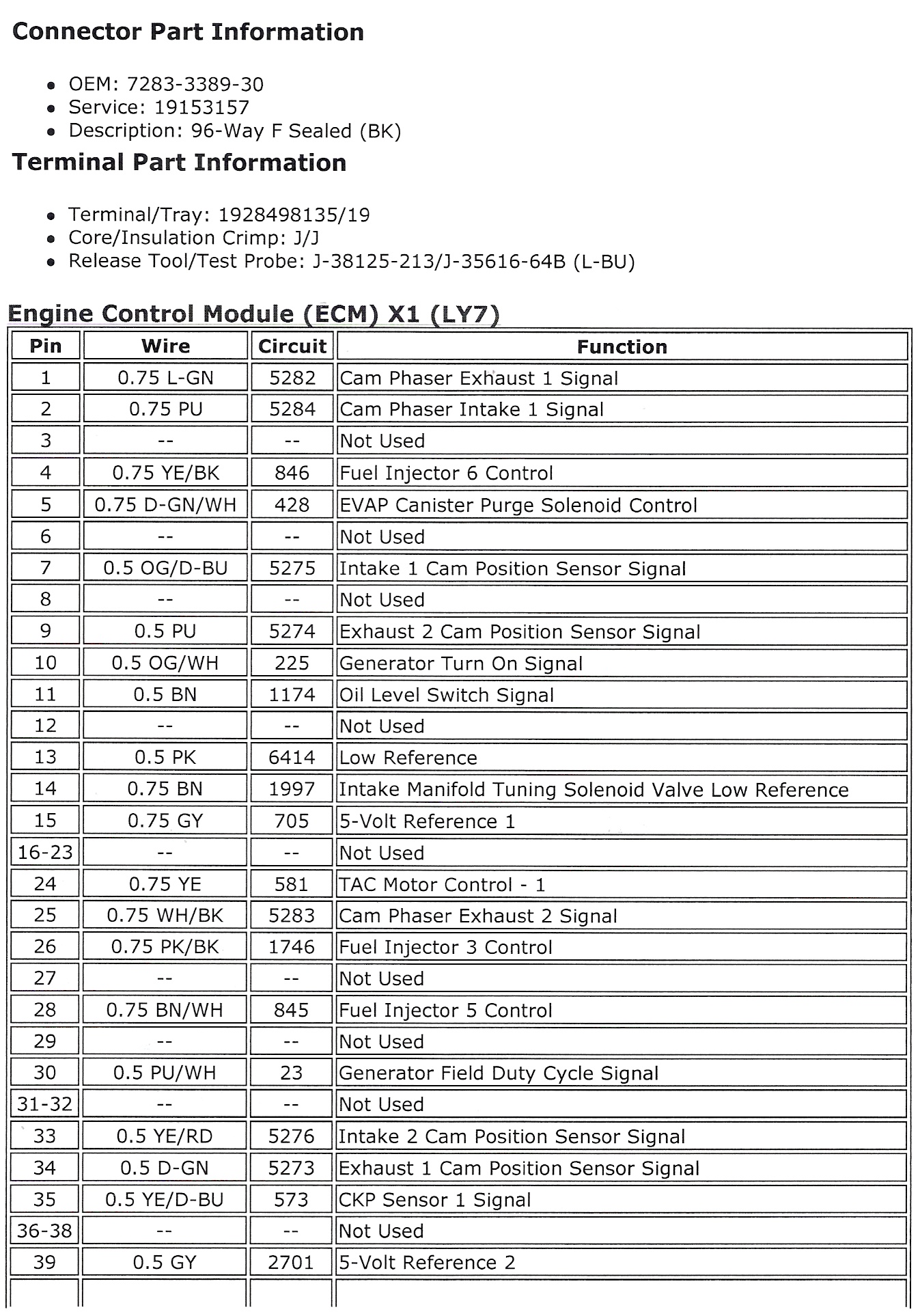

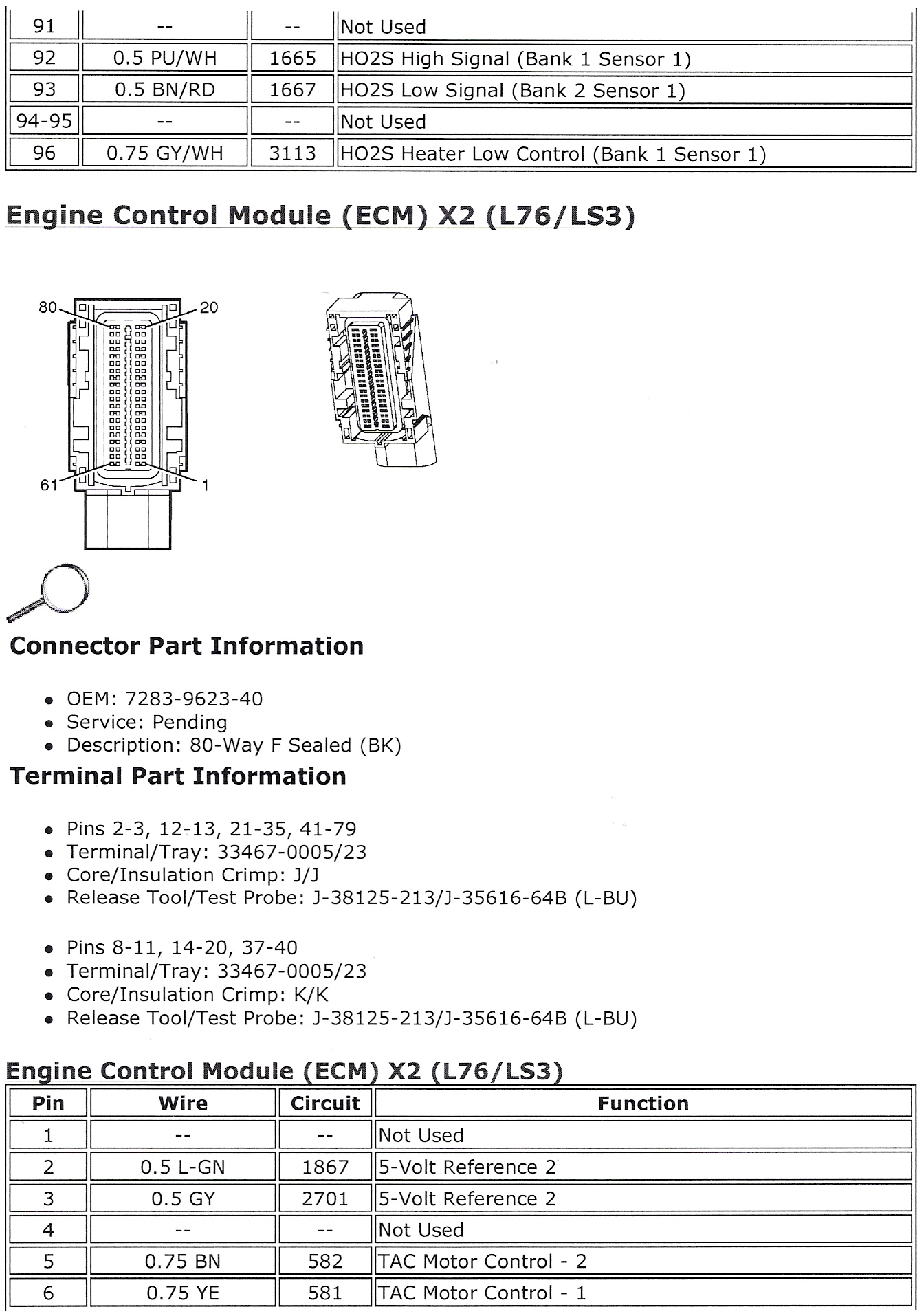

And here it is as a list... With thanks to DaMaine1 from http://g8board.com
- VZ L76 01.jpg (165.69 KiB) Viewed 42534 times
- VZ L76 02.jpg (854.41 KiB) Viewed 42534 times
- VZ L76 03.jpg (644.5 KiB) Viewed 42534 times
- VZ L76 04.jpg (736.31 KiB) Viewed 42534 times
- VZ L76 05.jpg (806.11 KiB) Viewed 42534 times
- VZ L76 06.jpg (488.6 KiB) Viewed 42534 times
- VZ L76 07.jpg (883.99 KiB) Viewed 42534 times
- VZ L76 08.jpg (673.3 KiB) Viewed 42534 times
- VZ L76 09.jpg (645.72 KiB) Viewed 42534 times
- VZ L76 10.jpg (740.39 KiB) Viewed 42534 times
Re: VZ V8 wiring....
Thanks Jayme and Antus for the help! there ends a long and painful search for the wiring for the L76, it seems all the diagrams out there are for the US version as the colours are different, also if its advertised as a complete swap guide for LS series....it isnt! Jayme your wiring diagram is the same as my loom.Antus, i think that the diagram you posted is the US version Thanks again guys for the help!
