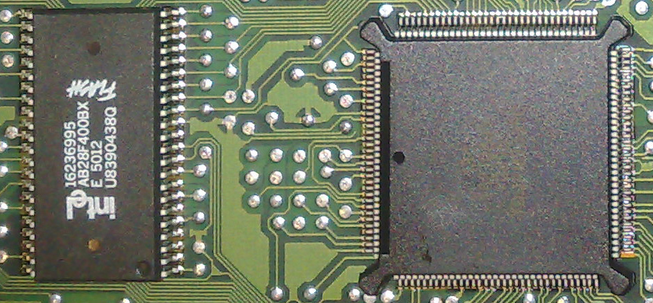

Well I took apart 1 Pcm I had here, The Flash chip said
INTEL
16236995
AB28f400BX
U8390438Q
So I assume it is an Intel 28F400BX based Flash Chip?
When I read that it is "motorola 68330 32bit code" that means that Chip is coded with a Code Style named motorola 68330 32bit ?
Sorry, a newb when it comes to this but am learning.
INTEL
16236995
AB28f400BX
U8390438Q
- Posts: 10111
Re: Question for the Gurus
yep, thats all correct...
sample of the code:
sample of the code:
ROM:0001B834 loc_1B834:
ROM:0001B834 tst.b ($FFFF9EB1).w
ROM:0001B838 beq.s loc_1B848
ROM:0001B83A btst #1,($FFFF9AE4).w
ROM:0001B840 beq.s loc_1B848
ROM:0001B842 jsr sub_1BDB4
ROM:0001B848
ROM:0001B848 loc_1B848:
ROM:0001B848 move.w ($FFFF9B42).w,($FFFF9B44).w
ROM:0001B84E move.w ($FFFF9B34).w,($FFFF9B42).w
ROM:0001B854 rts

Well I opened up 2 Pcms last night
This is what I found
Flash Chips
2001 Impala 3400
1999 Chev Venture 3400
Not sure of the differences between the Two besides last to lines, but def same family (maybe build code dates etc?)
It seems MANY MANY GM Pcms use this chip (even back to 96 4.3l in trucks I have seen)
Searching for Data on this chip, I come up to referrences to
AB28F400BX with a T90 or B90 at the end? not sure what that would be?
Also have found
http://pdf1.alldatasheet.com/datasheet- ... X-B90.html
which seems to reference both B and T
Here is the image of the 99 Venture
(edited to make image a reasonable size lol)
Flash Chips
2001 Impala 3400
Intel
16236995
AB28F400BX
E5012
U8390438QCode: Select all
Intel
16236995
AB28F400BX
H3311
U0490294YIt seems MANY MANY GM Pcms use this chip (even back to 96 4.3l in trucks I have seen)
Also have found
