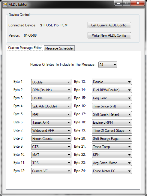

Yeah it sure is the way to get some good data, 11P and 12P have this feature and is pretty much all I ever use for logging (24 bytes is still over 20Hz). The flashtool has the configuration tool, allows 1-24 items to be defined in the message so you can sort of choose the speed you want. The most time consuming part is just working out the RAM address location and function.
I have been talking to The1 about adding this for the enhanced bins so hopefully should see that all added soon :thumbup:

Good to here you can accommodate for different bins. When you say "1-24 items to be defined" can any known item be one of the 24? I have got used to locating RAM addresses by just typing FF FF in the hex file, a small group of FF FF and your usually in the middle of it.

Config tool looks like this ...
11P_M11_V106 Trans.png (51.53 KiB) Viewed 5217 times
You just choose the number of bytes you want in the message and choose your items from the drops down lists. Click write and make the ADX to suit your new message.
The items to choose from are defined in the flashtool, so if you have a list of known RAM address' for various bins I can add them.
