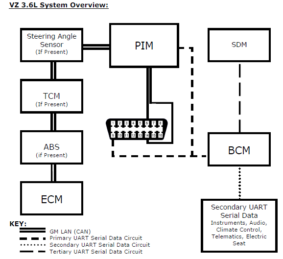

Now trying to get a hold of a vz dash harness etc that came out with an e38 would be the easy way to go, albeit expensive due to the low number of 6lt vz's actually made/wrecked. I reckon I could come up with something like below.
Base car = vu ss ute, remove ls1 harness
convert vz e38/t42 engine harness to suit t43
build new harness that plugs into the old vu body harness on drivers side of engine bay (pinouts are easily available for these) to/from.
using a vz v6 pim it should be able to convert the CAN data to the old ALDL network (Primary UART) to bcm, which leaves the 2ndary and tertiary for the dash cluster, abs module etc Anyone done anything similar? my main area of concern is really just the data conversion from CAN to UART. I figure holden had to dumb things down enough to keep the old dash clusters working with out spending a whole lot of coin. I also think I might have better luck with a vy based model, but changing out from vu to vy dash loom isn't hard to do either.

If using E38, Id say stick with VZ parts.
It should all work, from the testing Iv done with the cluster, BCM, PIM and ECU on bench, you should be all sweet!
I think the PIM can be reconfigured if memory serves me correctly.. I recall seeing the option. Should be able to turn a VZ V6 pim to a V8 configuration.
All the PIM is doing, is grabbing the data that is sent from the ECU, reformatting it and injecting into the ALDL bus. This keeps the cluster happy and displaying the correct info.
The pic above shows everything feeding into the BCM.. although Im not so certain thats what happens? I know its the ALDL "Bus master", but all modules communicate freely even if the BCM is unplugged, they are all hooked up to the same ALDL wire and not just fed into the BCM module from what I understand.

I dont think the 6L dash is any different to the 5.7, as you say the pim does the translation. if its not the right config (airbags etc) you might need to calibrate the dash, tazzi would know more about your options here.

Tazzi wrote:If using E38, Id say stick with VZ parts.
Keen to see how this gets on!
yeah you are right with the bcm aldl wiring. it;'s just 1 wire that goes to a couple of different devices.
I've wired up 2 drag cars now with a vy bcm/pim and cluster. it's all pretty simple which is why I reakon it's do-able.
I'm away this week so when I get back to perth this weekend plan is to try and pickup a vz shell with all the dash wiring and shit still intact and go from there.
what would be really nice would be to have the tapshift steering wheel and see if that could control the tapshift on the 6l80 too
