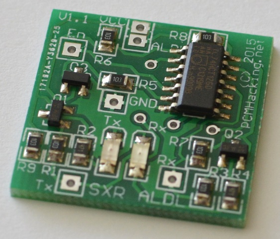

there are a few ways of doing what you want, but the easiest for you may be to use VL400's SXR board design, to replace your current USB comms board. the SXR board essentially turns the 808 into a VR manual ECM, so you can wire that interface at the web page you linked, up to the 8192 baud data pin on the 808 - pin A8 (which is now active as a result of the SXR board)
I have a few of these in stock. pictured here:

Thanks guys, exactly what I needed to know.
How much are them boards Jayme?

I haven't created a for sale ad for them yet, but cost is $70 + $15 P&H
